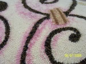

Here is a photo of one of the rugs in that thread:
And here is that blog post on "How A Hooked Rug Can Hang You" -
http://www.therugchick.com/2009/08/how-a-hooked-rug-can-hang-you/
Part of your preinspection on hooked rugs is to GRIN open the loops and see if you can see that ink BEFORE you get it wet. It will wick up. It always does. Sometimes you can lessen this by drying the rug upside down so it wicks to the back... but correcting this afterwards is next to impossible - as all ink is on wool.
This is a MANUFACTURING FLAW. You might show your client the blog post I did on this so it is SOMEONE ELSE showing why this happened, and that can be printed out and taken to the store she bought it from. I've had some of my coaching clients do this, and the stores have replaced their customers rugs because they were defective.
Might be worth a shot.

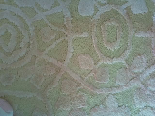

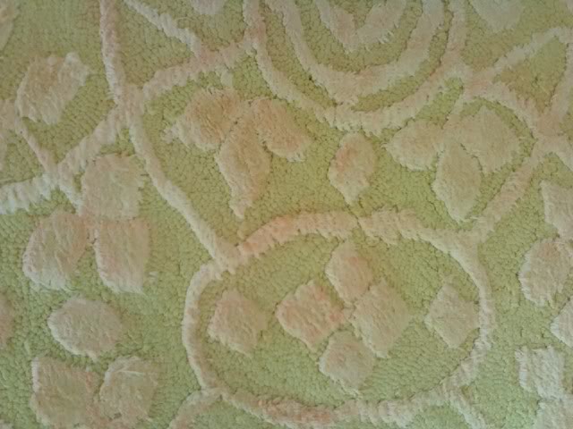

Here are the Photos of Jarred's Rug boo boo

Doesn't look like stencil bleeding IMO looks like a wicked back spot/stain.
The Great Oz
5,295
bryan
Is that rug wool or cotton? I highly recommend avoiding cleaning any cotton pile rug with Martha Stewart's name on it.

sorry that i said it was wool before..its cotton. Does that make a huge difference? Is there a way to fix it or is this the stencil thing. the customer bought the stencil reason..truth. If its not...how can I fix it?

As soon as I saw that, I knew it was cotton. Too many possible issues on those rugs.

Could it be PH?
Had I just seen the photo and not read the thread I'd thing PH and indicator dye.
MSDS doesn't show it as a high PH but it sure looks like a chemical reaction to me.
sweendogg
Jan 15, 2008
3,532
David Sweeney
Not pH.. looks like classic stencil bleeding from my end. I don't know why but they love to use red/pinkish red pens/markers for the pattern on the back as well. and the martha Stewart collection is infamous for these problems as I recall. Cotton rugs are not all that difficult to clean... if you know what your doing. However when you have the unknown and cheap manufactureing problems associated with some of these designer rugs, then you start running into challenges like you discovered.
The two biggest factors in preventing stencil bleed or even dye bleed for that matter is understanding heat and chemistry.
You could take a normaly cleanable rug that could go through a full cold water hand washing with the correct chemistries with no problems what so all and turn it into a bleeding pig by increasing the temperature or using the wrong chemistries.
natural fibers are dyed at lower temps and so will tend to bleed when temperatures are higher. And because dyes are not locked into the fiber like most synthetic fibers, highly buffered alkaline cleaning agents even mild to severe can loosen dyes as well.
Cotton tends to be color safe althought its a good idea to stick to an acid side cleaning or at very least a heavy acid rinse to sour the cotton to prevent browning. In this case, the stenciling was not watersafe and bled through.
It sounds like you don't have the blame on this one, and as such if I was dealing with a limited work environment as you have to, I would probably refer the correction to an actuel cleaning plant in your area you trust.
Or if you want to tackle the problem, have her sign off and make her realize that you are correcting an inherent problem from the factory. (don't forget to charge for it as well) Correction will be slow and I would probably explain that it will only remove from the cream colored areas. I'd recommend Magic, a steamer and alot of patience. (though for the green area you may try wilson's yellow go in a test area to see if you could retain the original dye. Of course that really needs a little training to perform as well . )
In the future you can avoid this by as Lisa W. said below.. Grin the rug to inspect for stencil dye.

The inks/ pens/ stenciling are nasty though in that they can loosen with just moisture regardless of pH level... that is why I said chemistry.. pH is overstated even in rug cleaning. Its more important to understand the chemistry being used and how it is interacting with your fibers.. and as you learned here, you can anticipate everything. This is were experience will lead you to look for these types of things.

I would have F'd that rug up for sure. I am glad you posted this. It still doesn't look like bleeding to me. If it is, how come it didn't bleed the entire rug?
