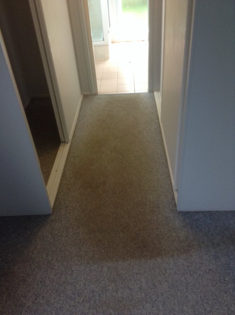

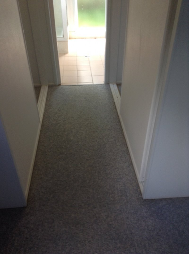

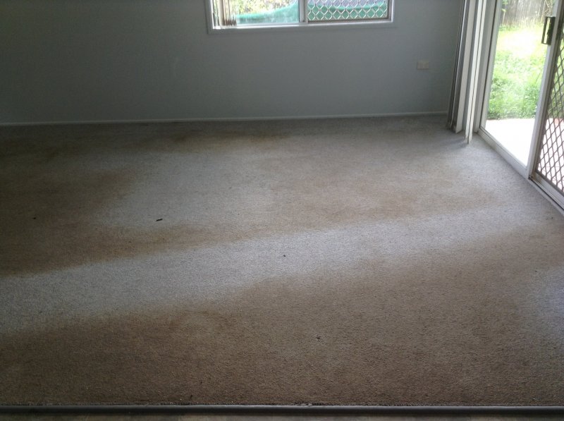

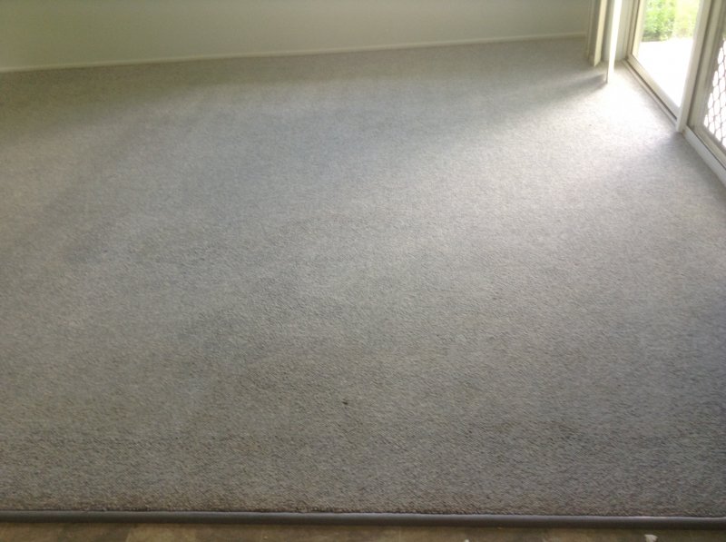

Sky, with practice, you'll get much quicker.
6 Leads??
The CFX has 2, one of which plugs into one of 2 leads on the Ranger.
The other goes to power.
The Ranger should then have one going to power.
This makes 2 leads going to the power supply.
You then also have one lead going from the 360i to power.
I do not have the Ranger, but I had the earlier model which is similar but with a lower pressure pump.
It only had the one lead.
I use only faucet pressure, so I have no reason to lug the Ranger around, just my CFX15 & 360i.
I have no problems setting up or breaking down regards time.
This combo give me pretty good results.
I'm not complaining, as it's a very versatile tool for everything I need, although it won't suit many.
