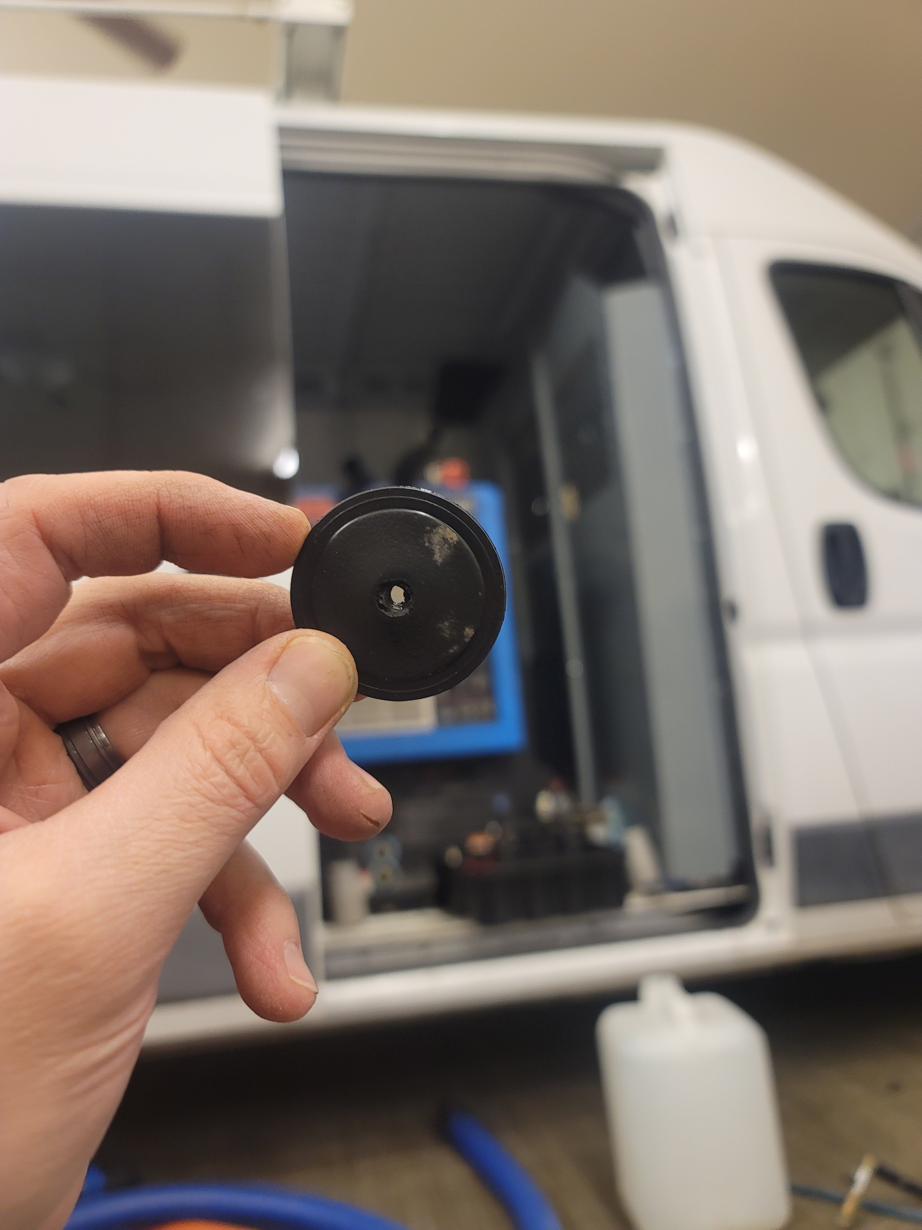

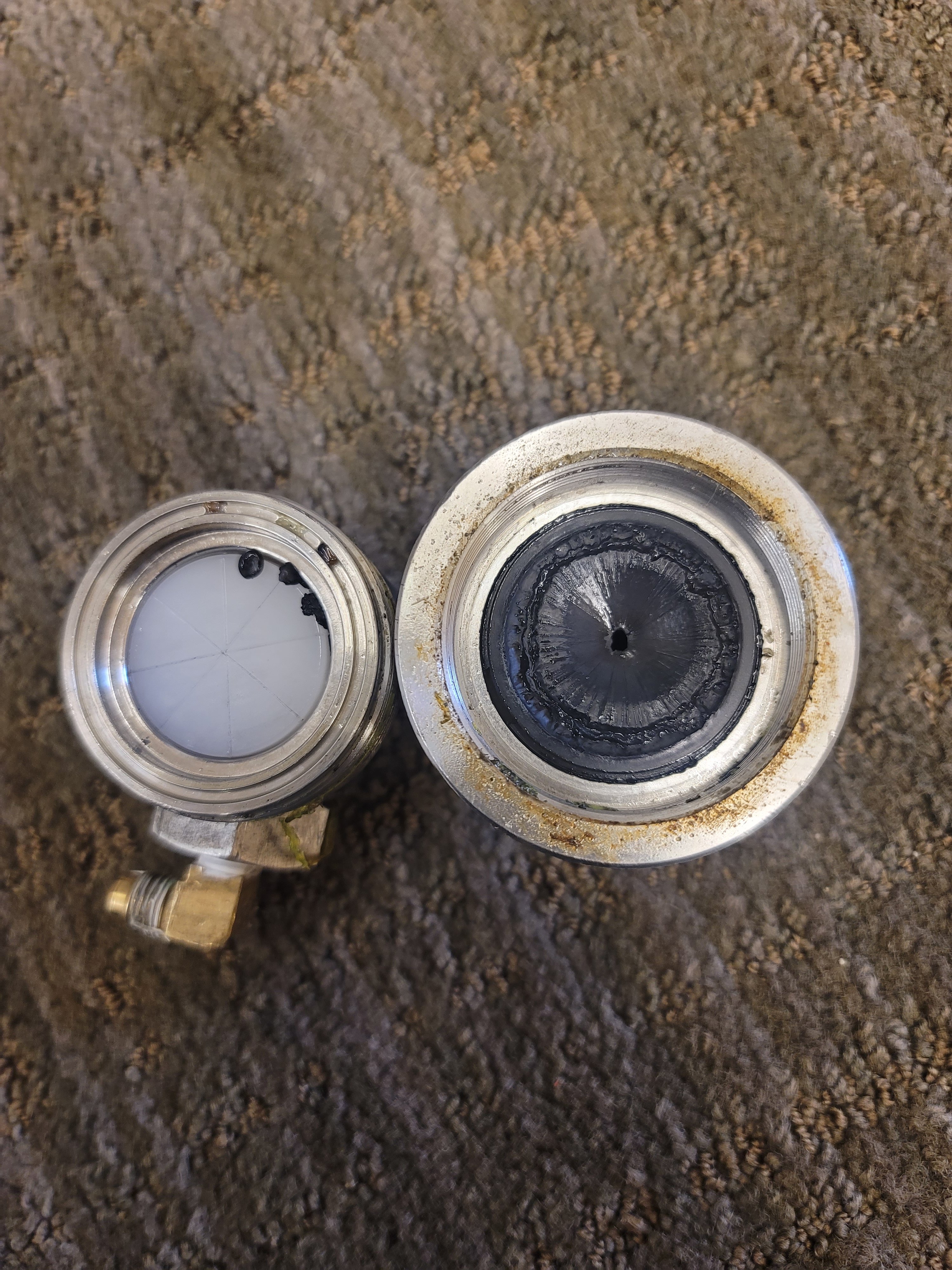

This diaphragm has seen better days. This pump could have gotten knocked up.🙃 All the o-rings were in equal shape also jamming up the check valves. 20230418_190925.jpg

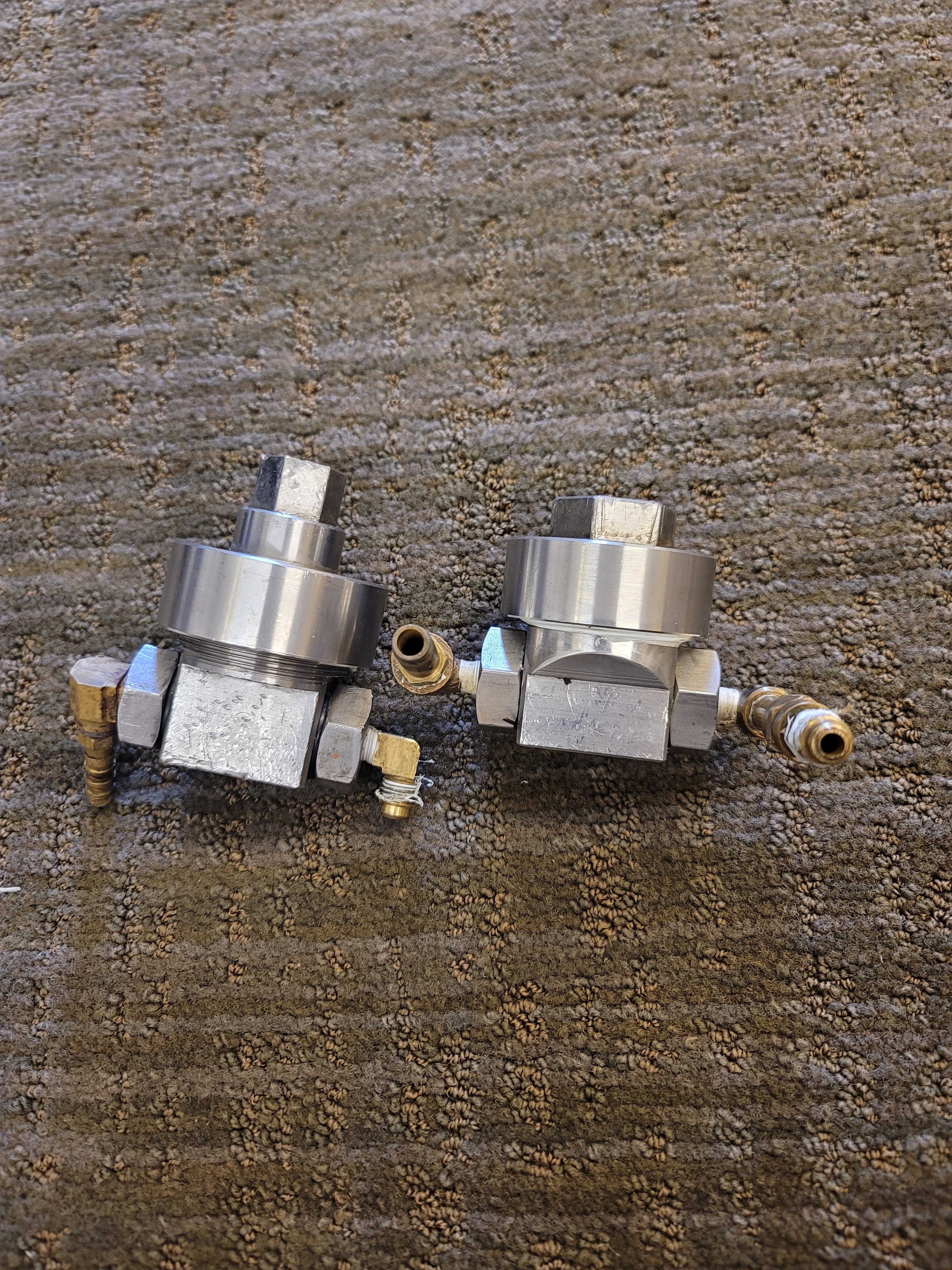

I tried to swap out pumps from my Boxxer to my Everest and it didn't work. I thought the pumps were interchangeable? Odds are that maybe the lines and everything else need to be replaced as well, but for future reference are the pumps interchangeable?
11,560
On my Everest 650 when I started working today my rinse jug was half full. When I finished it was full of water and overflowing. I have been having some issues with my chemical injection and plan to rebuild my pump, but this is a firs for me.
Three way valve is bad
Reactions: Living The Dream
11,560
No the make a diaphragm and new check valves for the one that came off the everest

Thank-you, Sam! I'm in the process of ordering parts to rebuild. It takes a little internet work to cross reference the parts. I'd order from Jon Don, but they mark up the pump alone $100 more than everyone else.
I hope you're getting some new accounts in your neterritory, and that your new home is awesome.
24,146
Be very careful when putting that back together. It's made out of stainless steel and if you damage the threads you are done.
