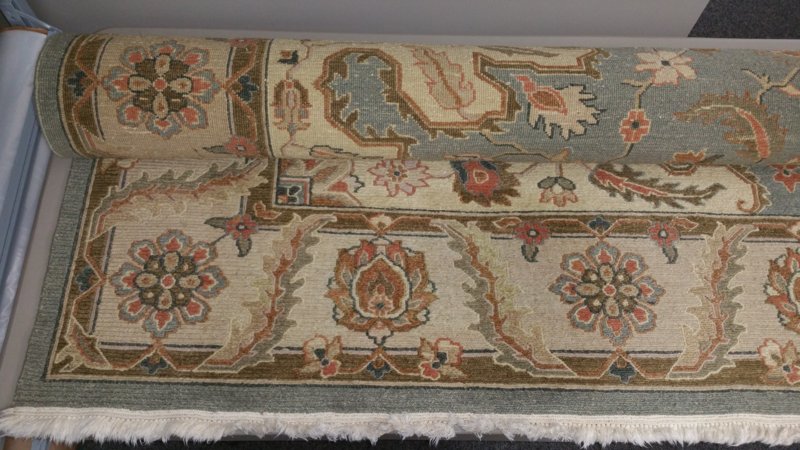

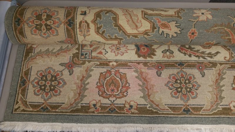

Pretty pleased with how this red stain removal turned out. This was on a newer wool on cotton, Indo Soumak rug. Probably a Nourison, Nouromak.
