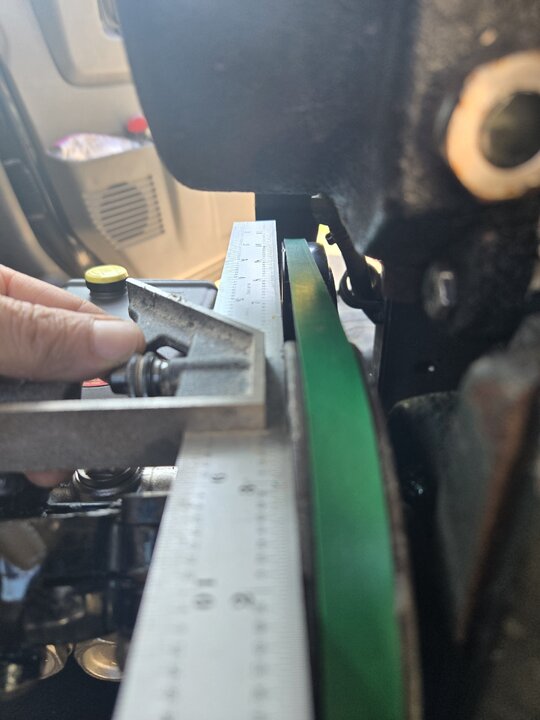

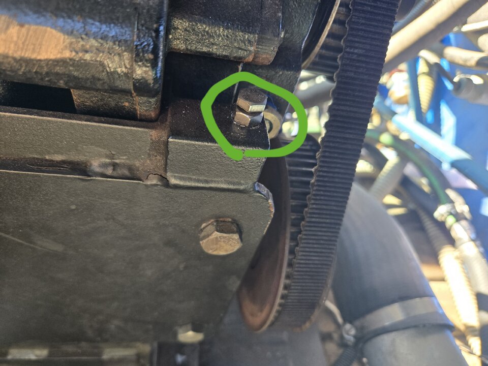

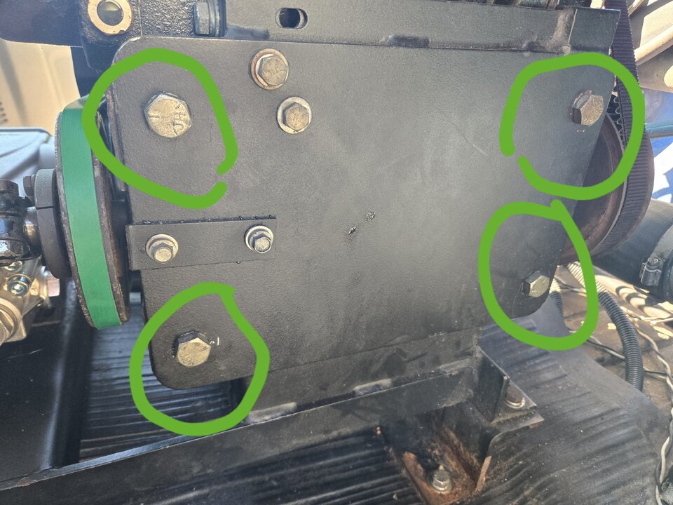

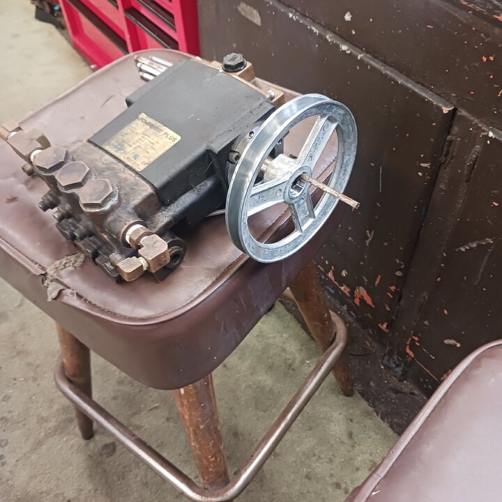

Ok so now as long as you dontneed for the pulley to go closer to the pump , you should be able to pull the pulley out and lock it down with it's set screws wherever it needs to be on the pump shaft. Unless its at an odd ball angle( / ) then i don't know what to tell ya .a cds owner need to weigh in and give ya some adviceGetting the belt on and off isn't an issue. Aligning the pump and jackshaft pulleys is. This is as close as it can get in its range of movement. It is way off. The only way to adjust the pump is loosening the 4 bolts underneath it on its mounting plate, which allows it to slide forward and back and wiggle a little to the left and the right. Looking at the jackshaft it seems only the read near the blower is adjustable, and it is one range of movement: up and down.
By this picture. If thats the pump pulley (big closestin pic) than it needs to be moved out. Does your new pump have the same footprint as the old??

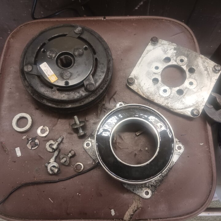

Well if you need a good used clutch i got one. I don't think it has much time on it at all. Magnet looks new

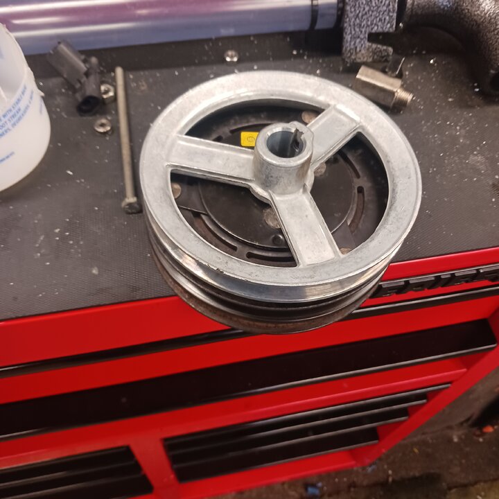

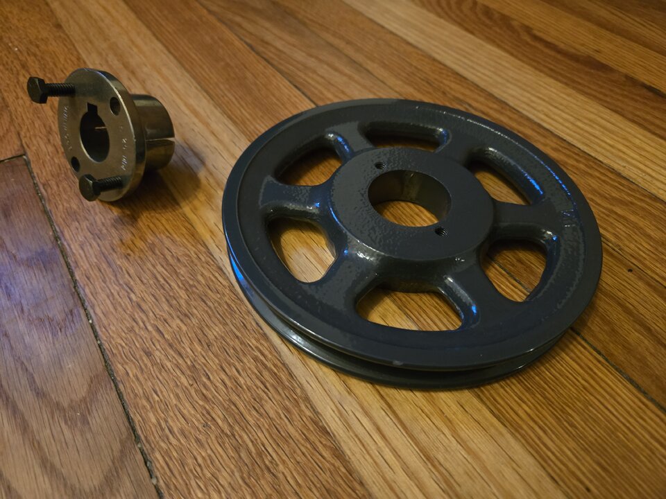

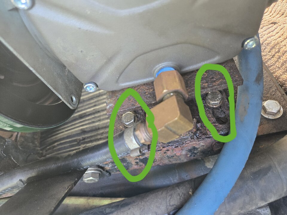

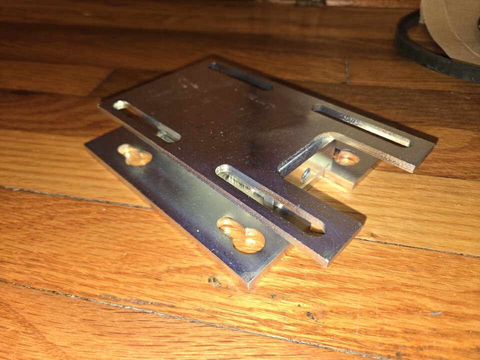

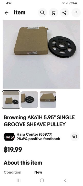

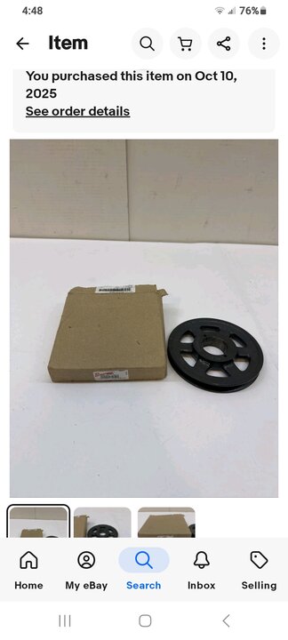

I ordered a browning pulley also. Got it off ebay for $19 (i have the proper center) it won't get here till the 20th so i picked up the one i sent a picture of in the meantime. Its a fractional horsepower pulley. If i need it it should hold up for time ill needI've got a new mounting plate, and a browning pulley you recommended to install in my pressure pump this weekend. I could see the pressure pump pulley wobbling after I bolted the old clutch armature and the pulley together. After I ordered the new pulley I realized the whole pressure pump might be vibrating on the old rotted mounting plate. So I am replacing that too.

Did you get the pulley installed?I've got a new mounting plate, and a browning pulley you recommended to install in my pressure pump this weekend. I could see the pressure pump pulley wobbling after I bolted the old clutch armature and the pulley together. After I ordered the new pulley I realized the whole pressure pump might be vibrating on the old rotted mounting plate. So I am replacing that too.
