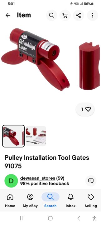

Belts can be straight edged aligned pretty easily. I cut down a 3' metal ruler i got from harbor freight to the various sizes of straight edges i needed for my machine. However if it is the Serpentine belt that needs to be aligned it can .be straight edged buuuuuuttt, i highly highly highly recommend that if thats the case you invest in a laser alignment tool. Serpentine belts have a tolerance of only ½ngroove for every 6" between the closest pulley and the pulley your trying to align v belts on the other hand are alot more forgiving. Lif your interested in a laser alignment tool for v belts. I found and bought one off a hog farm supply for about 30 bucks but it only works on A belts not B belts. If you want it message me and ill get you the information.

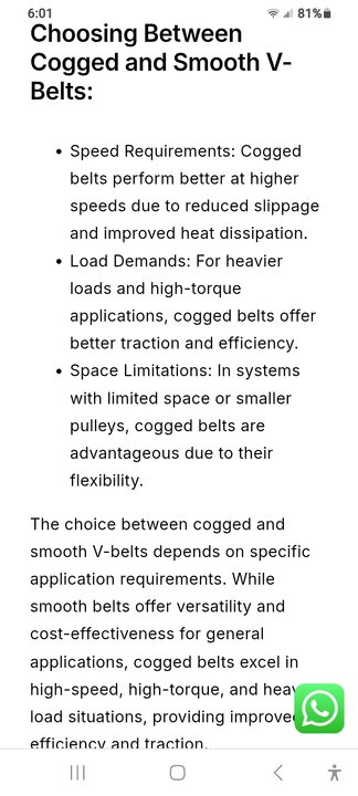

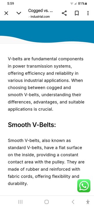

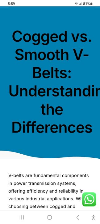

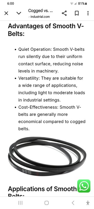

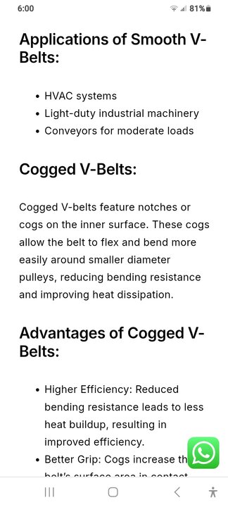

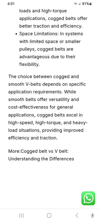

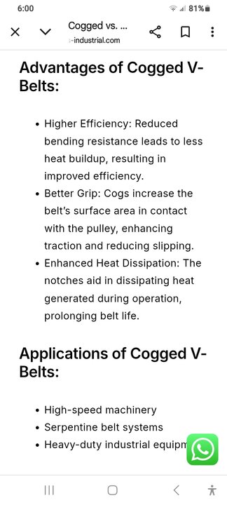

It was pointed out to me that while trying to relay more information to you i actually replied to myself. So if you scroll through the comments youll see what i was saying about belt alignment. Now the information i would like to convey is belt type. If you replace your belts and have smooth v belts change over to cogged belts i screen shot an article explaining the differences. X in gates belt # denotes cogged belt ie: Ax32 is A belt cogged 32" also if not already installed when you change your Serpentine belt upgrade to gates fleet runner belt (green belt) it holds up longer and can transfer more power than standard belts
Screenshot_20250703_175938_Chrome.jpg Screenshot_20250703_175950_Chrome.jpg Screenshot_20250703_180021_Chrome.jpg Screenshot_20250703_180041_Chrome.jpg Screenshot_20250703_180054_Chrome.jpg Screenshot_20250703_180107_Chrome.jpg Screenshot_20250703_180118_Chrome.jpg

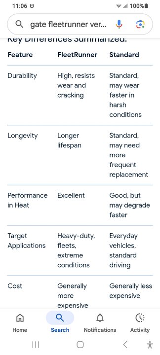

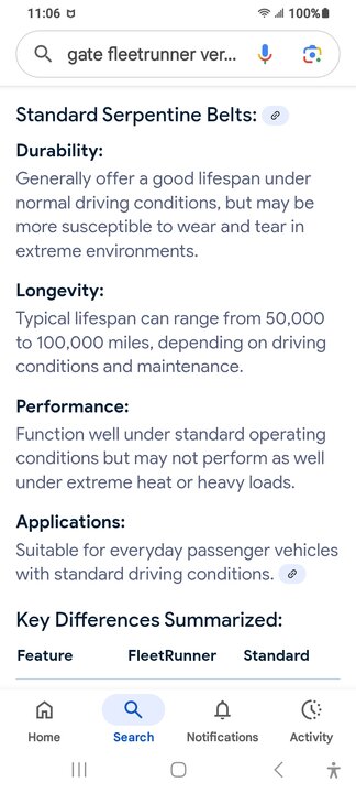

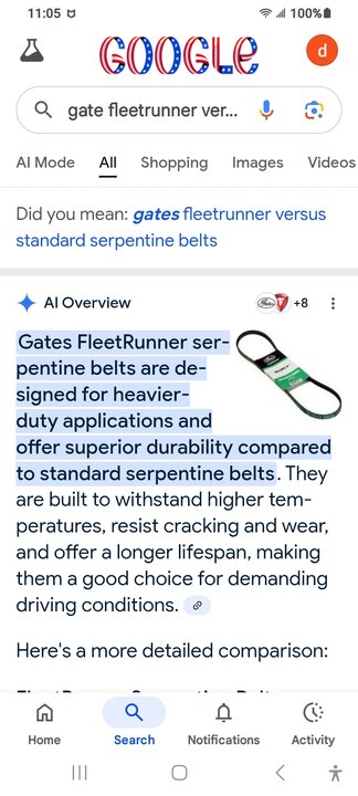

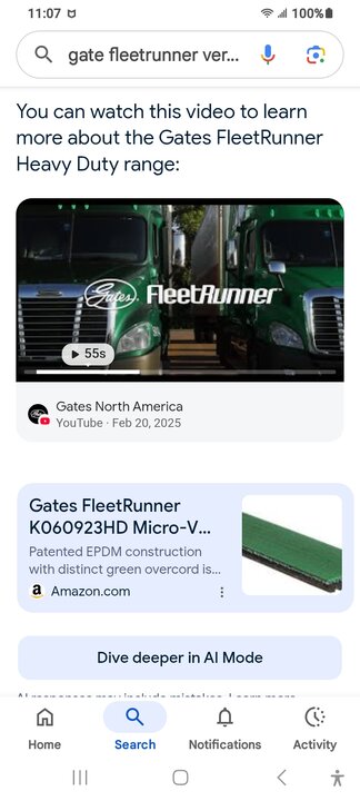

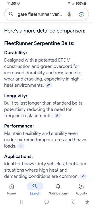

Ah, i see nowwhat i was doing wrong when replying. Im Still drooling but im not talking to my self this time.... anyway, googled gates fleet runner vs standard Serpentine belt and got this

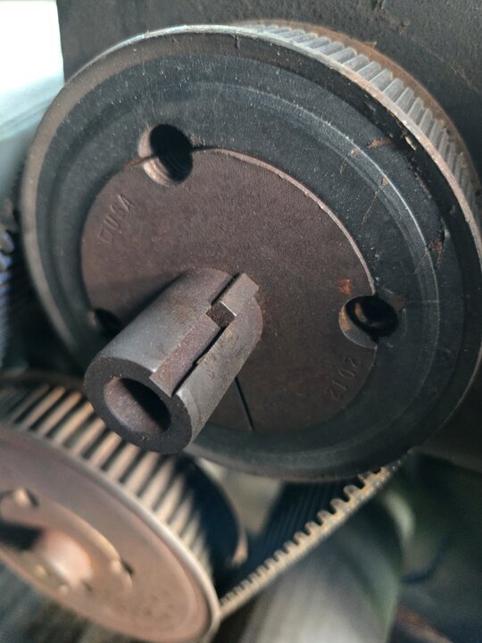

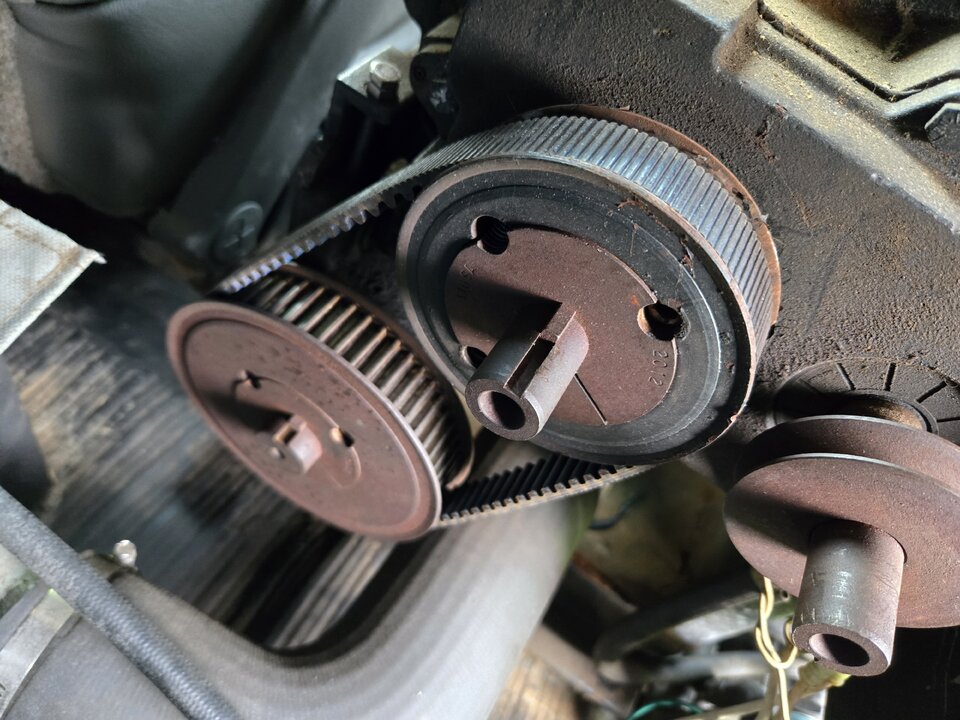

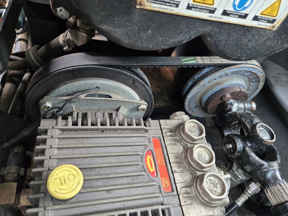

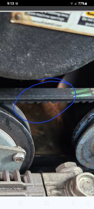

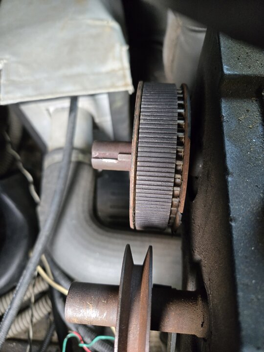

There isn't an idler pulley on this machine. The drive shaft has 1 pulley in front of the blower that turns the water pump, and another pulley behind the blower that turns the blower. So 2 belts and 4 pulleys in total.
I can't see any wear on the belts. The belt that powers the blower feels really loose compared to the one that powers the water pump. I don't see where these pulleys can be adjusted in or out for alignment, unless the whole blower is moved to do that...

The belt attached the blower pulley is running off to the left side of the blower pulley. I can't see any wear on the sides of it though. It seems really loose though, at least 3/4" of deflection. Any tips on how one would adjust the alignment and tension on that pulley? I'd rather not unbolt and adjust the whole blower to do that if there is a better way. It doesn't seem like some automotive pulleys that have a threaded shaft that allow the pulley to be pressed in or out...

What caused this in this belt?

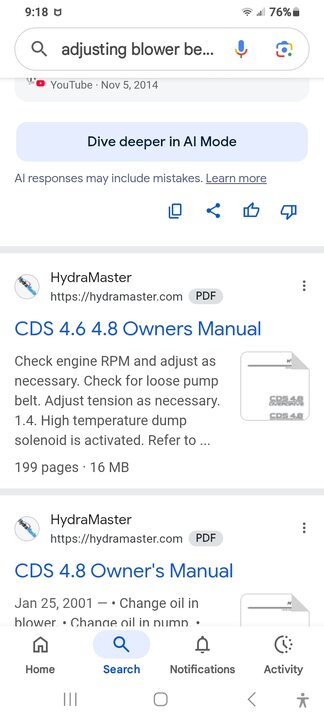

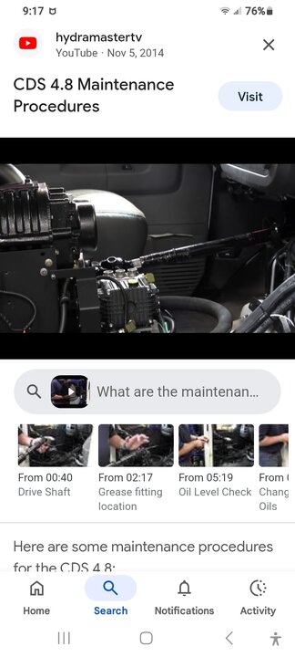

If you haven't already maybe download a owners manual also theres a few long youtube videos on maintenance
View attachment 131608 View attachment 131609
Thanks Dwain. I have read through the manual and it describes how to do an oil change and daily lubrication for the blower, importance of cleaning the filter screen and avoiding foam, and troubleshooting things like low vacuum. But unfortunately nothing about adjusting belt alignment or tension, or anything at all about the belt.
I had watched the Hyrdamaster maintenance videos once before and don't recall seeing anything about that but I will watch them all again. I searched extensively on YouTube and can't find many repair or diagnosis videos on Hydramaster CDS machines either.
I don't know what caused that scratch on the backside of the water pump belt. The aligment and tension of that belt seem much better than the blower belt. But I don't know much. I'll run it this afternoon and see if my stethoscope will tell me which side is louder. Will a squealing belt like that typically just wear a belt our faster, or might it do some greater damage putting stress on other parts?

I saw Chip doing some videos on a Butler setup. A little different, but one of the belts that seems similar to my water pump belt I saw him take of by running a screw driver around the pulley, and then put back on even more easily without a screw driver in similar fashion. It seems the only adjustment on my setup would be unbolting and shifting the pump and the blower themselves.
