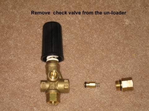

Does your truckmount use a regulator or an unloader?
I had a factory regulator and am back to using it. I tried 2 vrt3 unloaders with the check valve removed and verified that i was connected in and out correctly.
