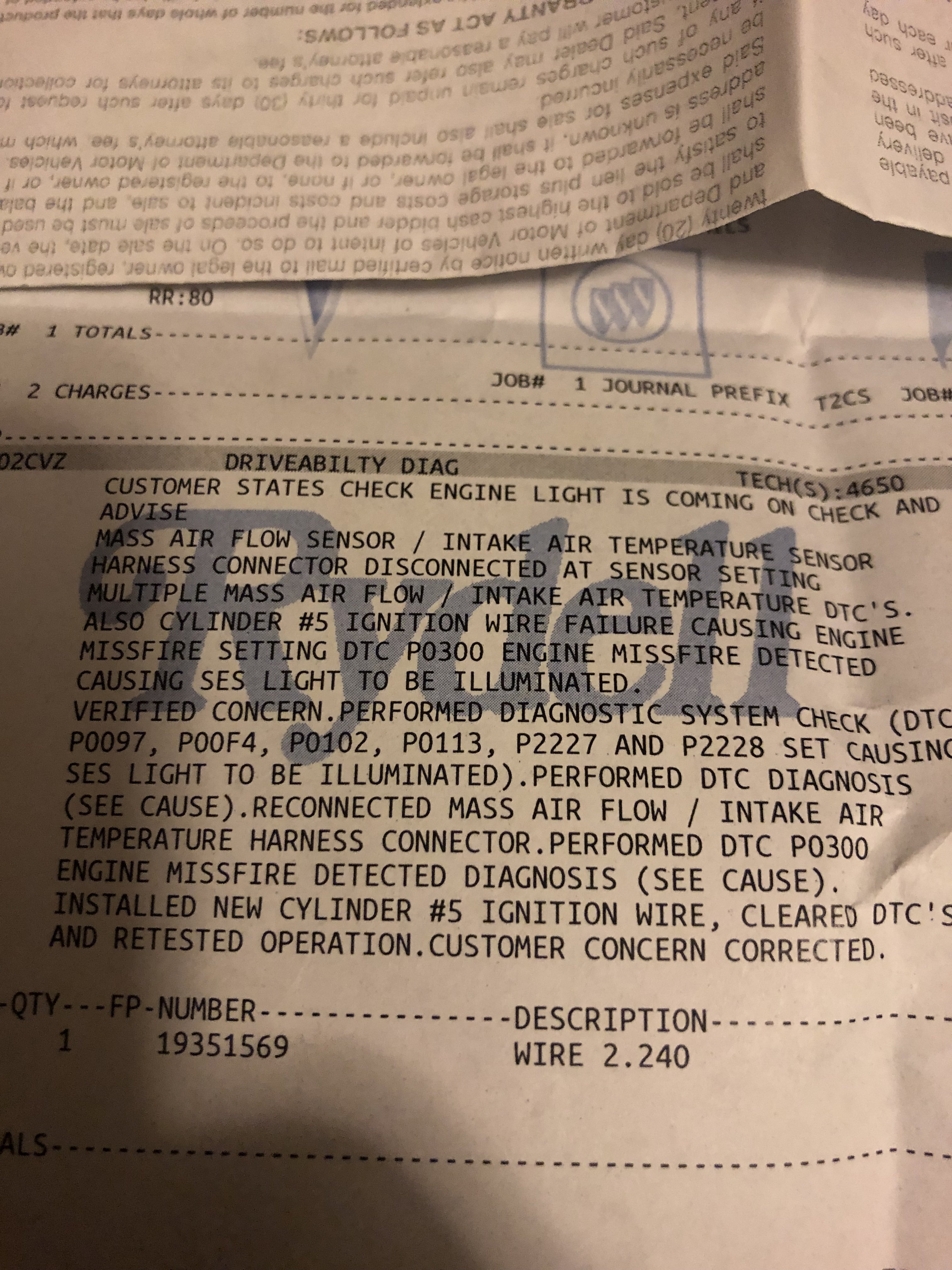

It’s weird we did check
Codes and it was a coming back a bad gas tank pressure sensor we reset the computer and filled the tank and waited to see which sensor it was when the check engine light came on. Also at that point the alternator was running 15 amps and the battery was sluggish.
New battery and sparks plugs was great. The guy who did that worked accidentally left the mass air flow sensor unplugged.
That’s when everything went haywire and I took it to the dealership.
They were bozos and refused to touch it with after market parts on it.

Rydell did a good job but they had nothing in the way to look at it.
I seriously doubt I need it towed $350 and the clutch drive removed and replaced $650 in the first place. But yeah it’s a learning experience.
Next time I’ll drive it to Rydell and let them look if its a serious engine issue I’ll pull the clutch drive.

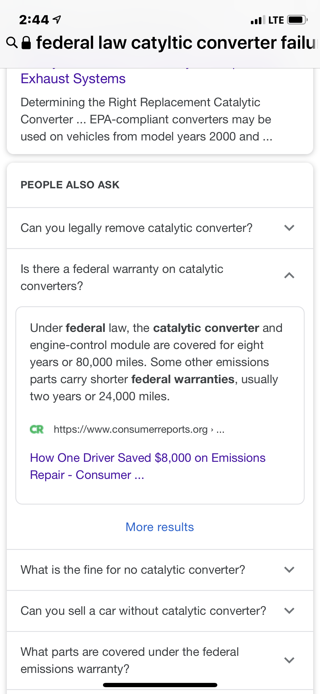

Lastly there’s still a good possibility I’ll have problems with the catalytic converter pray it ain’t so!

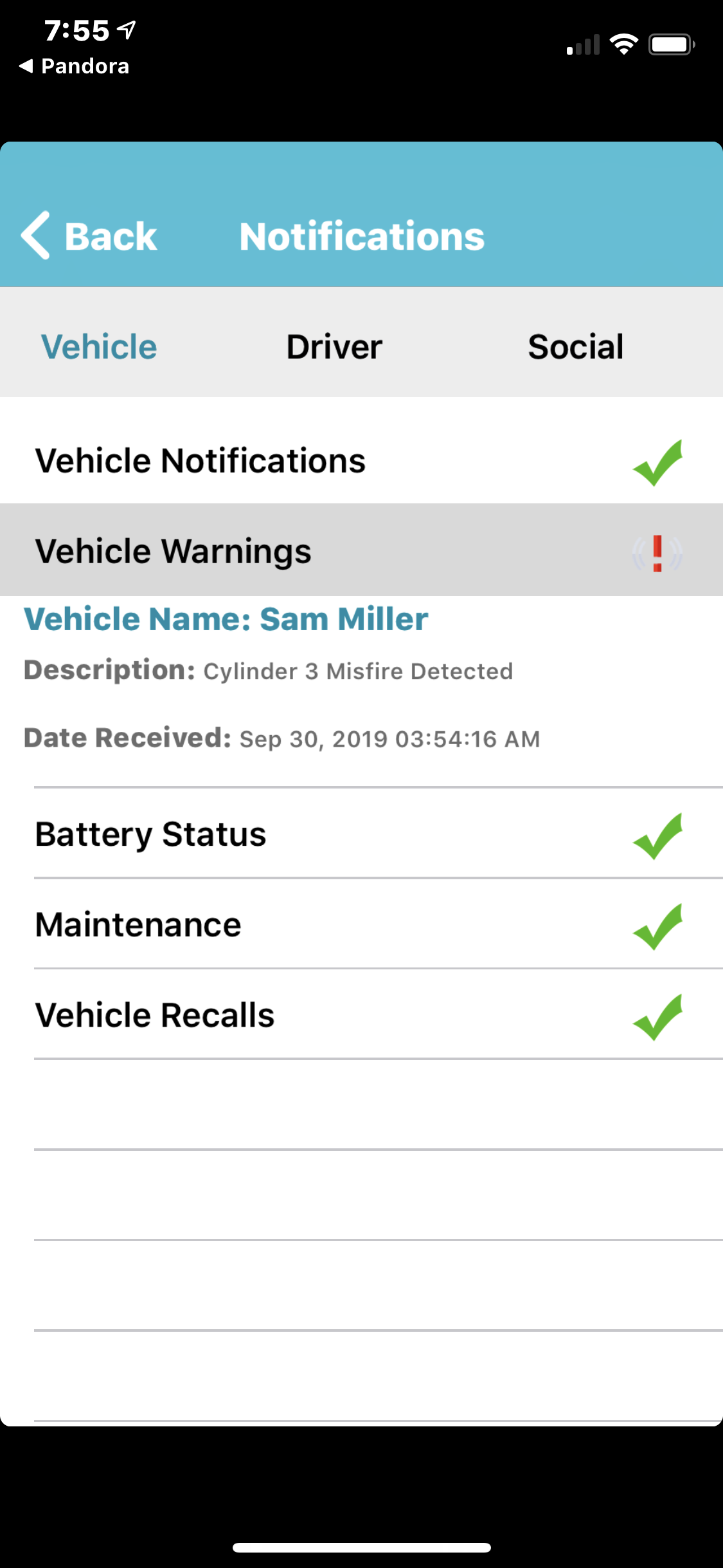

Originally it was cylinder #5 misfire now it’s #3 misfire
That’s the code my Vyncs gps device came up with
