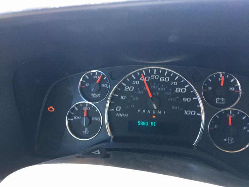

Ok the check engine light comes on and I googled and I'm finding it has to do with the thermostat?
It does go back off and the water temp guage never goes over 210

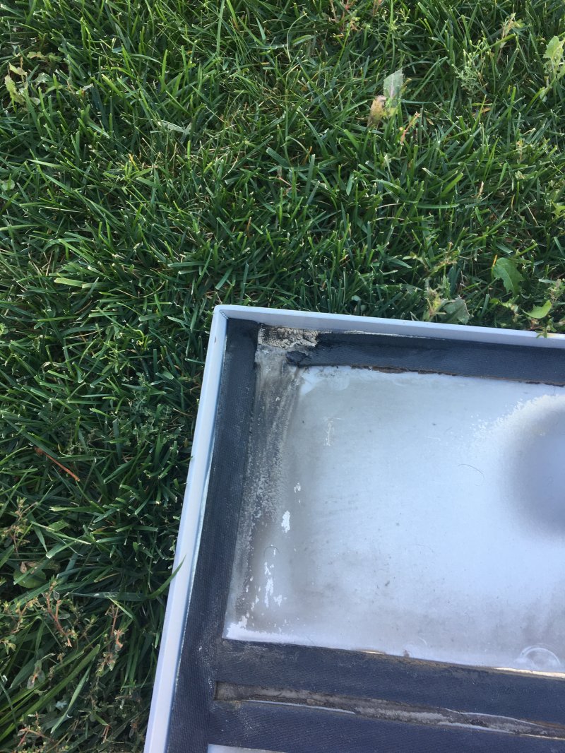

Also why the 570 and pro1200 must have the same idiot gluing the lid gasket on both failed in less then 6 months.
With that said I replaced my 570's two years ago still doing great.
11,570
I'm just waiting for some idiot to blame me for the lid!

Anybody else seeing the engine light?
View attachment 74519 View attachment 74520
You googled what?
What is the code?
11,570
You googled what?
What is the code?
You know me I read something didn't pull codes or anything,
But it happens when I do upholstery.
Not enough flow possibly, also tile and grout, or if I run out of fresh water.
I'm guessing it's related to the thermostat.
But ya I should have it looked at it's under warranty.
Just asking here to see if anybody else with a DD Sees it.

No codes for us but I wonder if the mass air flow filter has something maybe in it.
Or 02 sensor...
But would get that code checked
11,570
PO 171 PO 174 bank one lean and bank two lean, it's under warranty so I'll take it to dealership
11,570
Just going to say this, the light never goes on while just driving, only when the machine is in use.
And then it can stay on for up to a day and clears.

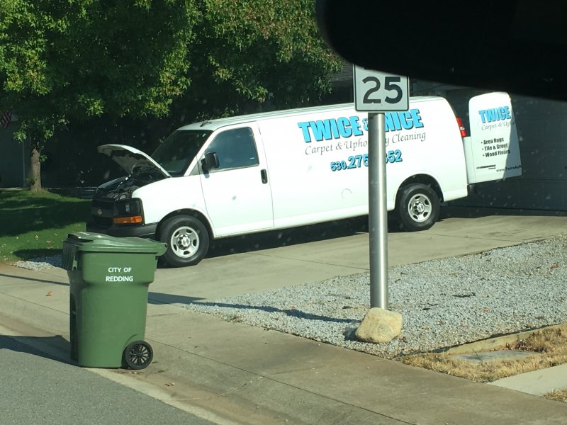

One of the local guys here in Redding has a Pro1200. I see him cleaning with his hood up. I'm hearing that this is the thing to do with these mounts. Beautiful machine.
steve_64
Aug 11, 2012
13,372
I'll put it up on bigger jobs. Less heat to the wand but the van runs a lot cooler.
Not normally but if it's over 100 degrees we tell the crews to run the Butlers with the hood up.
