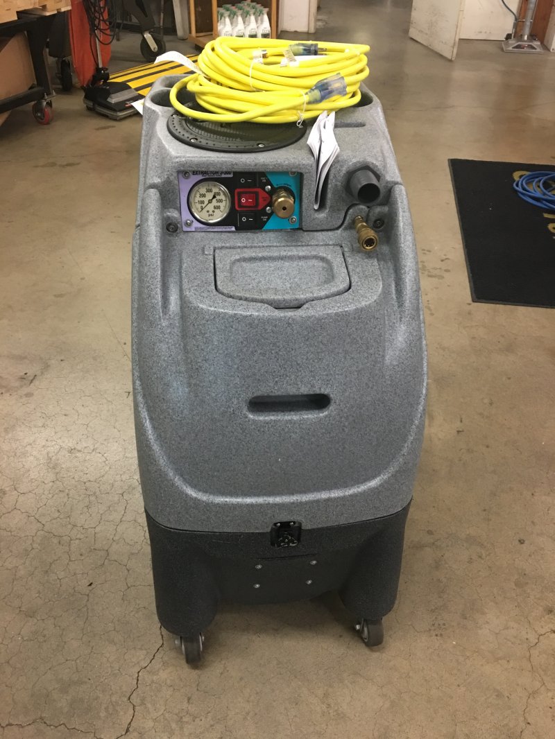

$1799 50 feet of hose and a 2 jet wand,
2 3 stage vacs, 300 psi pump and a heater.
New!
One left Empire floor machine.
1 1/2 inch connection.
Is it something that would work with a 360 I brush head?

It should. You won't get 300 psi with the 360 but you don't need it as the brush does all the work. If they are the 13-14 amp 3 stage vac motors, you might consider drilling out the 1 1/2 inch connector and replace it with a 2 inch. You can always go back to 1 1/2 with a reducing cuff, which is what I do with my machine.

Yes same as my portable.. I have a 500psi pump on mine.. The right side on mine is the cord that pulls more amps.. If using the heater, don't plug into GFCI outlets.. It most likely has 1 1/2" stacks in the tank, mine does.. I drilled my port out and put a cool cuff starter on it.. Gorilla Glue sucks to seal it as you can't get anything behind it to screw a nut in it.. It has a true 2" port better than the plastic barb..
My 360i works fine with it.. I did strip another machine to take parts from.. I drilled another hole in a spare lid to the waste tank to add an additional vacuum.. Helps with longer runs over 50'..
Heavy bastard to lift though.. My 200psi model without heat was super light..
