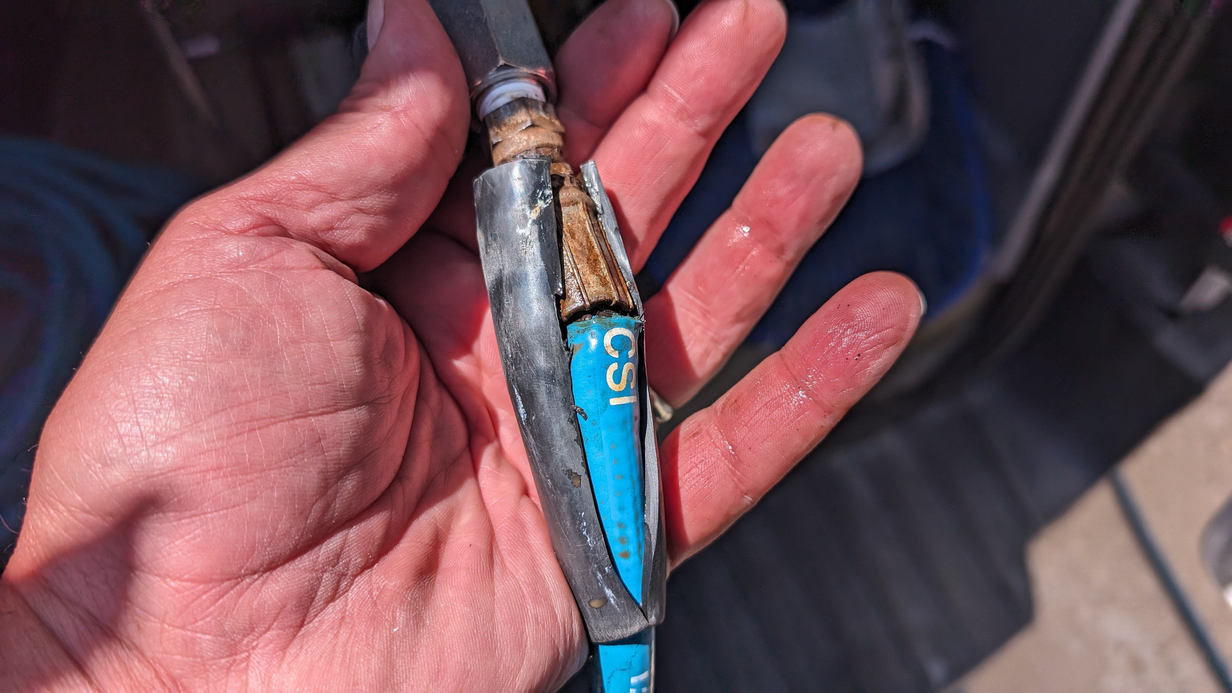

pOp goes the pressure hose...
117,376
It's been a long long time since I've gotten soaked and soaked a house.
Gives me a good opportunity to try this stuff..

with the rust on that crimp, it looks like it's two years old

I wouldn’t ever consider using stainless braided hose. Way too heavy among other reasons.
50,042
Brister sells some neat in-the-field repair couplings.

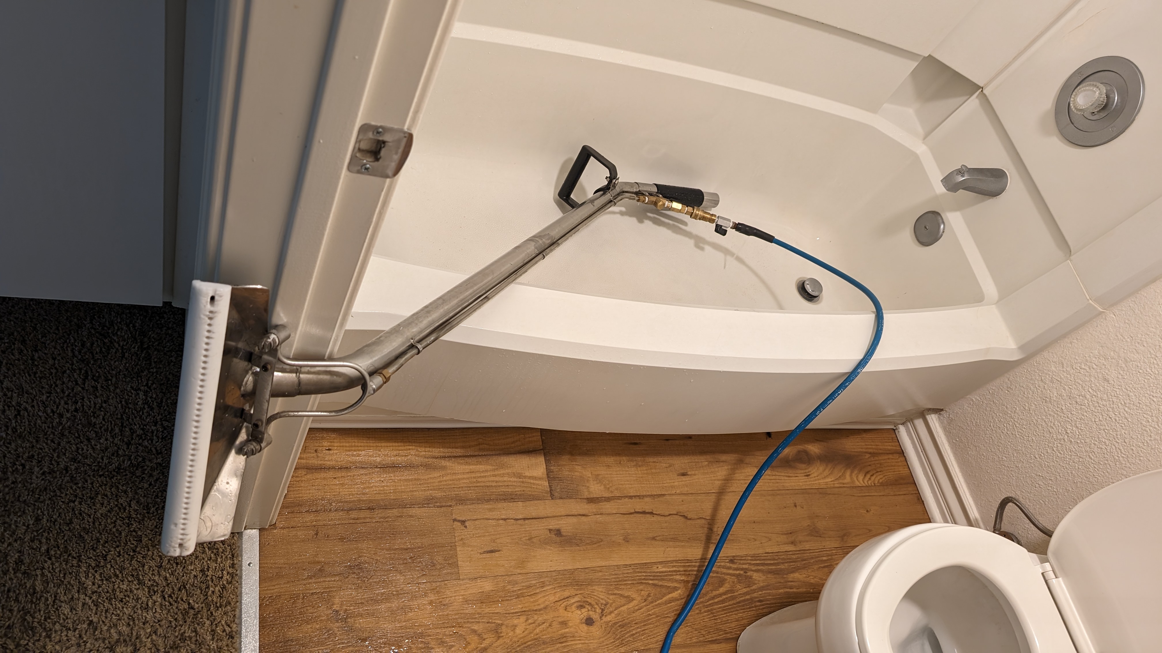

Paul
Vac hose..
the pressure hose and ball valve womnt fit into the cuff...
2" hose here. And yes, a female connect and shuttoff DO fit in there. Ask me how I know...
Remember the Prochem TriJet is just like your wand except it flares out to 2 inch at the end. If yours did that Id buy it in a heartbeat.

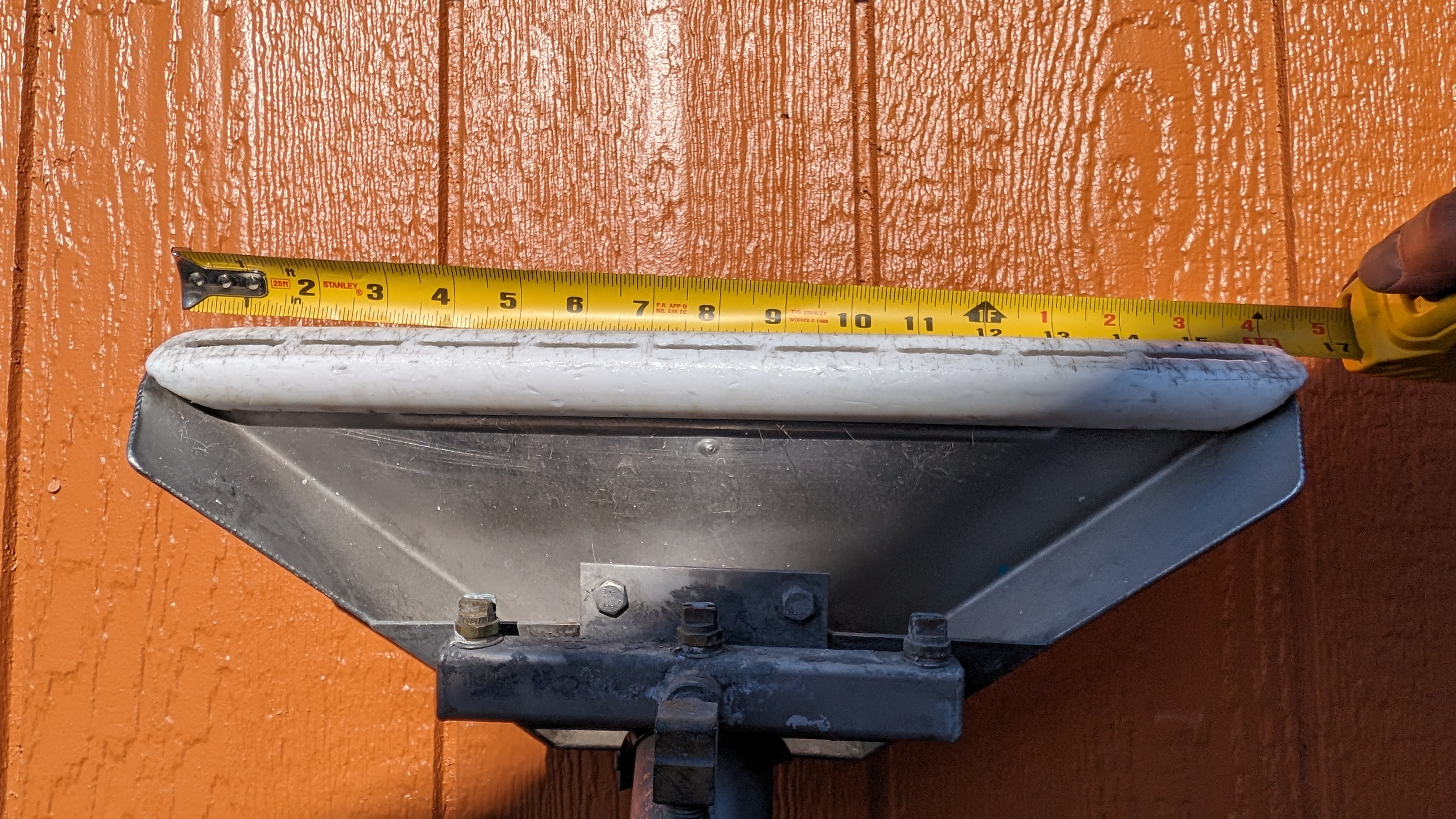

The Tri jet is many pounds heavier
Has a unnecessary third jet, which mandates a spray manifold which causes drips/drainage
It's jets are not at the key 45° angle
Uses a horrible Glide system that needs to be glued on so interchangeability is out the window
And most importantly, I'm not willing to wear my joints out so that my customers may or may not enjoy carpet that is dried 3 minutes quicker.
The dry times on this wand are already ridiculous, not to say I haven't tried running 2-in hose to it with use of adapters, but the benefits don't exceed the negatives.

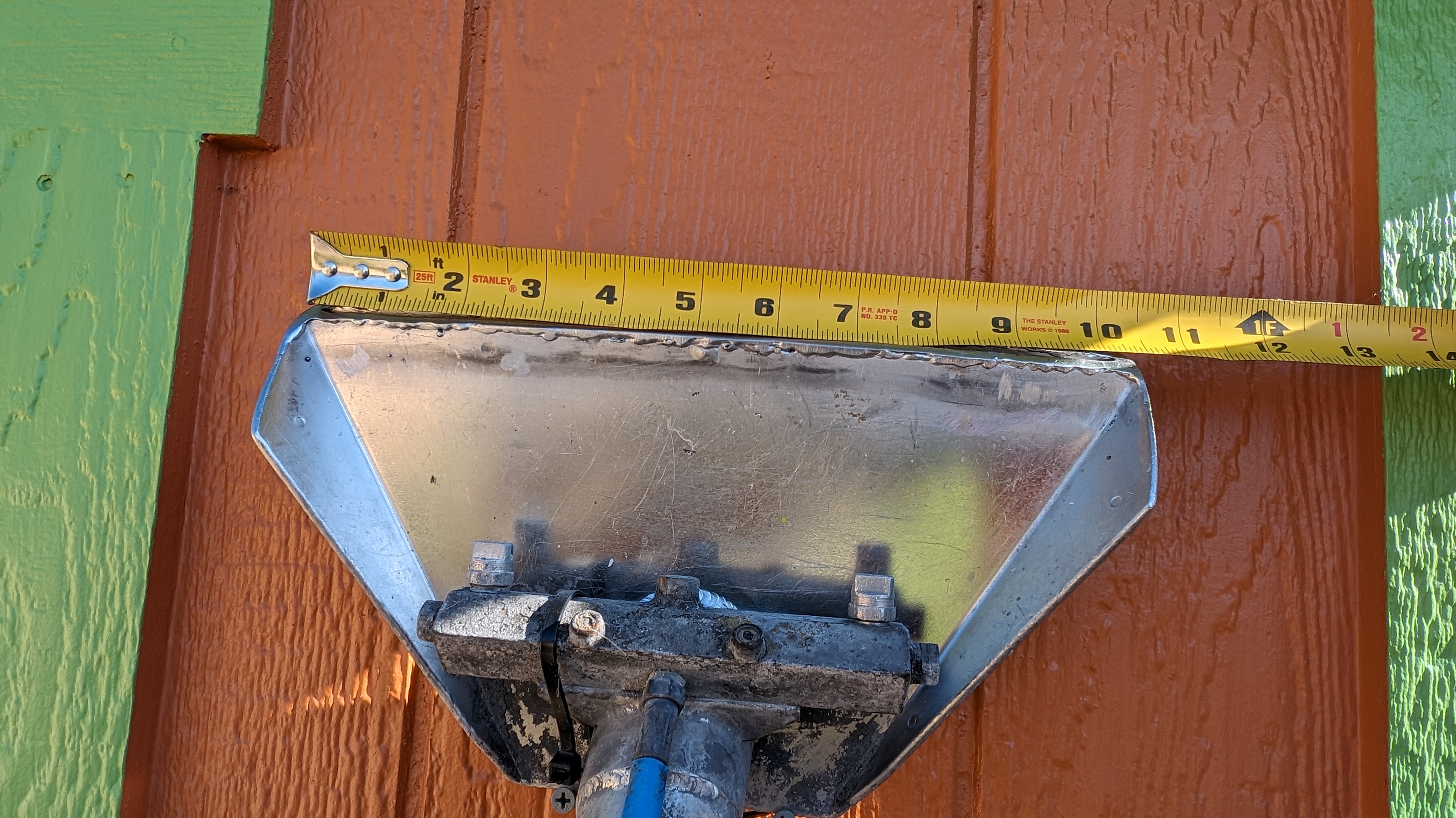

And it's ten inches wide...
