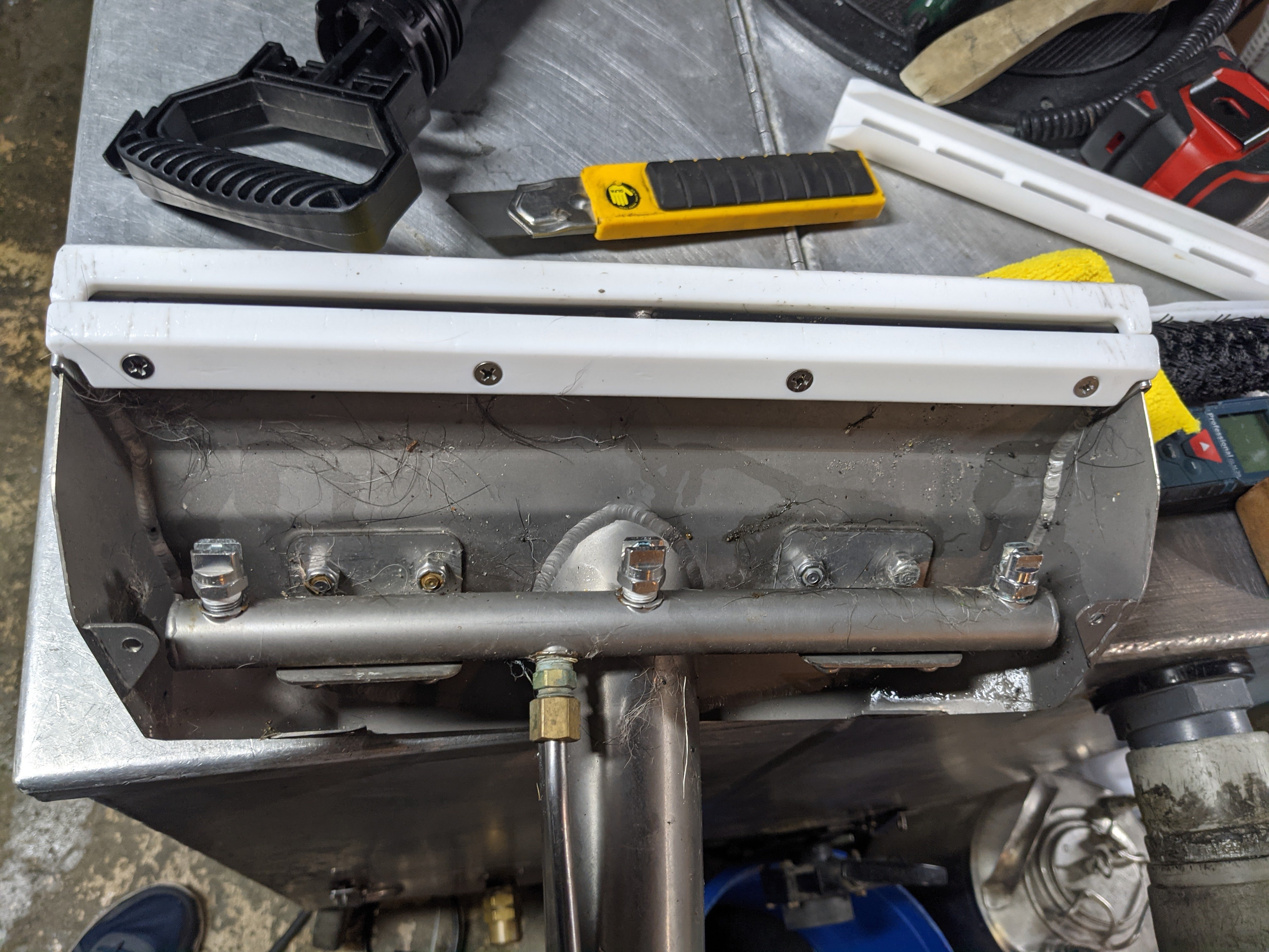

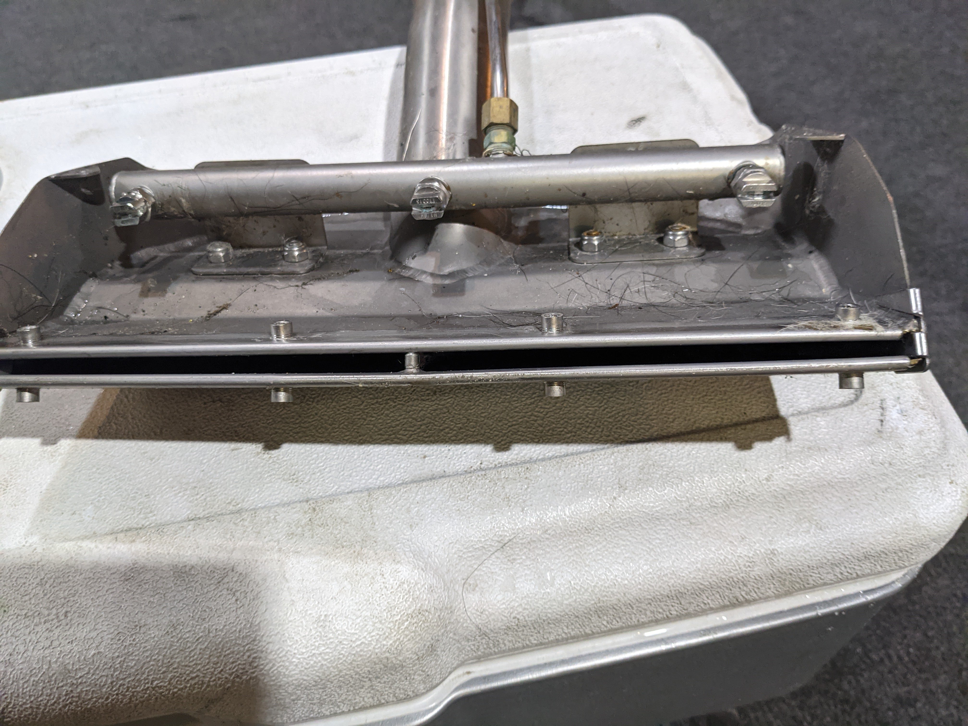

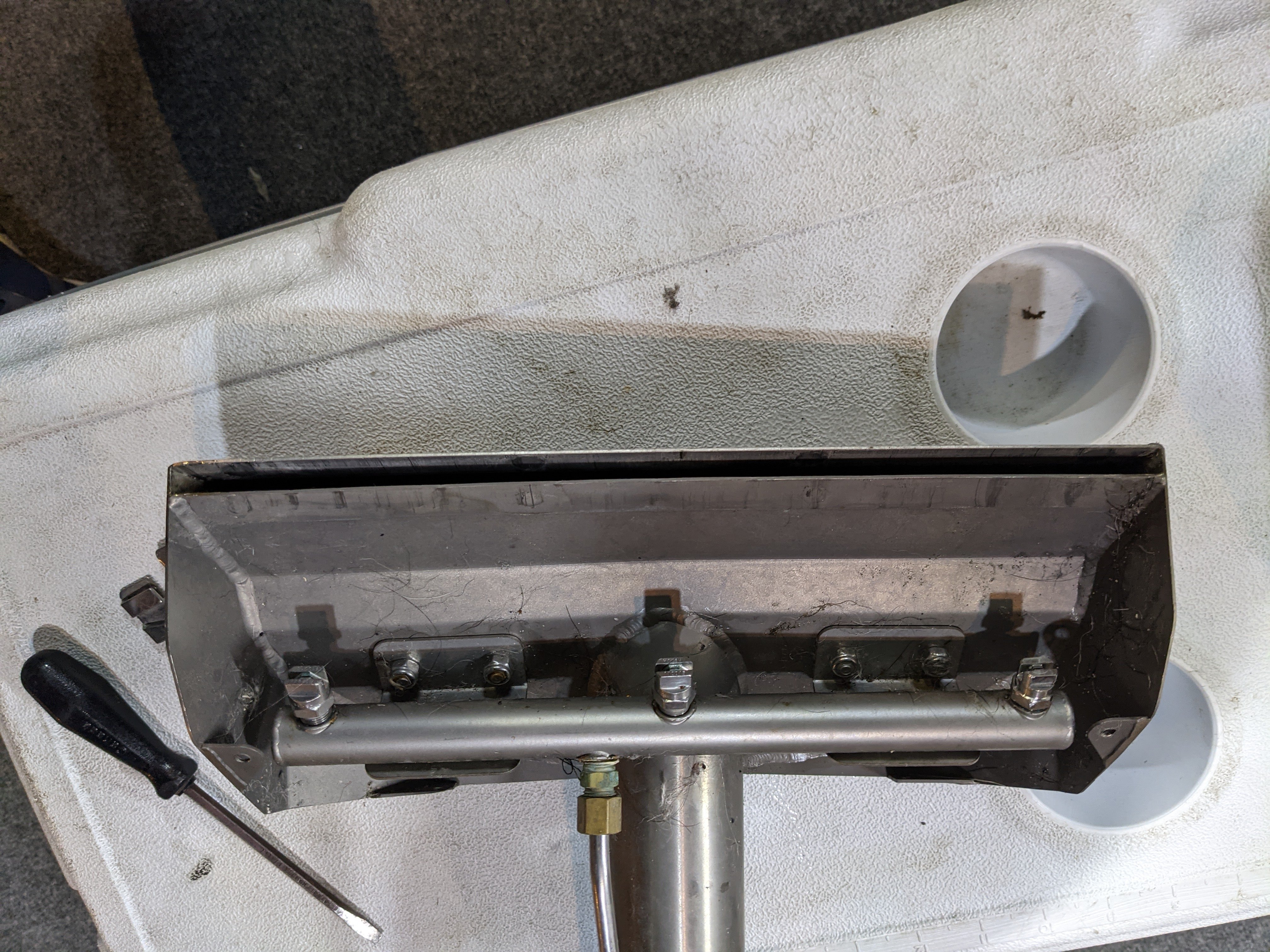

Never mind. I got them off. It will be nice to see the difference on this 2 inch titanium version of the Mach 12. The original glides are too flat causing extreme lock down with the Cleanco.This is the current set up. Do the stainless glides have to come off?
View attachment 113876 View attachment 113877
Yep, got to come off..This is the current set up. Do the stainless glides have to come off?

Did that one come from clean-co? I remember seeing 4jets on mine and clean-co made a nice internal chamber for the jets. I think every wand should have thatNever mind. I got them off. It will be nice to see the difference on this 2 inch titanium version of the Mach 12. The original glides are too flat causing extreme lock down with the Cleanco.
What size jets?Never mind. I got them off. It will be nice to see the difference on this 2 inch titanium version of the Mach 12. The original glides are too flat causing extreme lock down with the Cleanco.
It's made by pmf for Cleanco. Has a bolt on heat shield. 3 jets only. I normally use a 6 flow with a 11002 in the center and 9502's on the sides. Very lightweight wand with great airflow.Did that one come from clean-co? I remember seeing 4jets on mine and clean-co made a nice internal chamber for the jets. I think every wand should have that
I have a greenglide on my 2 inch westpak wand and it is a joy to use compared to this lighter titanium wand. Hoping the rounded greenglide makes the same difference.Green Glide for that. Wand is a very narrow round internal fit that everybody seems to love, except this one guy who doesn't pre-vacuum and he was obsessing on lint and hair getting caught up on the bridges..on his FIRST job...

is that manifold comes from pmf or do you customized for ur wand? i do really like to have one like that one on my wand!This is the current set up. Do the stainless glides have to come off?
That's how the wand came. Not sure why they use only 3 jets instead of 4. Probably a Cleanco thing. I also have a 1.5 inch Mach 12 with 4 jets direct from PMF. Both work well but I like the 3 jets betteris that manifold comes from pmf or do you customized for ur wand? i do really like to have one like that one on my wand!
