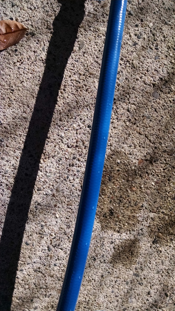

I ordered some from John, and mine did have some leaks, I ordered it with no ends, and I put my own ends on. I believe I didn't get them tight enough because the hose was leaking about 3 feet back from each end. I cut it off and redid the ends and no more problems but it looked like this.
Tiny little beads of water every 1" or 2 very evenly spaced, I didn't bother calling John about it, after the new ends fixed everything, I think it was letting water get between the inner core and the blue outter wrap.

Ok good so sounds like I just need to put on a new end and it will be fine. Mine is spraying and has the the little droplets coming out like tconway
TConway
Jan 18, 2013
1,193
Thomas Conway
I have a little video of it, and the end that was hooked to my TM was actually misting from the pin holes. So yes I think you just need to cut a bit off to be safe and re crimp with a little more CRIMP good in tight.
