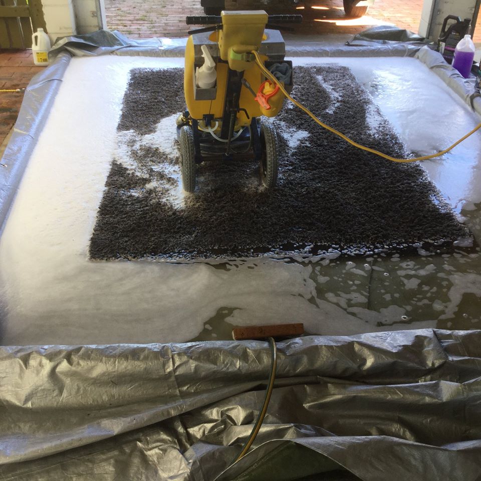

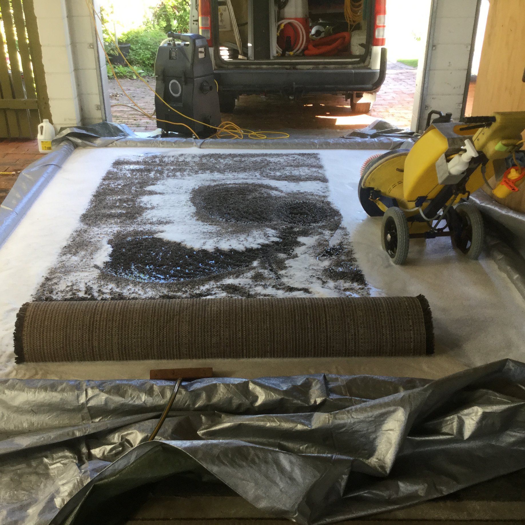

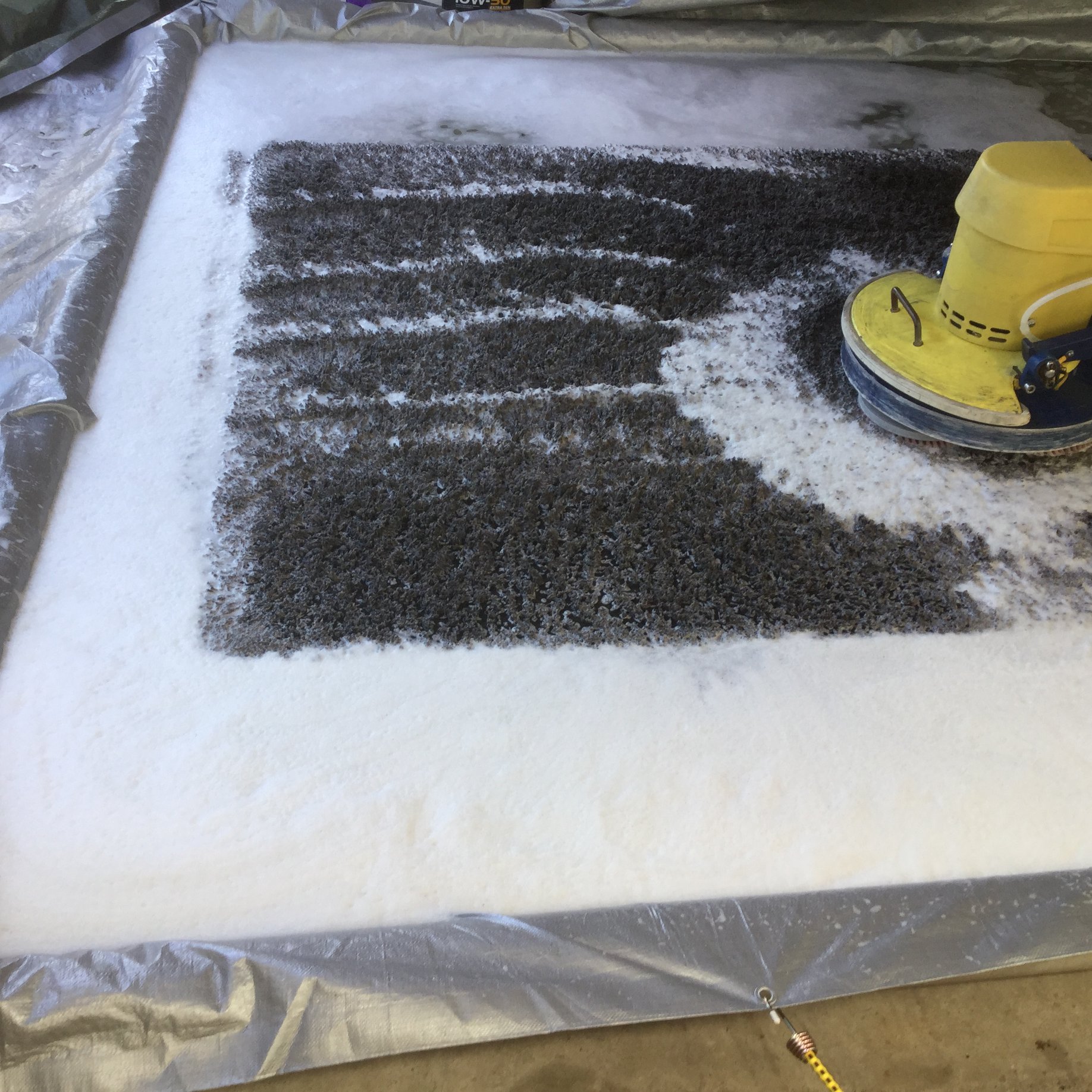

Trying to slow down & not do many (if any) rugs anymore, today has confirmed my thoughts.
So, I put WATER ONLY into my portable soak tank for two urine affected rugs.
I have NOT cleaned these rugs before, they have only ever been “steam cleaned” by someone else.
I then started to agitate with the Cimex with brushes.
Why did this happen?? 😱😱
I feel all sudsed up. 😳
Hmm, wonder if that “steam cleaner” is certified.
If not, he should be.
By Callan Park certifiers. ( For you Americans & others, Callan Park is/was a mental institution. )
I still have to rinse, extract, treat, rinse, extract.
Gonna be a long day.
PS:: I believe the owners "MIGHT" have rented a unit to clean the rugs themselves. :winky:
:yoda::very_drunk:

Saved you a little on your chemical costs.
Papa John
Lifetime Supportive Member
Aug 19, 2013
7,040
John Stewart
Understand that when owners do spot cleaning they fail to extract anything away;
so there will be spotter build-up.
Sometimes the foam would overflow from our rug Jacuzzi onto the shop floor until we added defoamer.

I used a fair bit of defoamer as you say.
Several times into the vacuum hose. 🤬🤬
