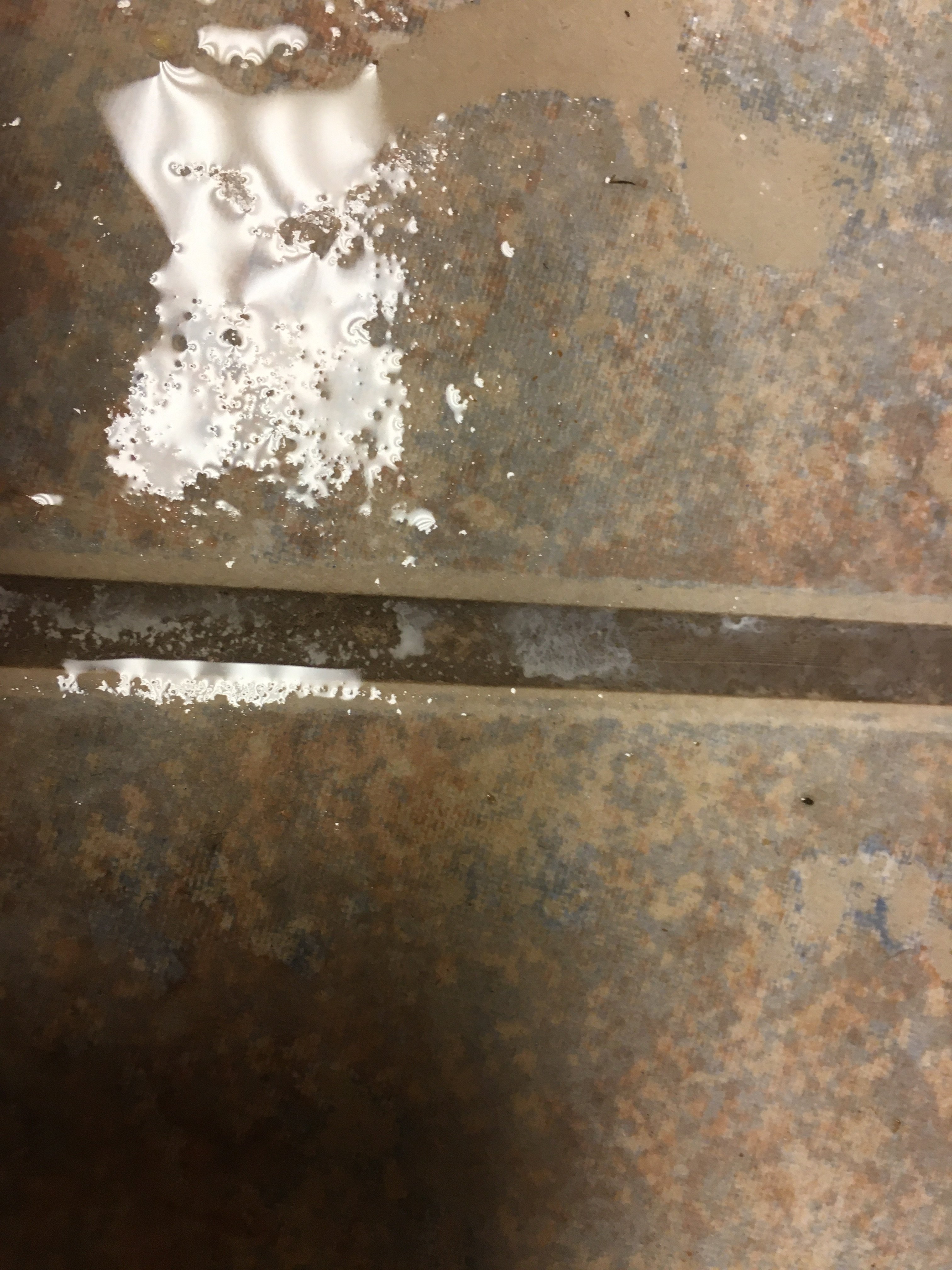

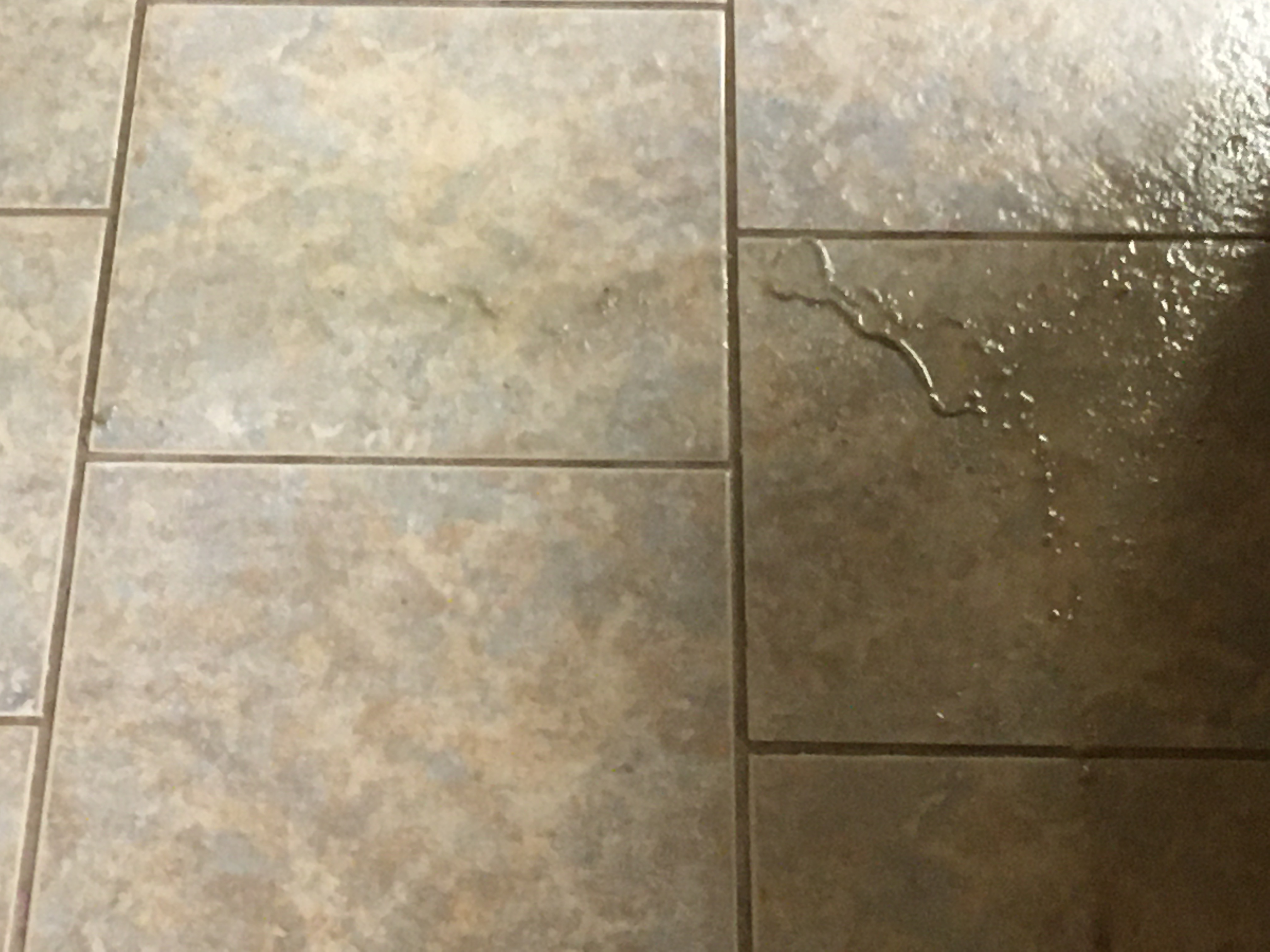

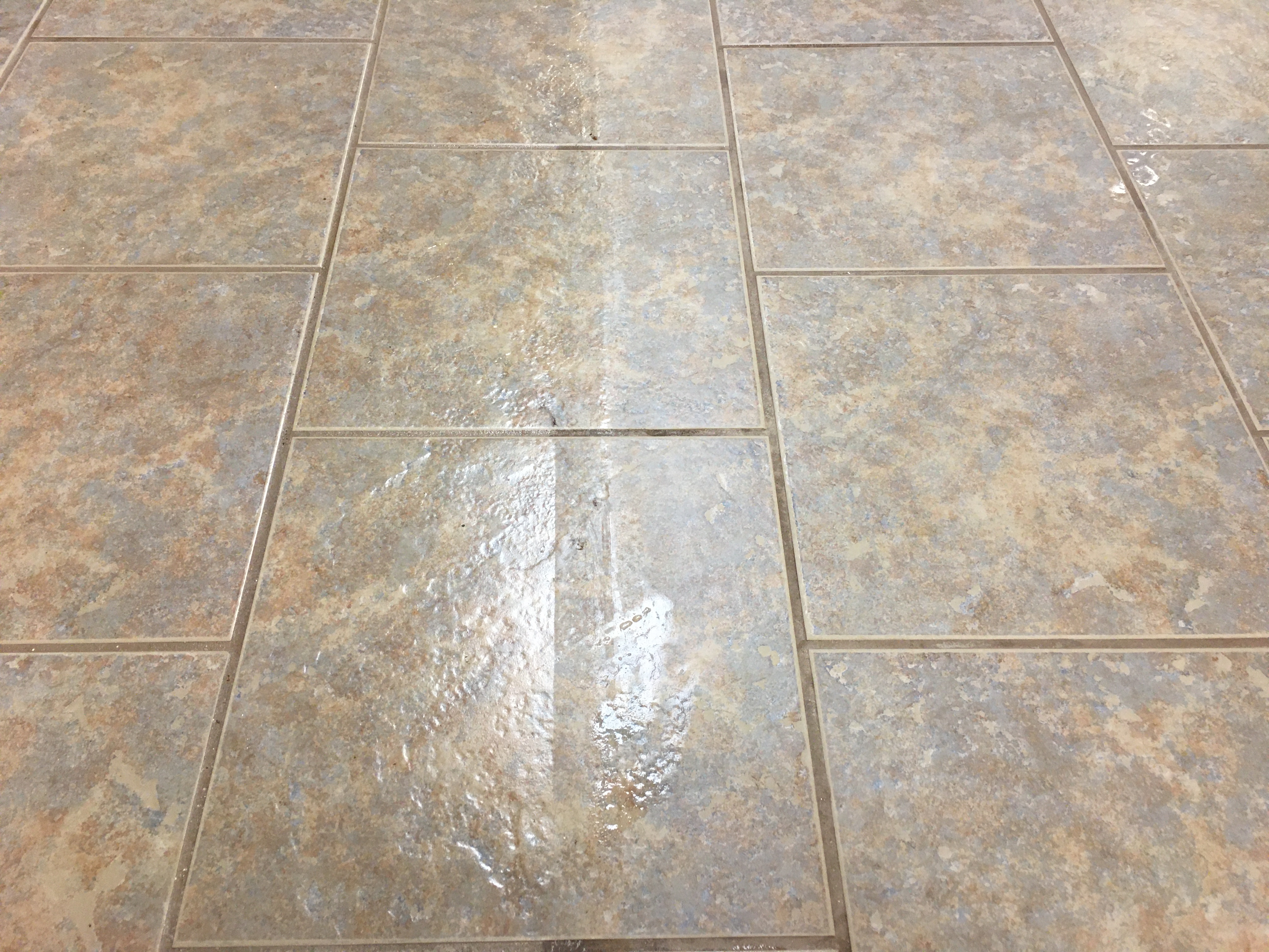

I embraced it today
I hAd about 1k sq ft of t&g I had to strip. Turned up the acid rinse to rinse out the stripper
FC8798F7-07A1-43A7-AB99-89EA3A9536ED.jpeg C22D88FA-4961-49D0-A4DF-411AE125A381.jpeg 303F81D1-D431-424C-B5C1-CD704A7DE461.jpeg
