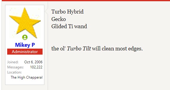

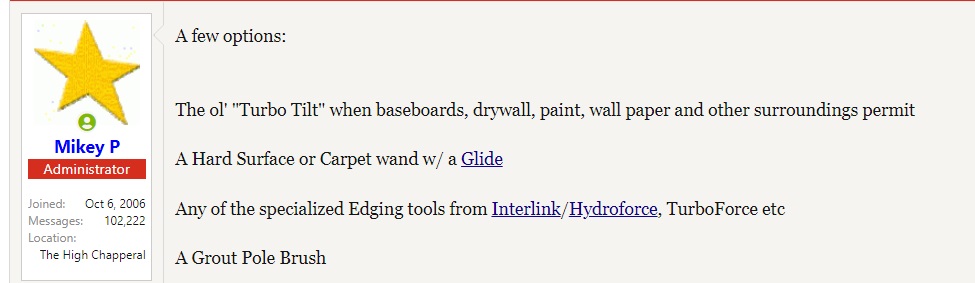

Mike. Even the hard surface glide oversprays out the sides even at under 400 PSI. I know a few guys that use it and are just keeping quiet about it because their afraid of your strong personally. I personally think a spinner is better for tile floors and not tilt it.
What I do is clean right up to the edge with my spinner or hard surface wand, then anything along the edge that is needing some love i clean with a spotting towel and brush. I use a second towel to dry. Never had a problem with swelling doing this.
you deserve to be throat punched, ESPECIALLY you assholes that Turbo Tilt.

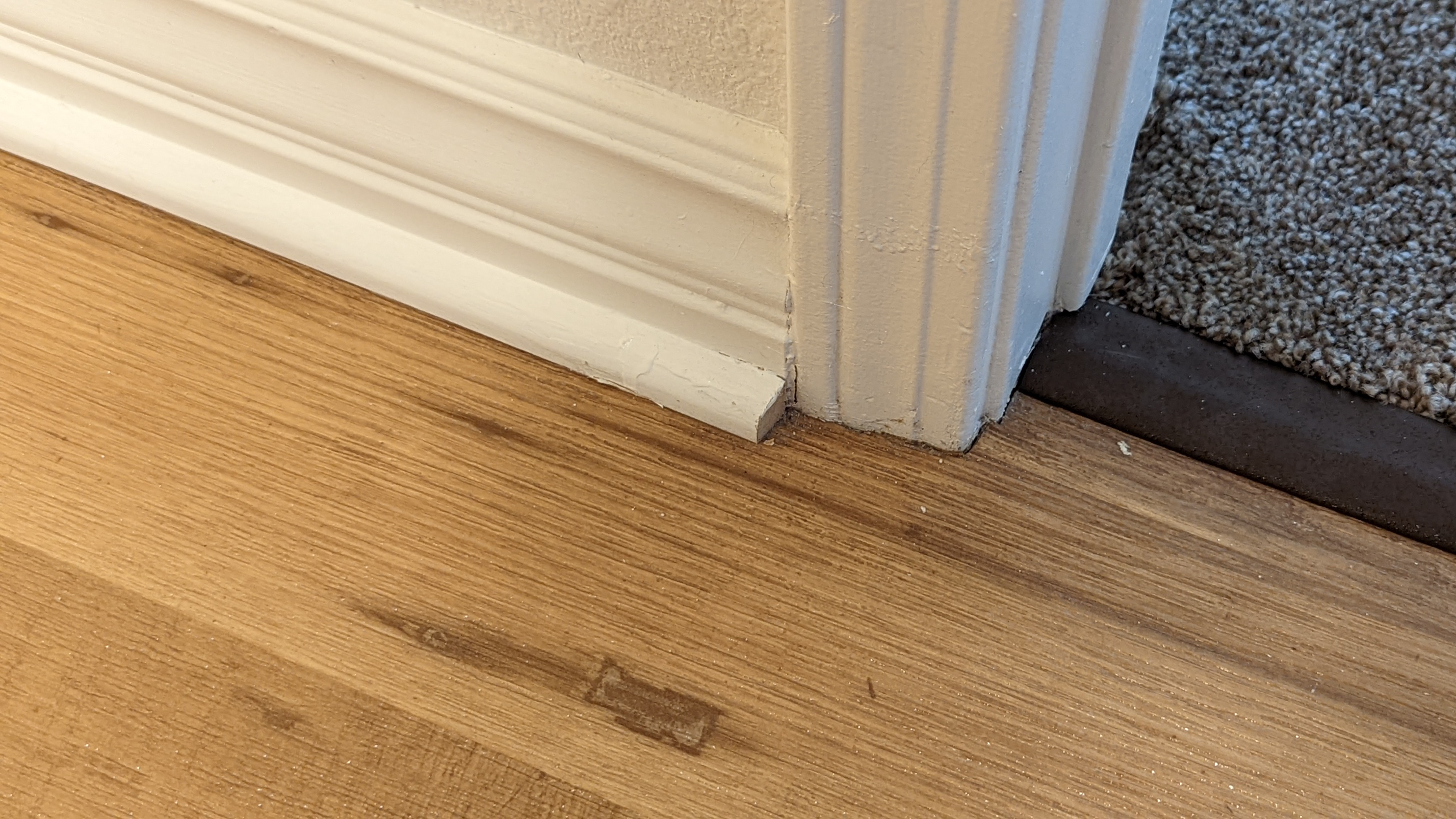

They put this quarter round in front of all the MDF here at the military base and for the life of me I can't get it to swell..PXL_20220407_180413317.jpg
Dec 20, 2006
1,184
cape coral fl.
jack zerkie
I was told the secret from not swelling it that ALL sides must be painted to slow or stop the problem. Front back and each end, Maybe enamel would be better than water based. jz
I can't see the end well enough.
But figure it's because it's real wood.
I don't know that I've ever seen MDF 1/4 rnd or shoe :headscratch:
(I'd "guess" because it would break too easy handling and install, in thin strips??)
All I've seen was/is either cheap finished foam, PVC or stain grade wood or finger jointed primed wood
and yes, Jack, painting all sides helps seal ...no need for oil base though, if that's what you mean by "enamel".
"quality" latex enamels are superior to oil in almost every way
