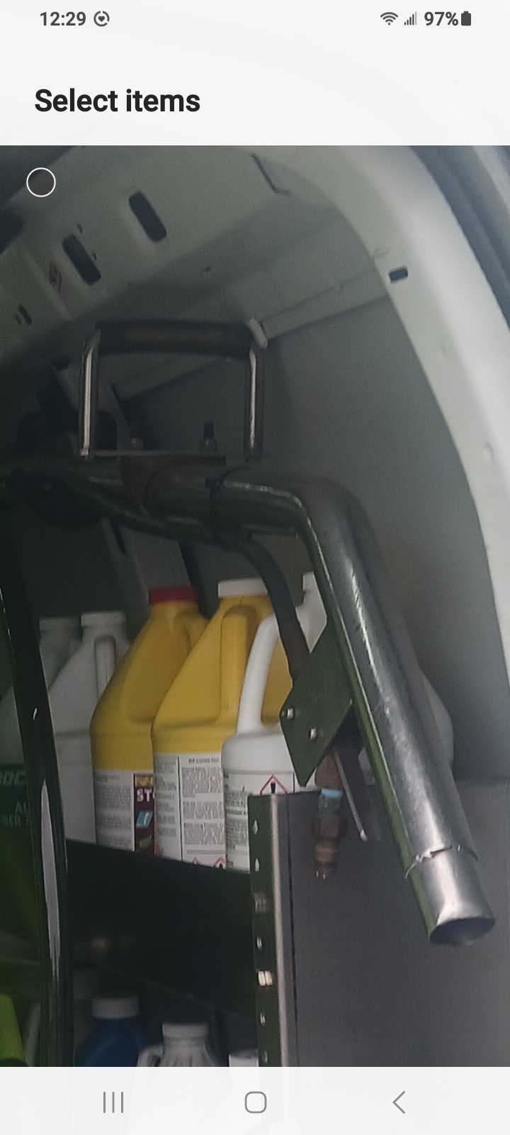

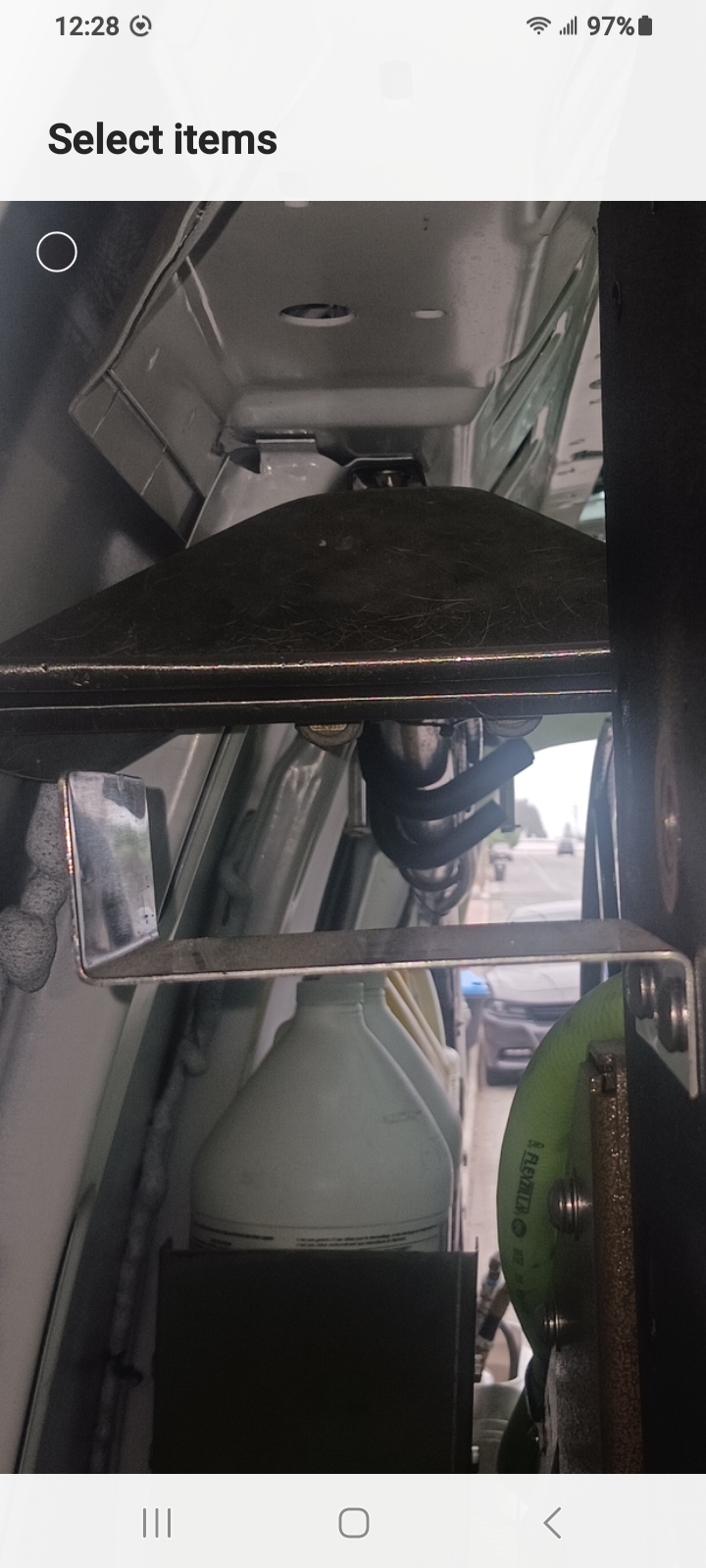

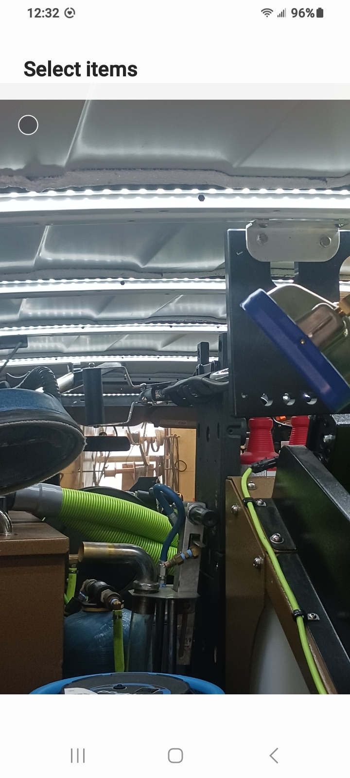

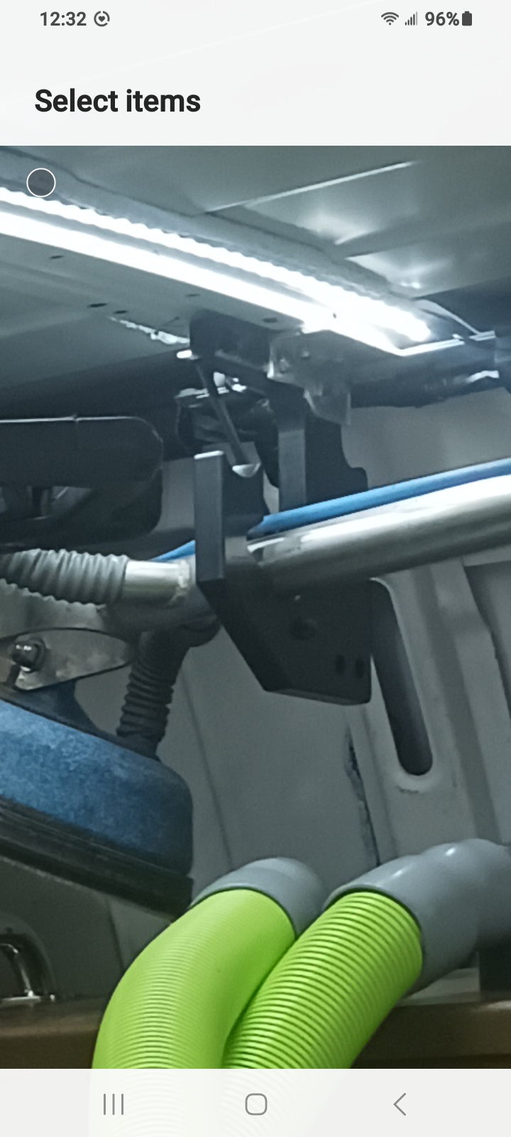

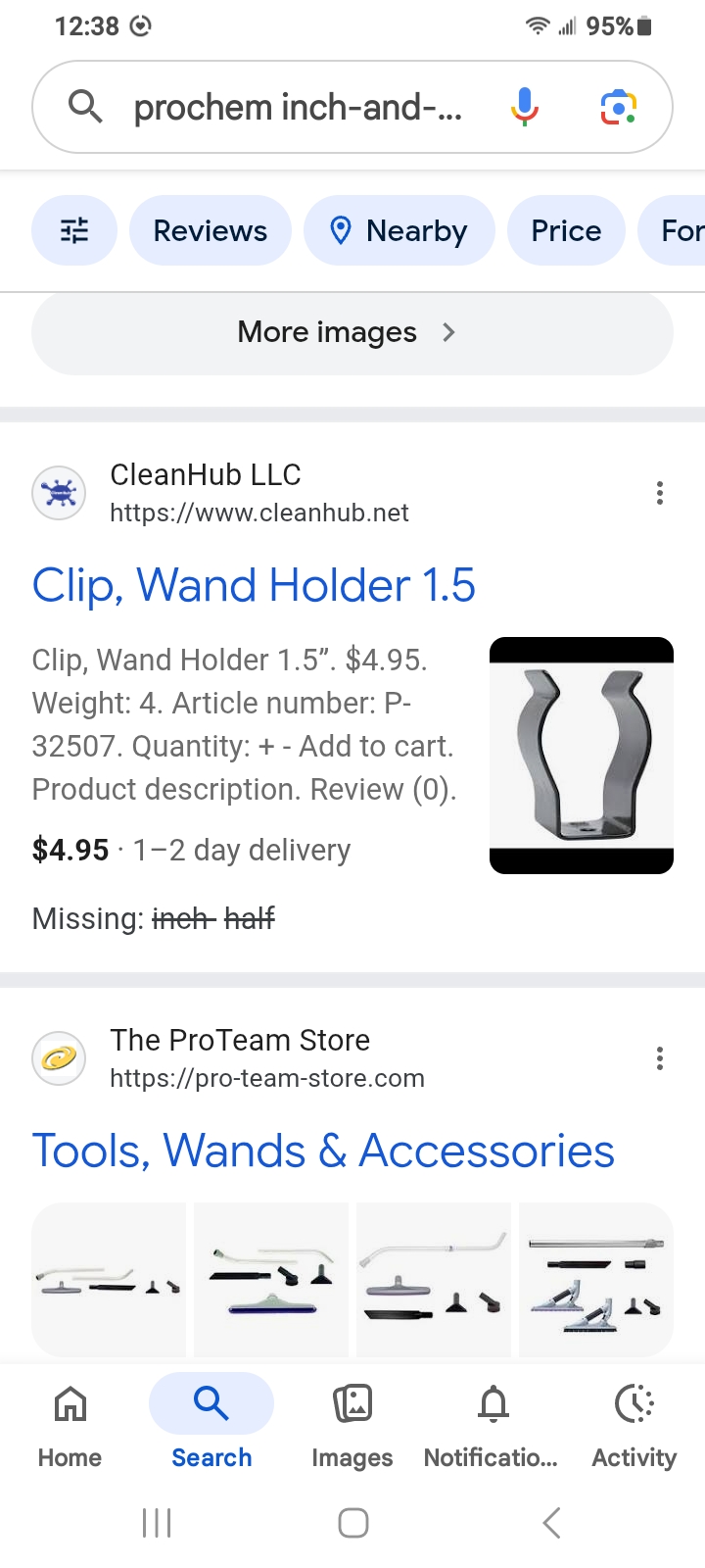

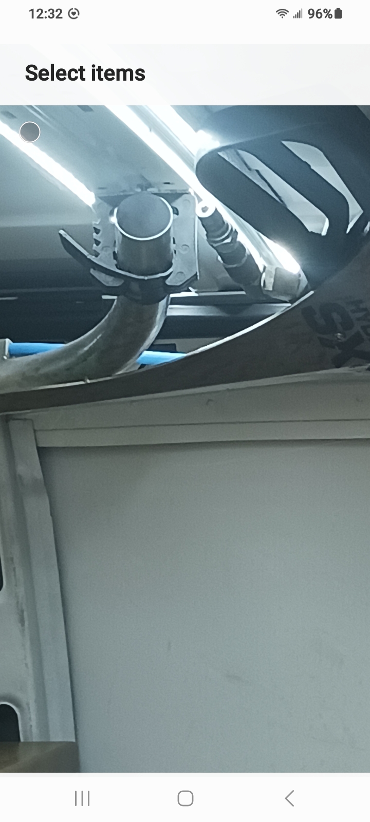

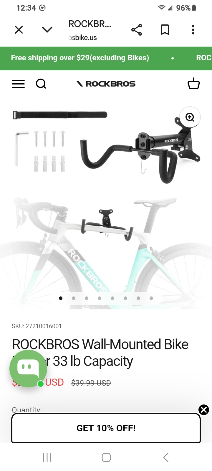

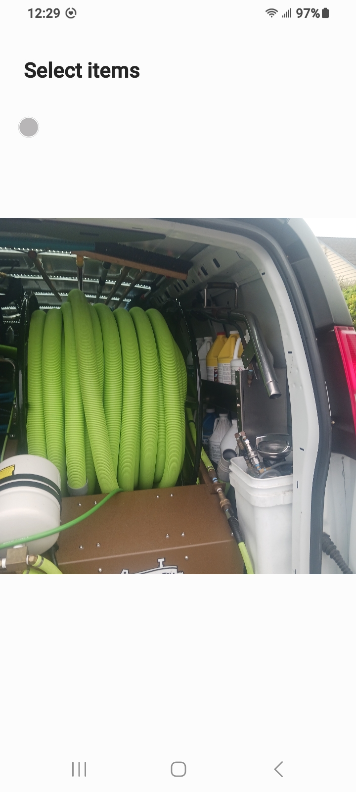

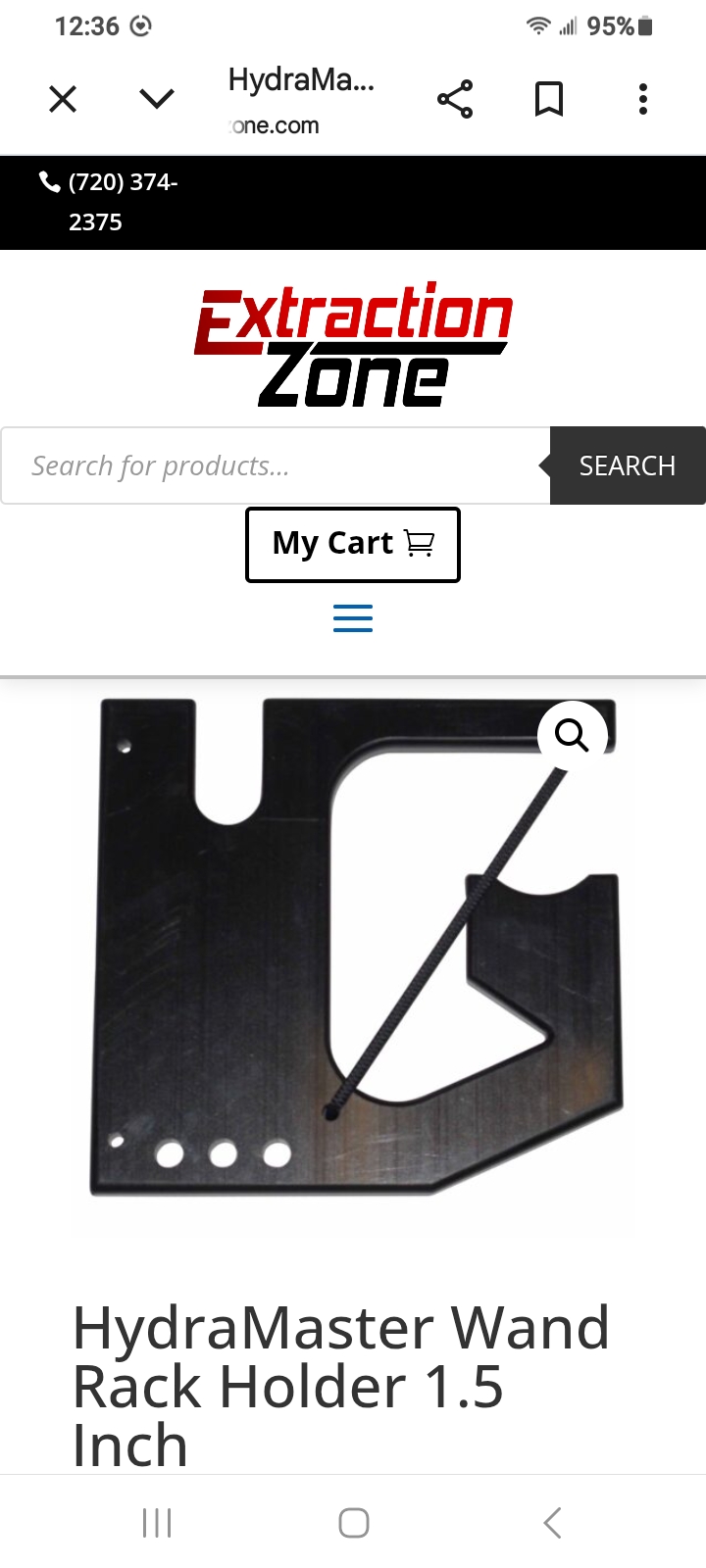

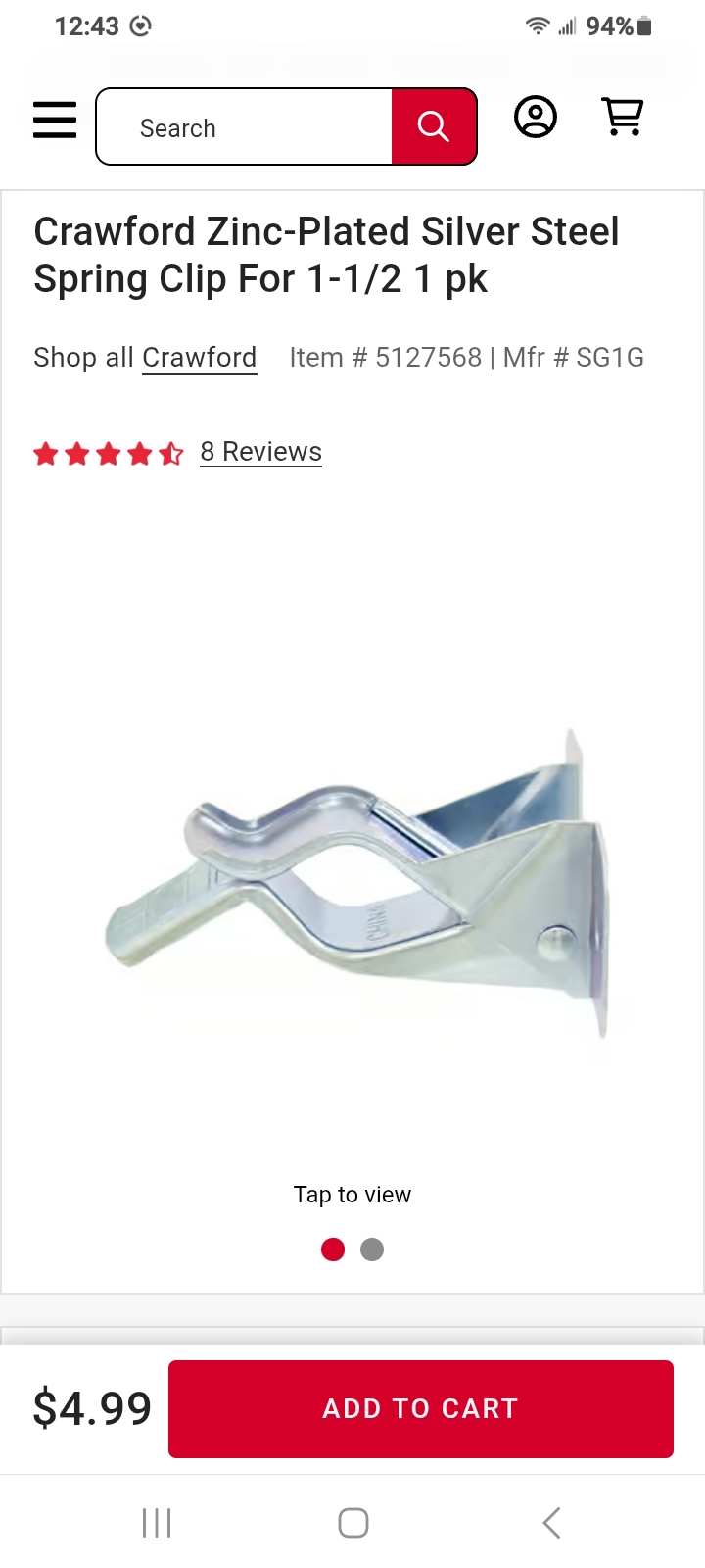

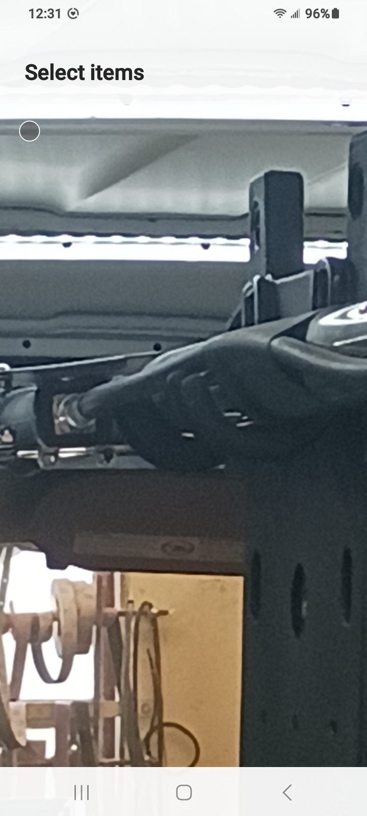

So then....you've attached mounts that holds yor wand on the wall of yor van.....great idea! Saves space I'm sure...

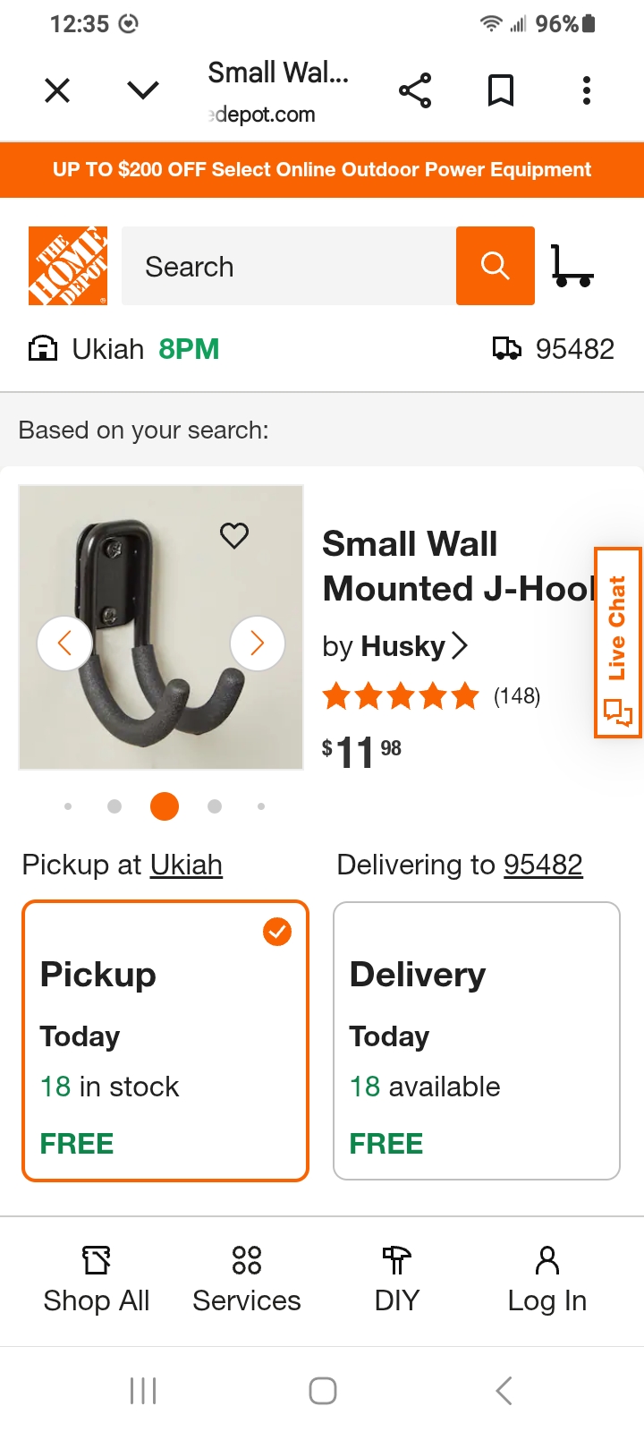

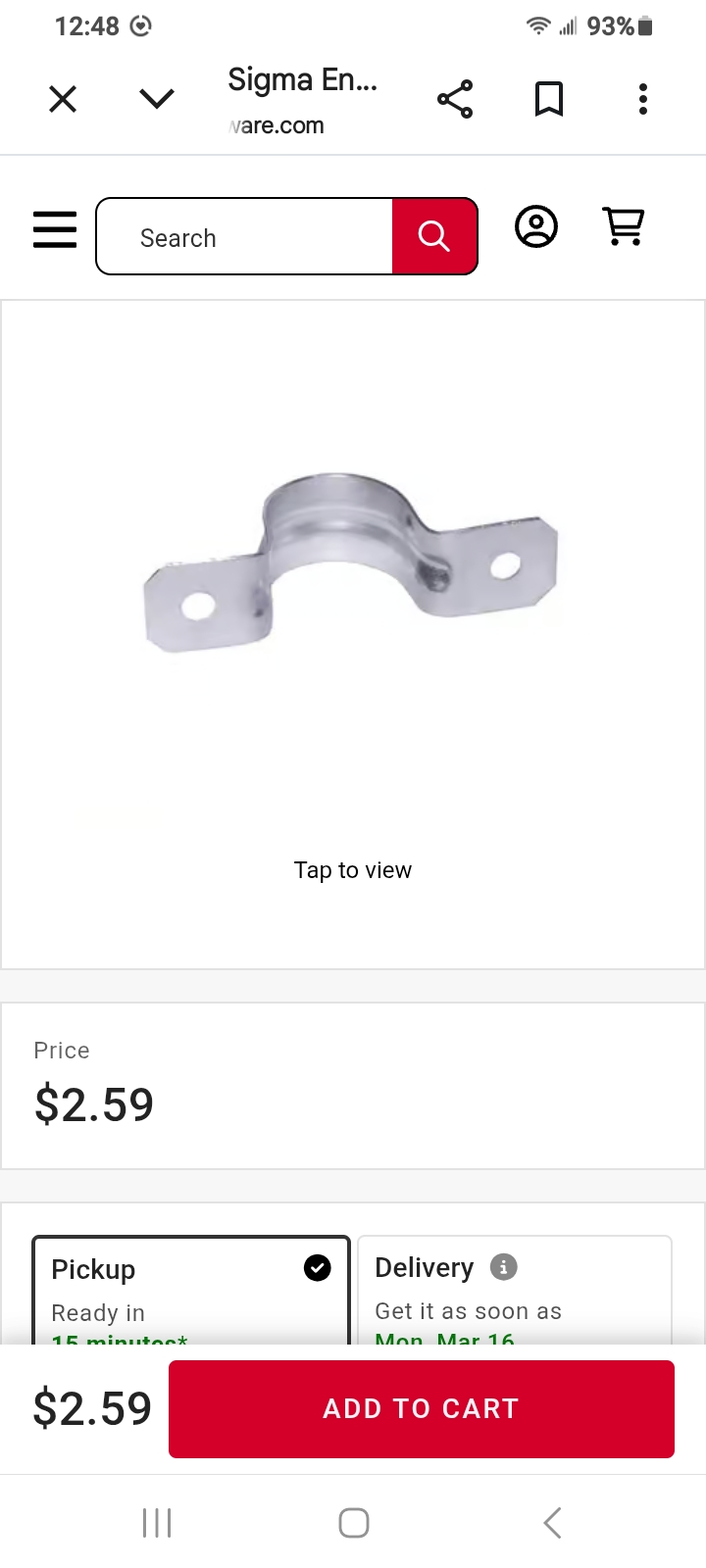

I did, for a regular scrub wand i used a wall mount bicycle rack and a prochem 1½" wand clip. For my gekko wand i used a home depot garage tool hanger with½of a hydramaster wand holder assembly to hold it and a 1½" rubber tool clamp to hold it in place. For my 15" spinner i used the other half of the hydramaster wand holder assembly and another rubber tool clamp to hold it up and a 8"×8" sticktape foam for protection for brushes ,rakes mops etc a used spring clamps on one end and pipe straps on the other In 3 years only 1 carpet rake has fallen ( on a washboard dirt road). Everything is secure, organized,no rattling around and frees up alot of floor space.when customers come out to see this custom Frankenstein thing (and they do, its encouraged) i show them not a pos setting in there drivway leaking, instead a well organized clean system that reflects pride of ownership and quality workmanship. And yes at least ½ the people i work for has had the "Frankenstein experience " and i regularly get calls from new clients saying that they heard from another customer that i have some special equipment i bring to clean .... and the show starts again. Everything in your van should have and be in its place. This is a lesson i took from the military "gear adrift will sink ships"

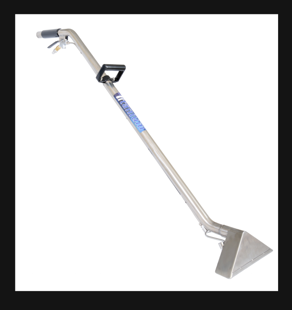

I'm tossing around the idea of making two alternatives to my beloved 12" -1.5" Chosen Wand, based on recent requests.
A Titanium version that's a pound and a half lighter.. (waiting on a price)
And a shorter version , roughly a foot, for tight spaces, stairs motorhomes etc ($570)
This near perfect wand continues to sell like hot cakes with cleaners of all ages being so enthralled with it, they daydream of ...options...
Thoughts?
Any photos of the short version¿
