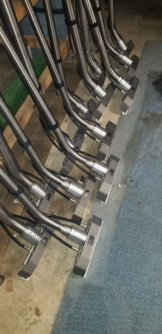

@Mikey P I like the lightweight of my 1.5 SS 12 wand, but I feel like I'm going to bend the wand-- seems flimsy.
24,069
@Kenny Hayes , here's your chance again. I really like mine. It is so nice and light and does do a good job cleaning stairs. Even if it has only one spray nozzle, it is plenty enough for the job. I have babied my stair wand because I really do enjoy working with it.
