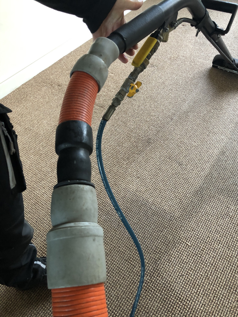

Those of you who run an 1.5" wand, do you prefer to use a whip hose or do you use a converter cuff and run 2" straight to the wand?

Easiest thing to do is a 10 ft whip. You won't have any appreciable drying time difference using a reducer cuff. The whole purpose of the whip is to reduce the weight and stiffness of the hose, making easier to use. I'd love to have a tapered whip if they were more durable. I heard Tom may have something.

I use a 10 foot whip flexible 2 inch hose right up to my 1 1/2 wand

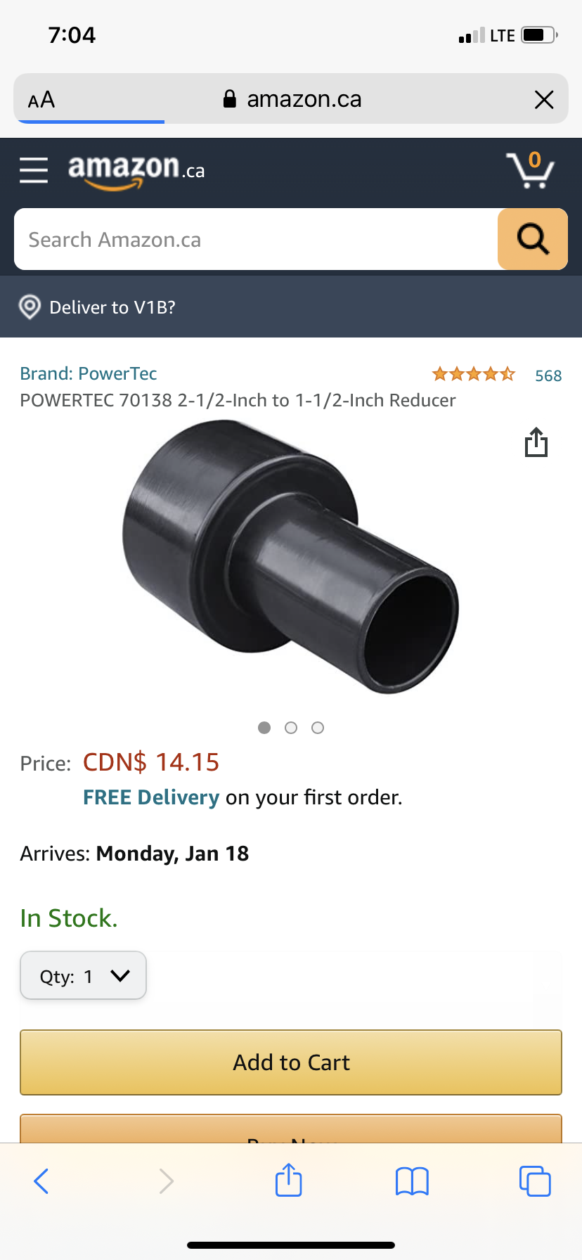

So 2.5 to 2 to 1.5 makes sense?
Brilliant! 🥴
Why not try 1.5 all the way to the truck. Its easier to handle. 🙄
Not so funny....
We did a job last year, and there was a resto company in the next building. He WAS running 1.5 all the way....IDK how long his run was, but I watched him peel off at least 100’...
I’m sure that carpeting was really dry by the time he finished...
