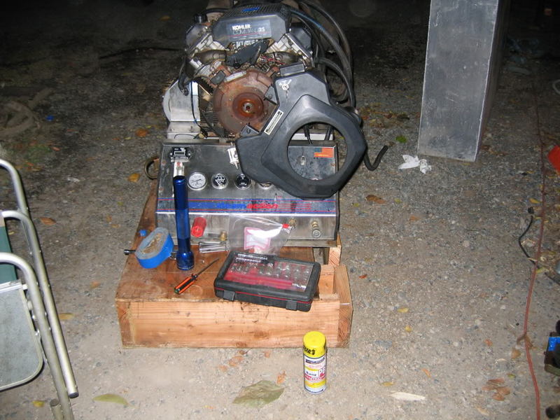

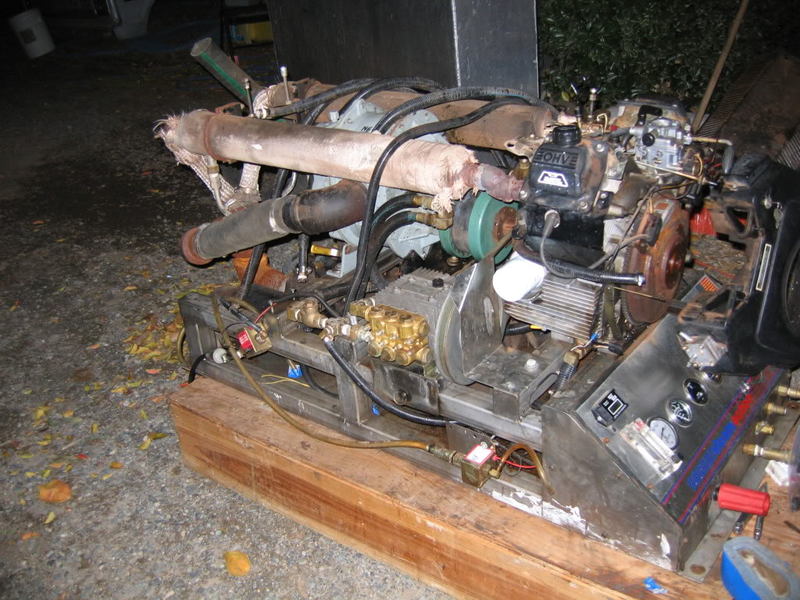

Dang it, anybody got a 25 hp kohler, first took spark plugs out well one at least the other took awile to get because it was frose in there and strip the threads out coming out, so I ran around to find a heli coil and got back and started messing with the machine was able to put the old spark plug back in and spun it over and didnt shoot out so I thought well I'll try to start it now. so I hooked everthing up to just start it ran it for a few seconds rev it up a little and it was running just fine and then hell broke loose like when you blow a motor but no noises leading up to it. look like the sparks and small junks of alluminum came from the front like where the air cooling fins are no visual marks of what broke I know the motor wont turn over right now so I've got to tear it apart to find out what happened. this thing is aready starting to bite me. but blower sounded fine.

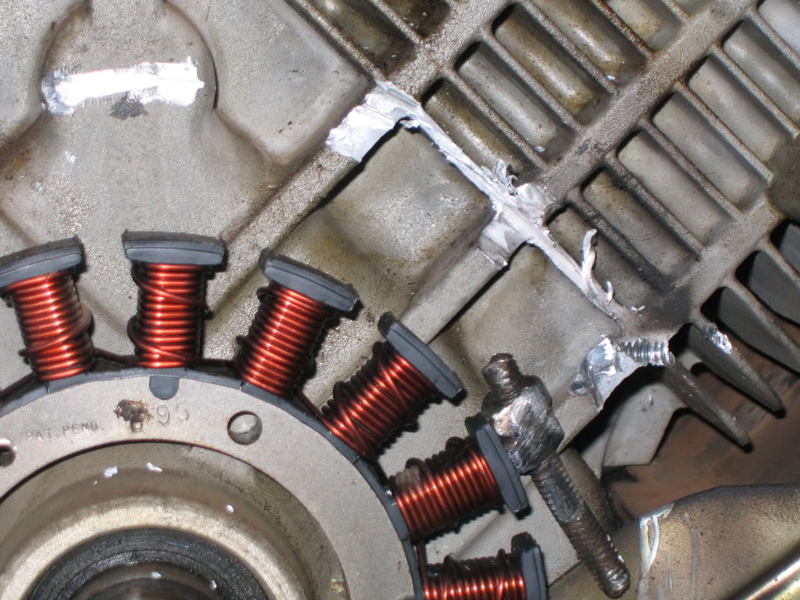

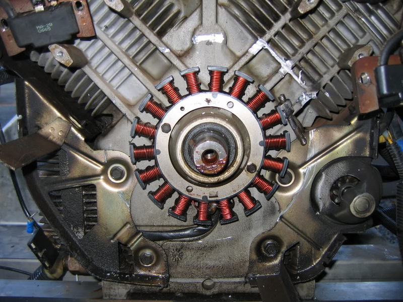

Well I went out there again when I had a little time and tore into it and got so far as the fly wheel and didnt want to go find my puller for the night but I found part of the problem there is looks like a 2 inch bolt that is stuck in between the fly wheel and the crankcase and the alluminum chunks look like little bits of cooling fins so until I have taken it apart all the way I wont know the extent of the damage. will update yall though. I kinda miss spinning wrenches.

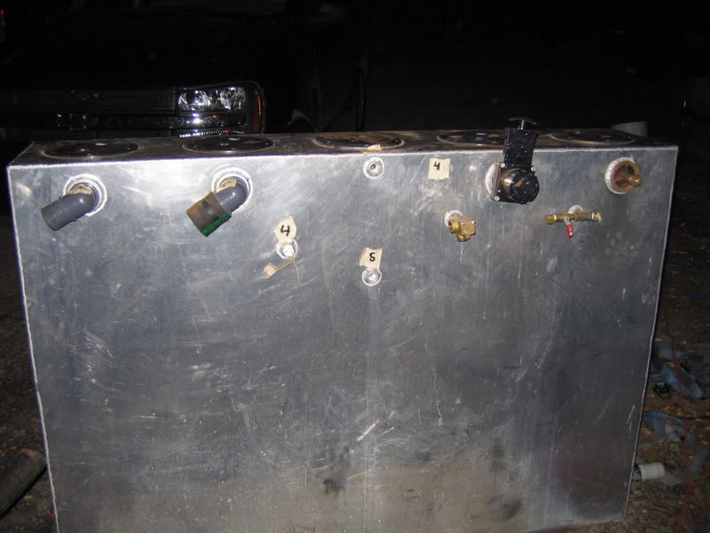

I was talkin about what he paid for it.It has froze see the gauge? so pump is probably gone and maybe the hx and those are not as bullet proof as greenie thinks but they can be fixed I know we've fixed those same ones 4 times now. Next it is covered in dust which has been wet more then once so the blower probably has rust an the engine would be iffy which we now know. all these things put the machine at 500 or less. Now some people said the parts are worth xxx well the used parts market aint what yo think it is. I have 5 blowers sitting here and they aren't flying off the shelf same as the used engines or pumps. So i'm not bustin' his balls for buying it but anyone that said it was worth more then $500 and that might be a stretch.

Well she is back together and running like a champ hook up some water lines and got a couple leaks but pump is working I think the pressure guage is jacked up. Blower works fine good suction still some reworking to go on.

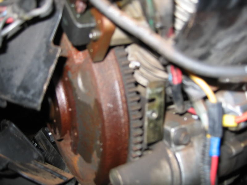

Ignition coils look good along with the alternator. How is the flywheel? Looks like there is no major damage.
