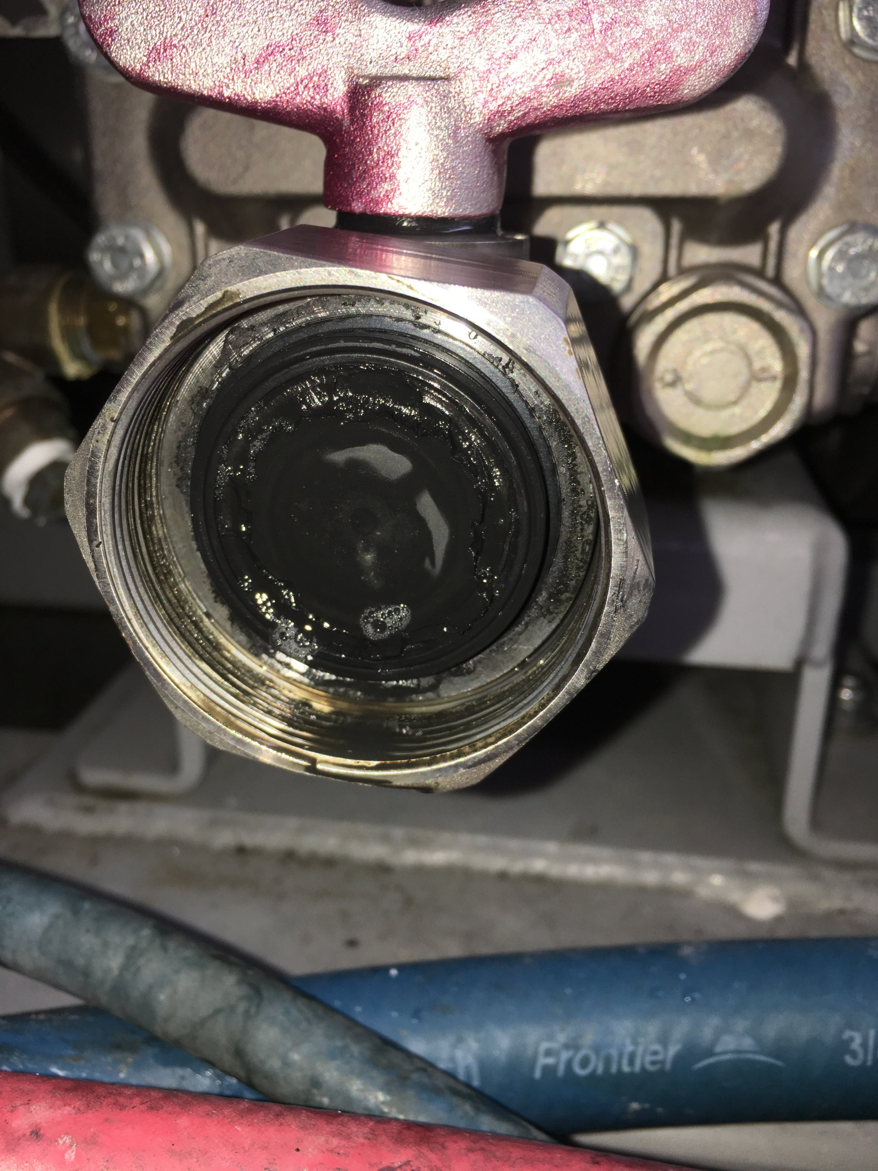

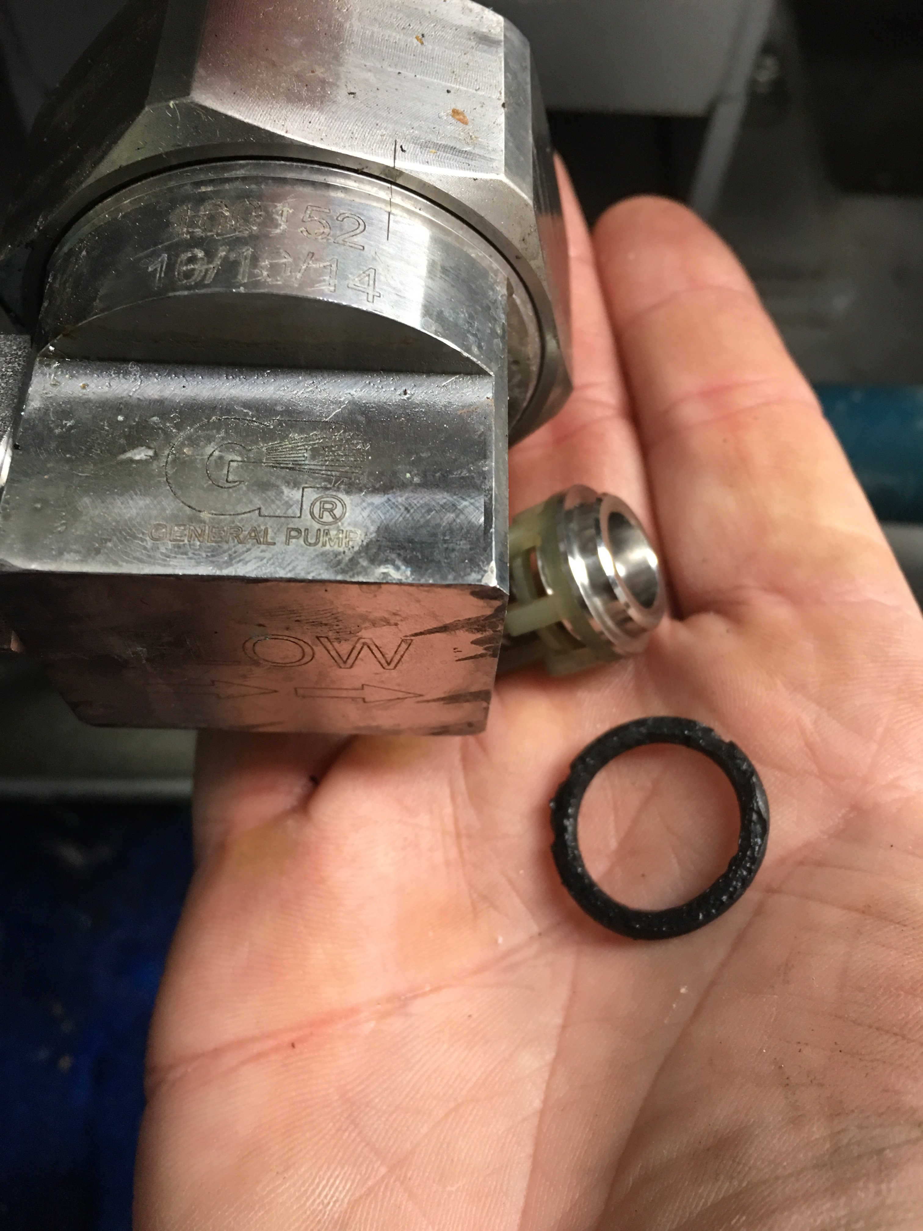

Looks like the O Ring on the high pressure side is chewed up. I’ll flip it around and get through this job.
Yeah, I have been getting blow by when the switch was turned to the off position. The shuttle would just slightly vibrate. That would explain why.Sweet.....thats like the check valves being stuck open..its allowing it to blow by and not building pressure..

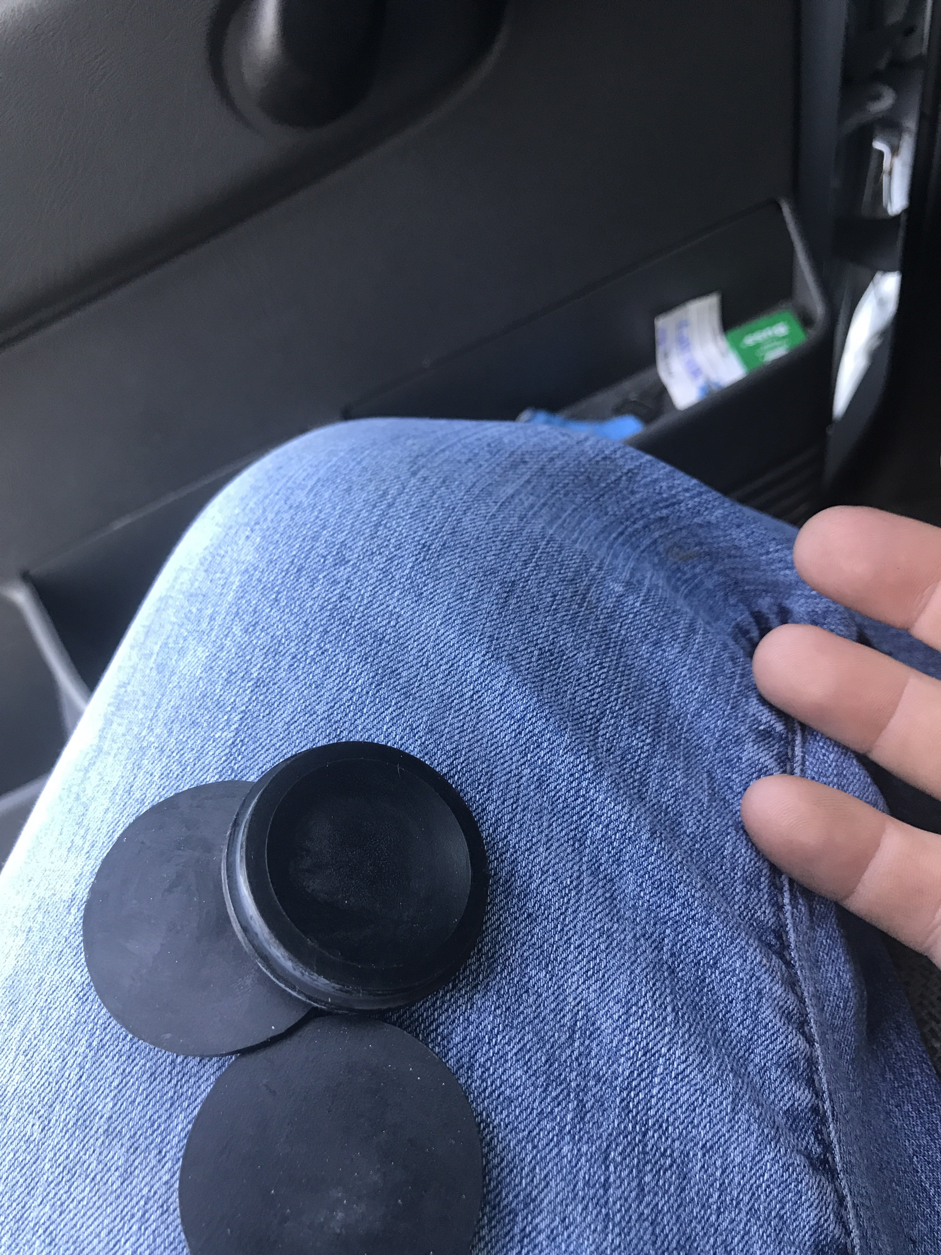

1400 hours so far. Is this something I can get at ace hardware?change the diaphragm while your in there, 500 hours is usually all they last

Any chance you can throw me a link for these diaphragms?View attachment 77047 Buy a bunch. Every time a goofball is cleaning tile at 1800 psi, it nukes the diaphragm if they forget to shut the ball valve that isolates the chem pump.

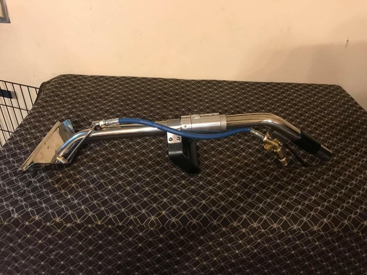

Who makes that thing? Swivel looks to be in a weird spot.
Ace is the PlaceWouldn't car part stores like summits racing carry the o rings?..they are usually rated high pressure/temperature resistance
