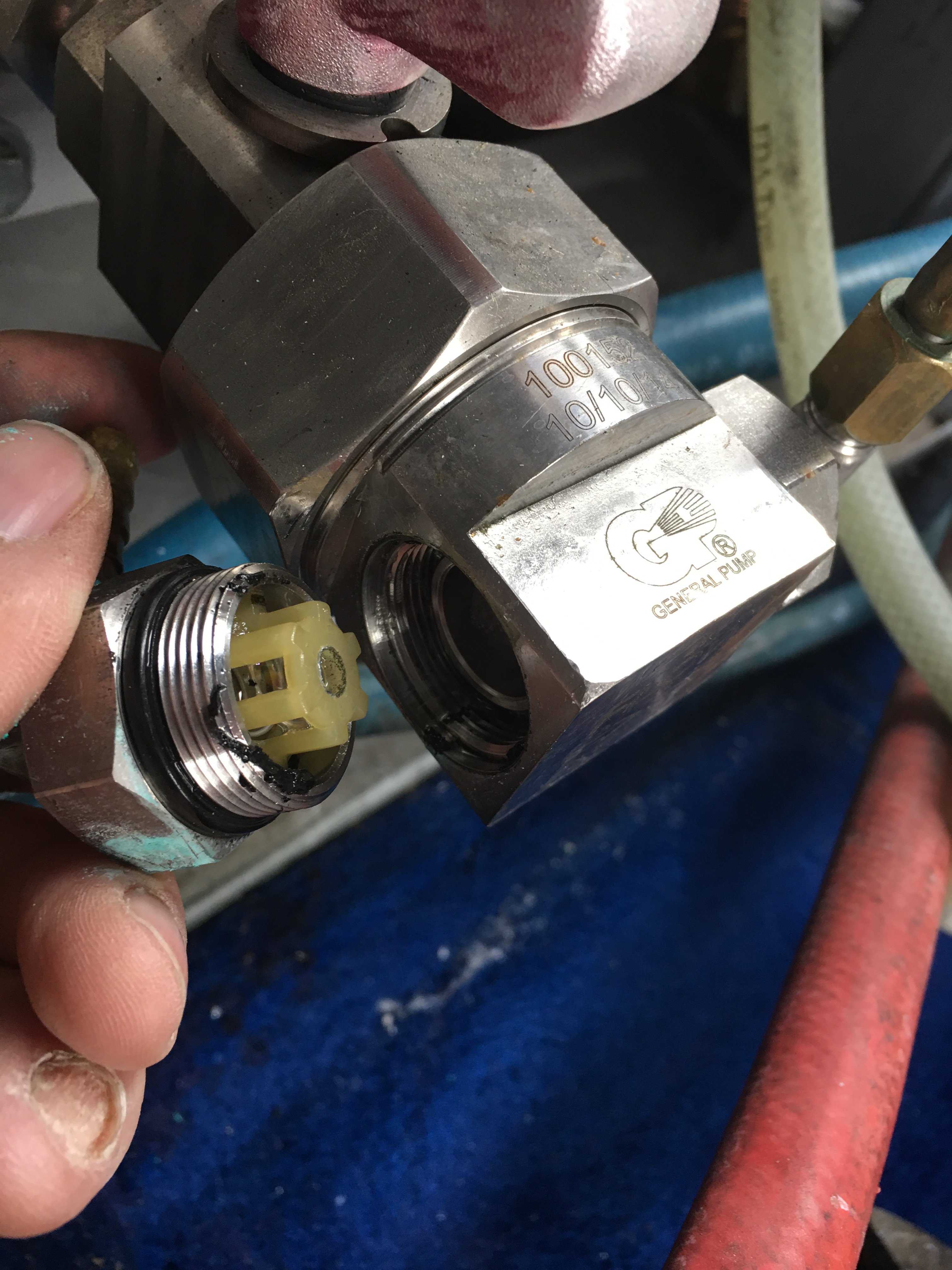

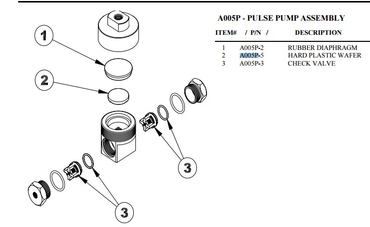

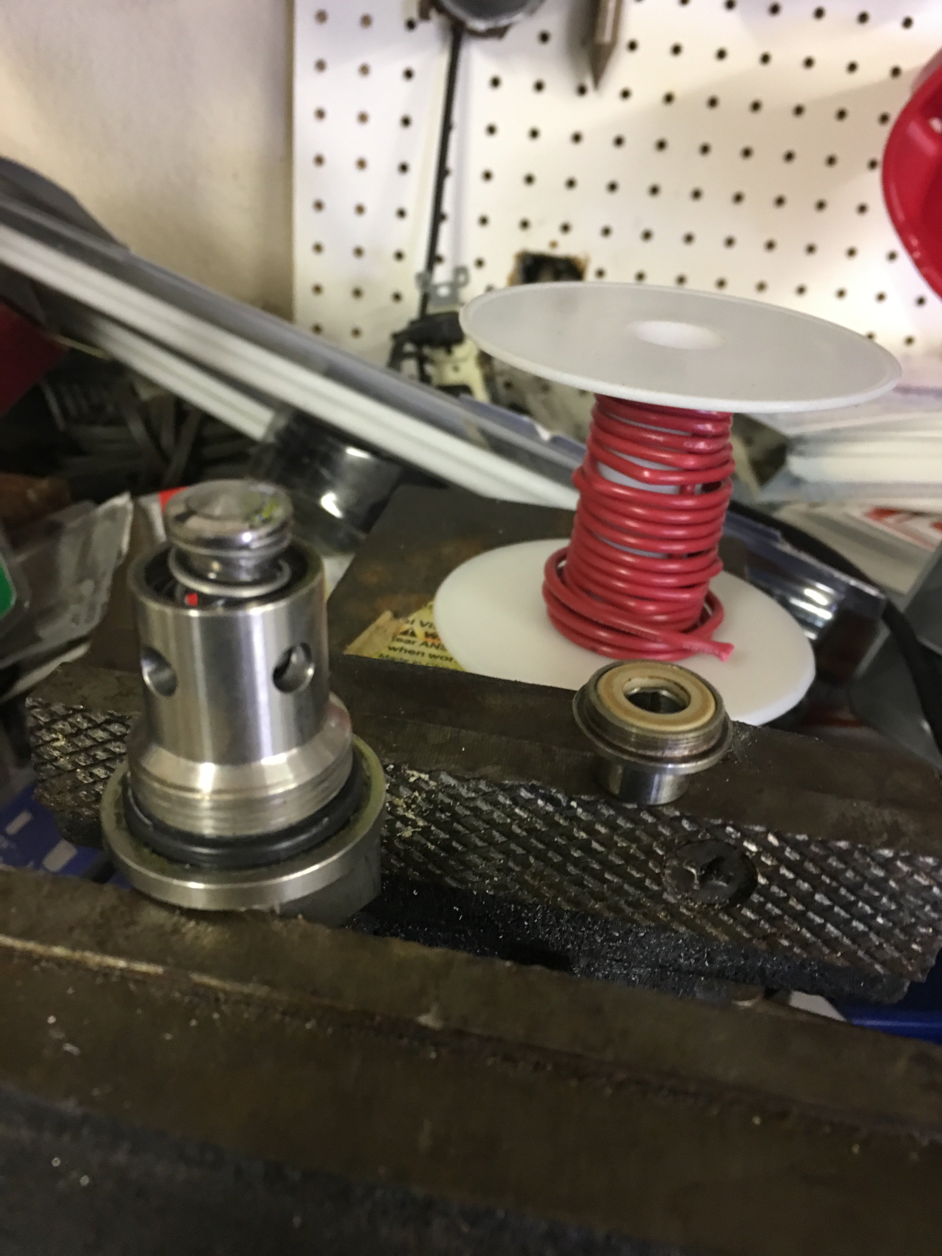

Would this be beyond use? I probably made it worse by taking it out to check it.
24,146
@Mark Saiger , after watching your video I think I put that white disk in backward. I'm going to go flip it around and see if my injection comes back to life.
Reactions: Mark Saiger
24,146
You guys and Meg aren't going to believe this. I flipped that disk around, put back in the chewed up diaphragm, and it snapped back to life. Ok, back in business. I don't know how much longer I have with that diaphragm but I have new ones on the way. Thanks for the video Mark.

I should probably check my APO rubbers. I'm almost afraid to look.

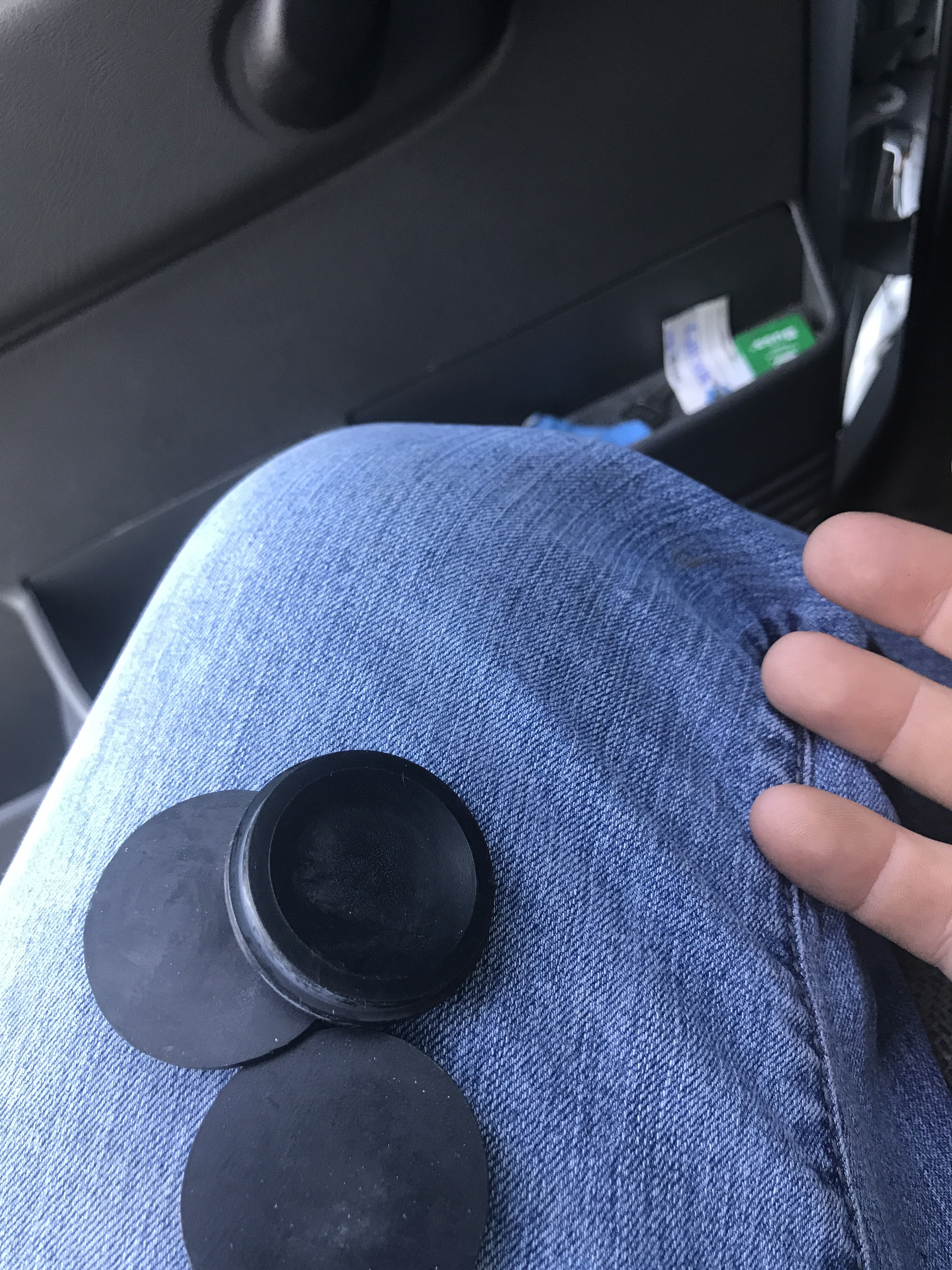

Dear Lord..dont touch the APO..that thing should last year's trouble free...just flush it out with clean eater now and then...your o-rings and diaphragm on the chem pump are being desolved by your rinse chemical...over time it starts to deteriorate them...between that and the high PSI when cleaning tile..1000 to 1500 hours is about what they are good for......the only thing that goes wrong with APO's is when they are left sitting to long and not flushed out...or if there is no in line filter and crap gets up in the check vavles...other than that they are pretty bullet proff....

Yeah I leave the pump on but the chem switch to off with tile. I never need to go over 900-1000 on tile. I don’t like blasting grout. The heat and chems seem to work for me. But maybe I’ll start turning the pulse pump off just to save wear and tear. But I can’t complain. I got almost 1400 hours out of it.
I know I said it before. But thanks to all you guys for helping me out. I learned a lot. Turns out I didn’t need to remove the muffler.
Reactions: Lee Stockwell
dealtimeman
Everyday is Saturday.
Sep 20, 2008
Michael
You should score the white disk as this will make the pump work better and give a bit longer service life to the rubber diagram.
