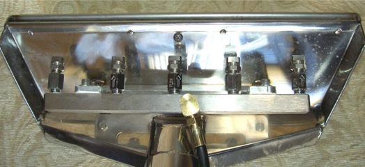

or the 5 jet CMP with Greenie mods:
They have similar specs and base wands wo/extras are slightly over $300.

Another difference in the wand heads shown is the angle at the outer edges.
The AMF wand has a sharper angle which cuts down airflow at the edges.
The CMP designs flow air with less bend, which increases airflow and overall CFM.
Like you mentioned, we prefer the 1.75" tube for minimizing valve-operation hand stress.
