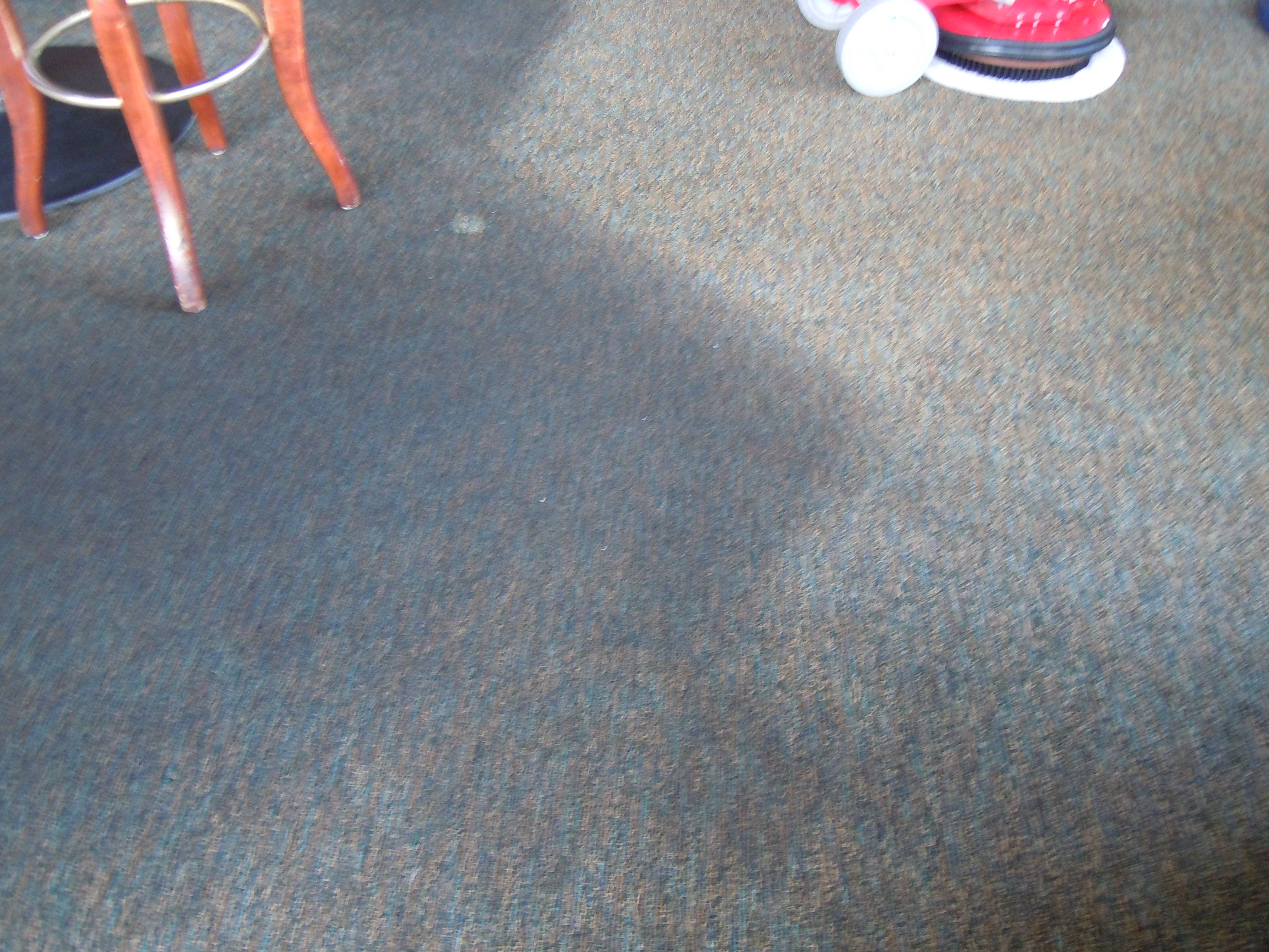

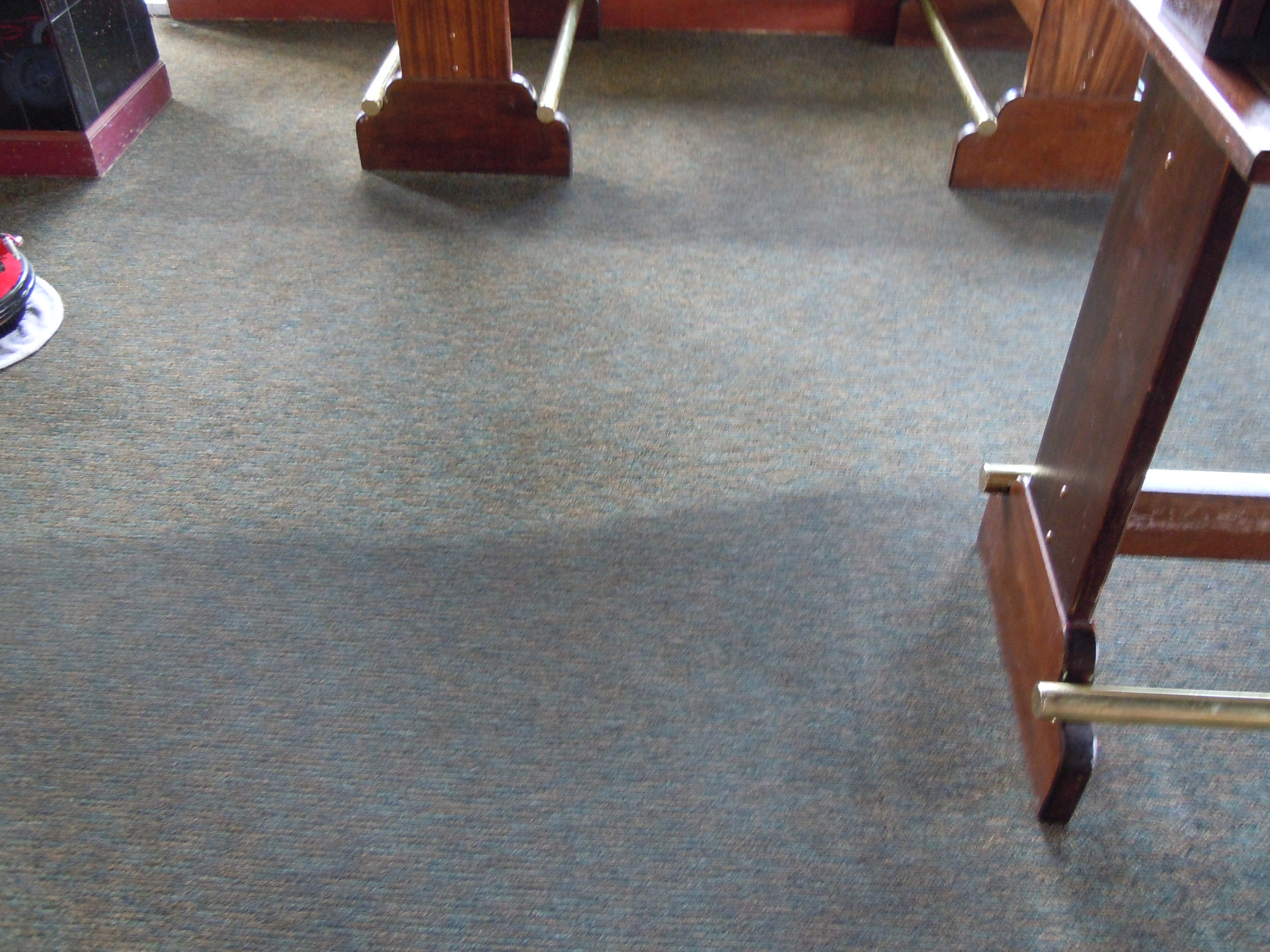

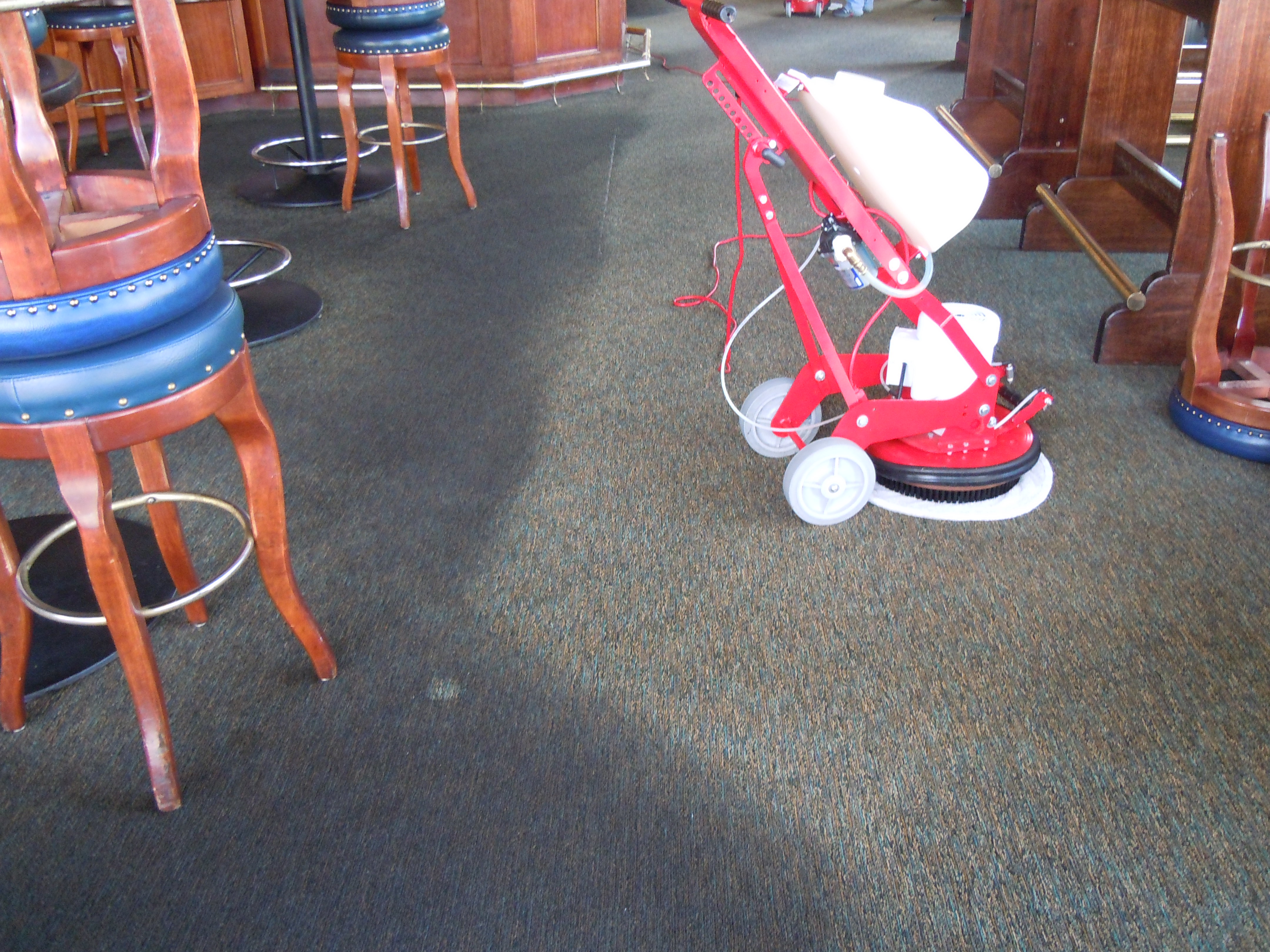

Old CCS Brute, using CCS blaze encap. Tackling the pathways that were worse than the rest. Used 18 pads for approx. 1500 sq. ft. Pads were very black!

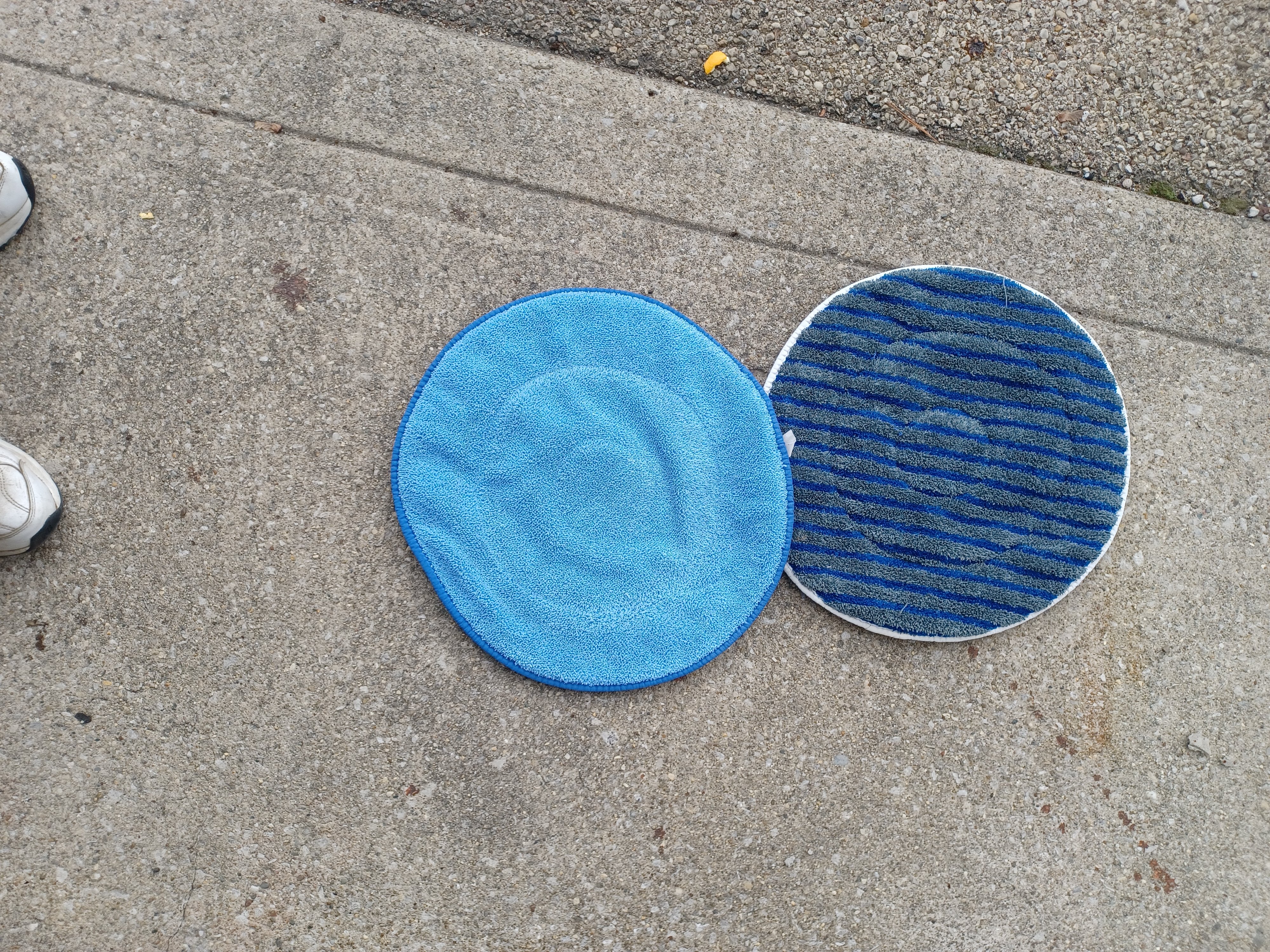

No mention of using blue microfiber pads..
Have you?
Wow! Argosheen! Now that is old! I still have a half a gallon of "Butyl Juice," the old recipe of Vacaway's Hot Knife. I did use up the last of my Abstraction about five years ago on my own Berber carpet. Antique juice for antique carpet! :rockon:
I am a bit old school on pads, I have both striped Microfibers and Cotton pads. In most cases I use cotton. The aggressiveness of newer machines tend to make Microfiber pads only single use or four times at best. By big unit is one of the Erasers, and if I go over 70% it will eat Microfibers like crazy! It will even thin through a new cotton pad if I run them too long. I get a great swath with the machine but change pads much more frequently than I do on my small Liberty. The microfiber seems to sheer imbedded soil faster and more effectively, but I think that I get better absorption from cotton, especially on spills.
