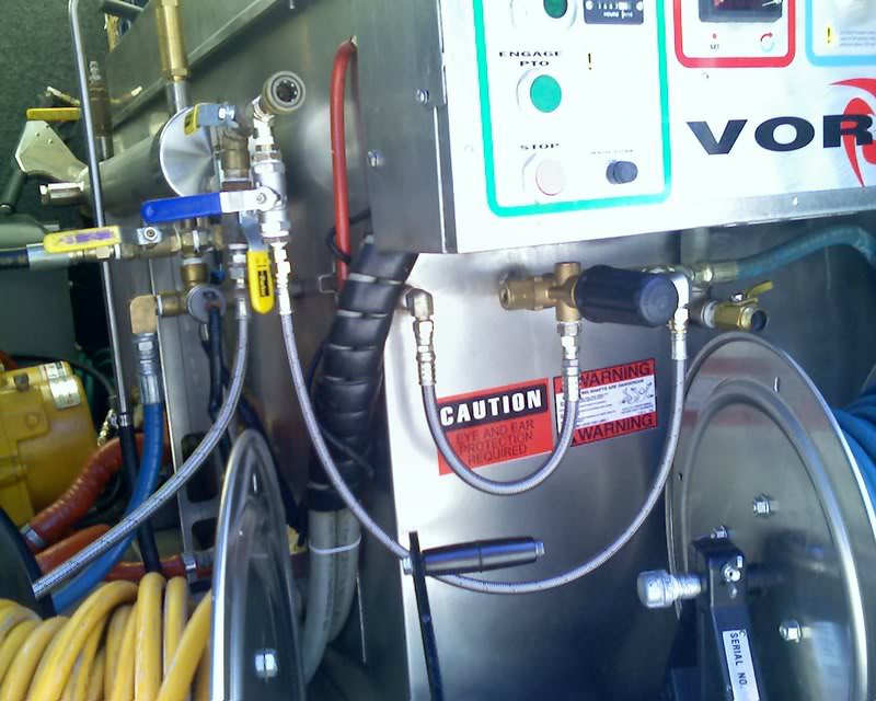

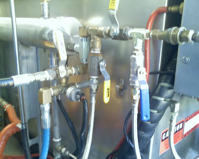

Instead of having a QC on my "Cold" water line and a QC on my "Hot" I ran it over back to the hot line and added a ball valve. Now I can hook up once and with the turn of a ball valve I can run hot or cold....

great idea mike! I don't know much about Vortex's, so I might be off base here, but did you get a ball valve that will hold up to the pressure and heat?
117,373
The Carbon ones from Parker hold up for up to a year.
I have some SS 2000 psi BVs that I got from GG and Sal M that are holding up too.
Did you know you can spend $200 bucks on a ball valve?
Jim...It would involve one more BV, another T and 18" on SS/telfon hose to run it to both reels.. Not a big deal.

I am not sure we are speaking the same reasoning here, but I added a ball valve to each live reel input so I could isolate it if I blew a line.

My set up is so I can use the "Cold " water from my tank (to use my HF and clean sensitive fabrics and wools) and then switch it over to "Hot" for every day cleaning with out disconnecting the hose....
One hose, two temps.

Nice job, but too much plumbing hung out from the HX ? cylinder.
I did notice some Parker fittings in the mix.
Did you add those?

I added the shut off like you did by the unloading valve and used it for the first time today and noticed a huge drop in my pressure......is this normal

Does that flow to both hose reels or just one? It would be nice to be able to switch one to warm while the other stays hot for dual wanding. The AT comes with a QC from the tank but you would need a seperate reel.
Scott
117,373
Only one of my reels is live Scott.

Mike, how old is your truck? Every fitting looks brand new. You must really take care of and look after everything down to the last detail. It all looks polished and super clean. I find myself slipping in this area as I get older. Just a by product of less time and wanting to spend more time doing other things.

Butler has done it similarly for decades, and lately Prochem uses a three-way valve for this function.
You can color code your valves or vary them in some way to make the setup more intuitive.
