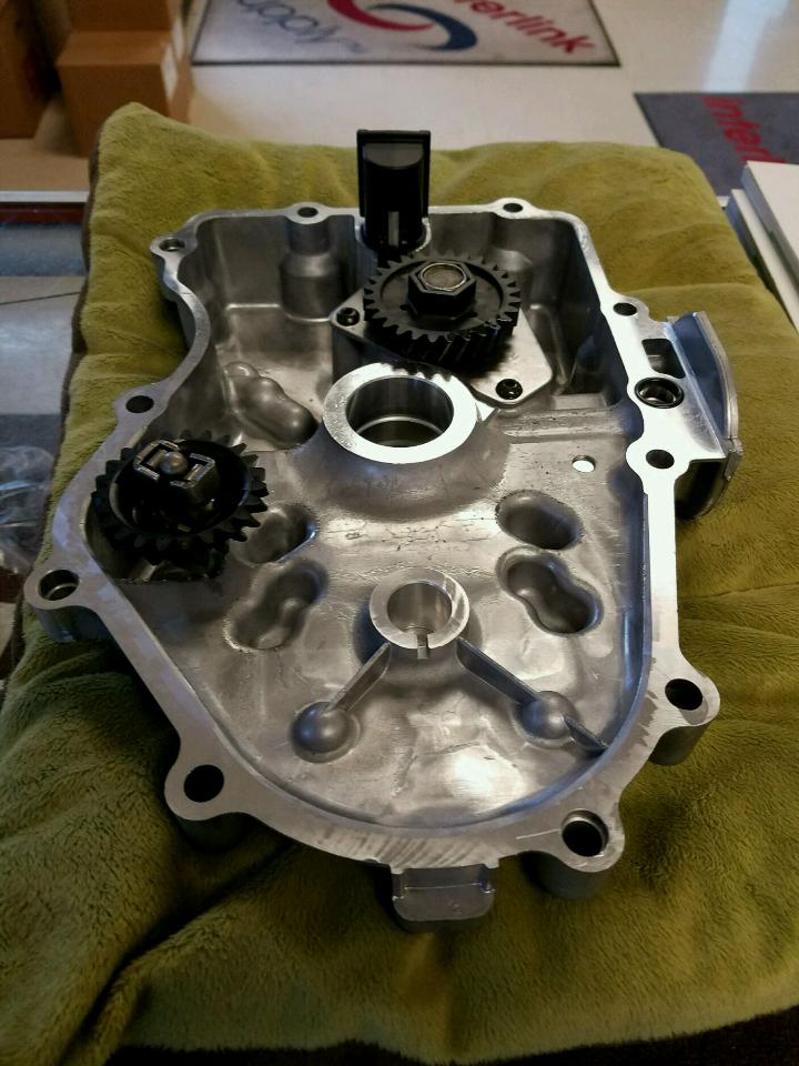

My Kohler is going in for a transplant tomorrow
117,390
Back end has an oil leak.
I guess it so common than Kohler has modified the back to help the RV THREADS do its thing..
See that bevel on the lower inner edge?
That's where the RVT will gather to do it job..
Kohler is covering the whole tab.

How much was the new rear cover? Install? My research - it was difficult to find the cover and was like 400+ just for it. Plus install. If they let you know, let me know.
I need this repair or a new engine. Ugggggg! Or just let it leak(not a lot, just annoying) and keep my money. Start over with something else, maybe.

If I were you, I'd just get another engine. I don't know your budget, but if you can afford it, go for it. It'll give you at least 5years of no payments. But I remember you saying this truck mount is nickel and diming you to death. Is the nickel and diming the same as a monthly payment, or are you losing any work on downtime? If so, get rid of it, and get a shiny new toy

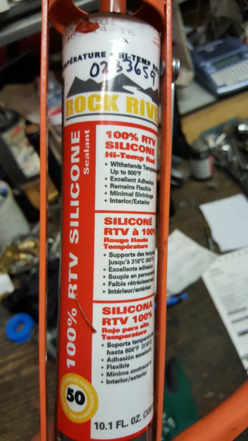

I hope it works out well. The only info I can find on that sealant seems to indicate it's for interior/exterior architectural use, along with ovens and boilers. No mention of oil resistance. Maybe it said so on the tube?
A lot of mechanics just don't like the idea of spending 25 on a tube sealant.
Apparently that's true - the sealant used is $5.99 at Fastenal....
Cheaper is better - as long as it works!

That's what I used when I rebuilt the 4.7 in my Grand Cherokee - it's still going strong 40K miles later. My sealant of choice!
