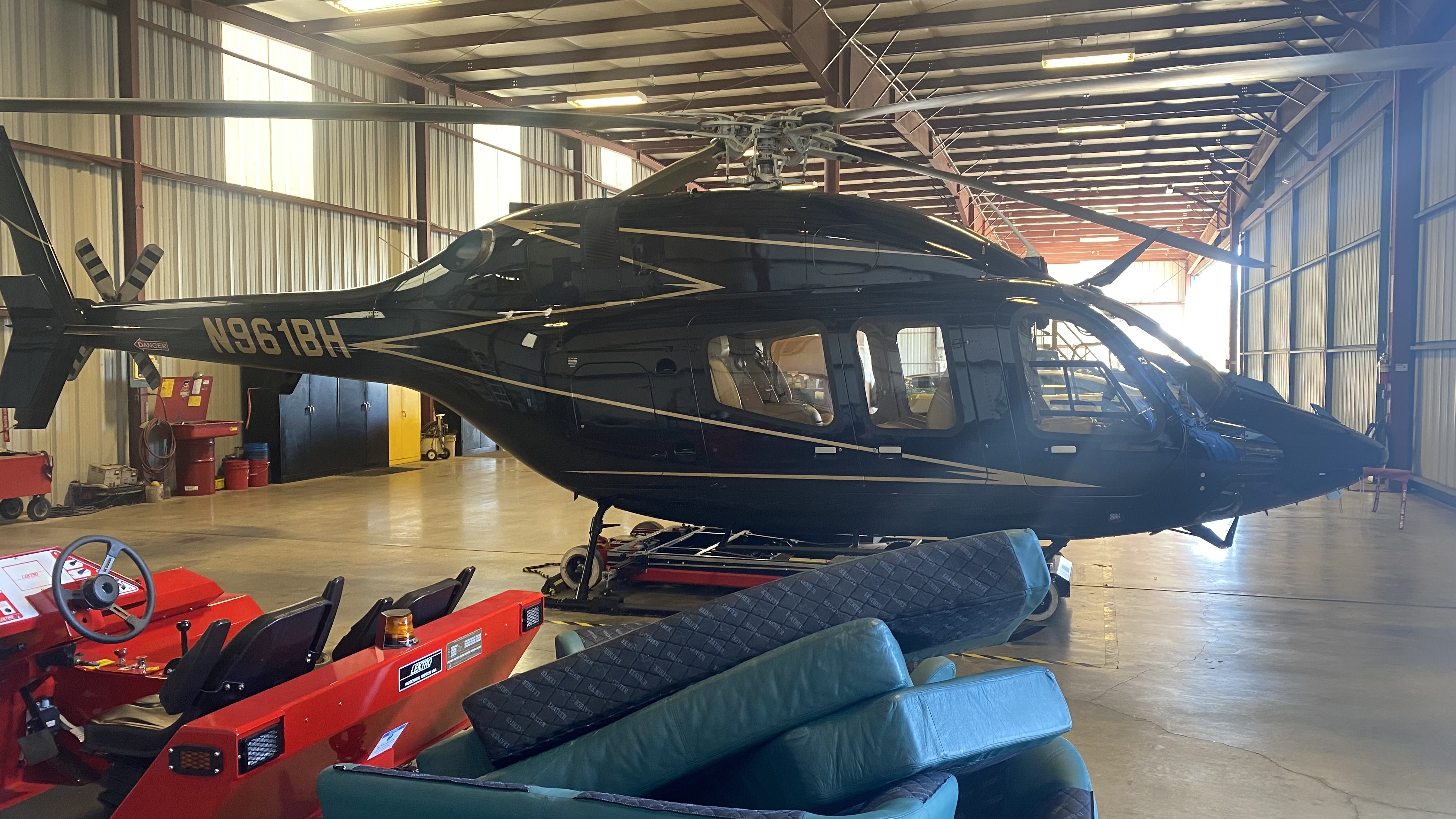

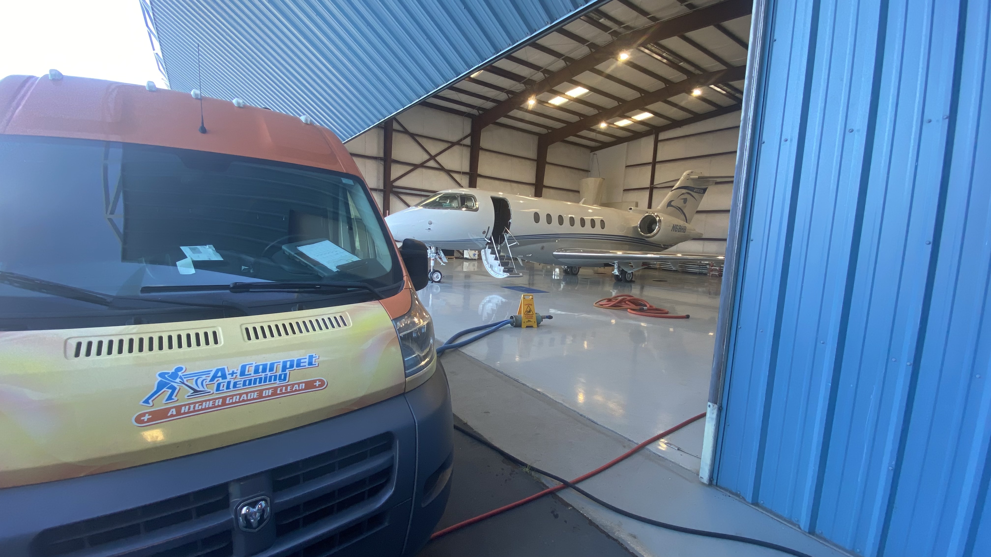

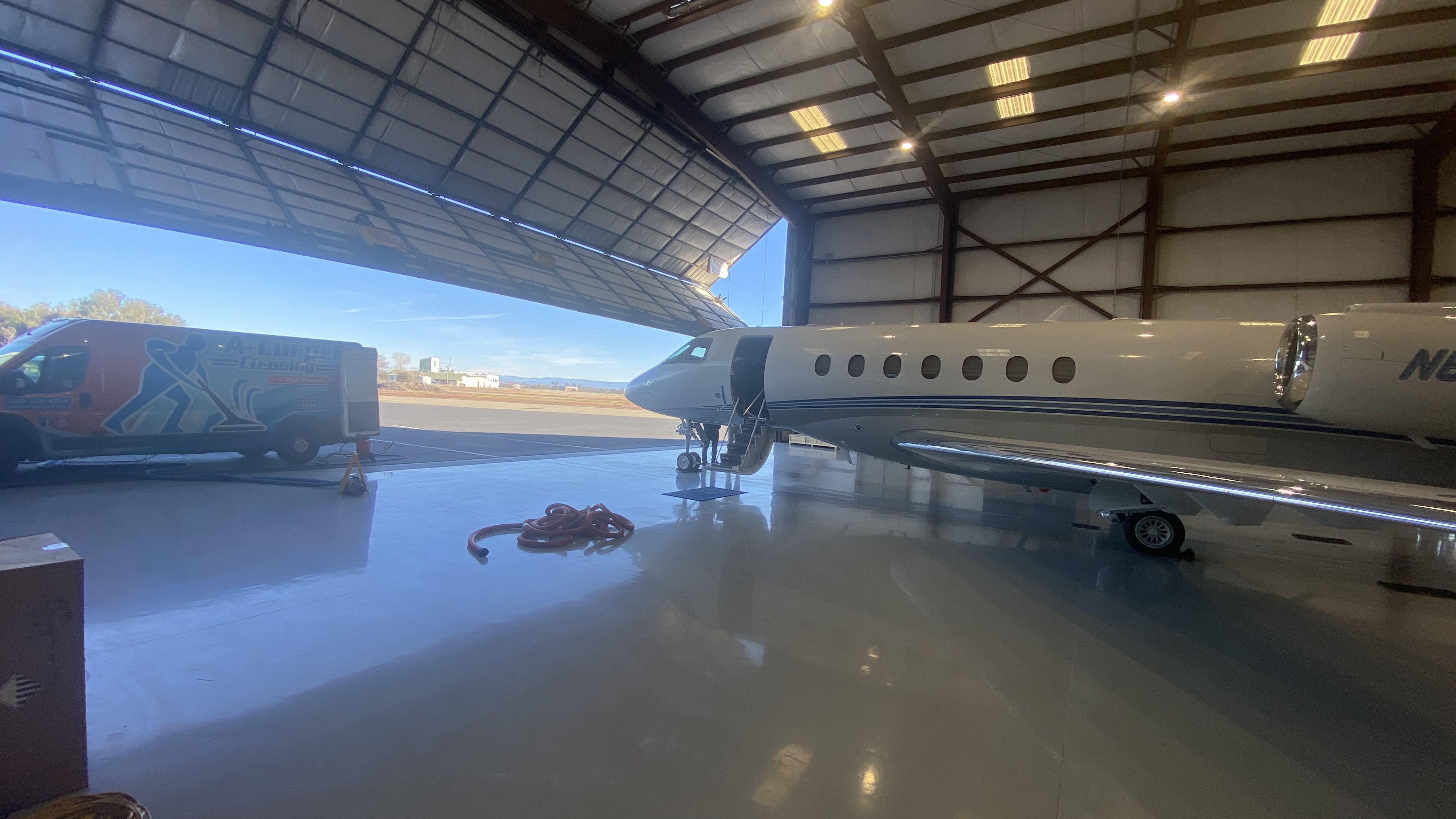

My day got fun
24,146
Not $150 Facebook special.
24,146
1 atv tire says you are not insured to be cleaning aircraft
Shins
Nope. Gotta pull everything out. I looked into getting a rider but my insurance agent said it would be way to expensive for a $50 million jet. I'm covered if they pull it out, which they had no issue with doing.
