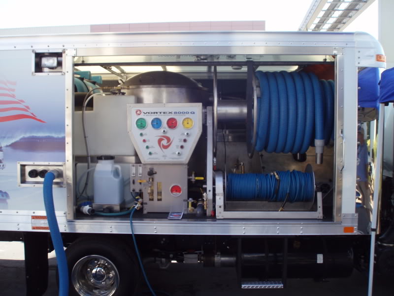

The truck of the show was definitely the new Vortex. Amazingly quite and almost double the storage of fresh and waste water from last year. The new Isuzu its mounted in can cruise at 80 and has a sweet cab interior that puts the old UDs to shame.
Starting price is 89k, so with a high pressure pump, a Softener, carpet kit and a wrap you'll be financing 100Gs or more easy.
Lots of storage for fans..

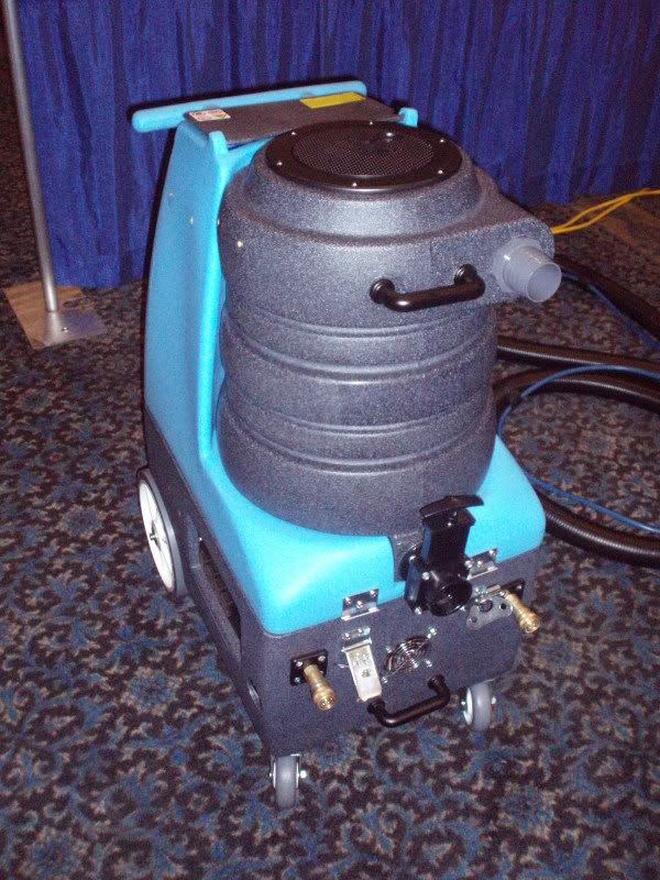

Mytee introduced their new roto fresh and waste tanks. Virtually bomb proof construction for way less than a SS tank. This was a fresh @ 80 gal capacity. Two could be linked together as well.
Will Brevick be able to make one himself from his old milk jugs?

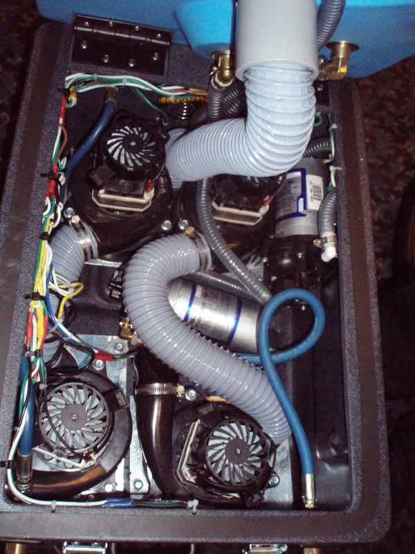

A four vac Porty! (eat your heart out Ed Valentine)

Was That Mytees 4 vac system , From what I understand that was only 150 psi . Do you know any other details on that
C
Curtis Pennington
150 psi? You cant clean very well with that....500 psi is a must with a porty
..shorten it down with 3, 2-stage and a 500 psi pump that would be sweet.

Hi Guys,
Granted 150 psi is not as high as some would like, but other factors to consider are how close the jets are to the carpet and the flow of the pump, not just pressure. The Steaming Demon is low pressure (line pressure 60 psi) but high flow. Another feature of the Mytee Quad vac is a secondary flow-thru high pressure connection that allows a 50-1200 psi Water Hog to be connected thru the unit for high pressure cleaning. This keeps the unit much lighter, about 100 lbs. The Quad Vac also has 200 CFM and 180" lift, almost 14 hg. auto fill/pump out. With a 12" Bentley and 25' 2" hose for less than $3000.00 msrp. It's a respectable portable.
Did any of you guys see our Roto-molded 5 qt. and 7 qt. replaceable hydraforce type bottles. Lifetime warrantied, if they ever leak they will be replaced for free. The 7 qt. will fit in a standard 5 qt. hydraforce holder. About $12.00 from your dist. We are also making a Roto-molded holder for these bottles. about $18.00.

I am interested in the 7 qt bottle, and also more info on the molded waste tank, I don't see any info on your site about either. do you have any pics of the 7qt bottles, also more info on the waste tank, how many gallons is the waste part of the tank?? what type of brackets hold the thing in the van, is there a float or filtering provision

Hi Steve,
The 7 qt. with rear fill port looks like the 5 qt. but taller. They will be on the web site shortly.
The 80 gal.waste tank and the solution tank are made from the same mold, just set up differently. The waste tank has the s/s strainer, at this time a single 2' inlet and heavy 3/16 s/s mounting brackets. Local dist. will finish the fit for individual TM. Waste tank is $800.00. Because of the design these tanks will have very limited water movement, which is a plus for a solution tank. These have been tested by a dist. at 15" hg and 165 degree return water. The tank didn't even flinch.
Email address and I can send out brochures on these products.
Along side our quad vac we showed our RL105. This unit has a 500 psi high flow pump, dual three stage vac (600 air watts each) 146" lift 230 CFM, with auto fill/pump-out. This has the 50-1200 psi flow thru feature also.

The new V is an impressive design, except for the track for the rolling door that runs through your walking zone, I think it left an impression on many of the people who got in it to look around. Having a single wand demo set up for a V was a poor idea. You can't see how it performs it's purpose if you don't show it. For a single wand holding 15-16hg isn't impressive as a demo.
