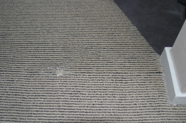

This is something I get a lot of. A lack of seam sealant and trimming too close to the rows and sooner or later this happens.
This lady caught it early and sellotaped it down to stop her crawling baby pulling it further.

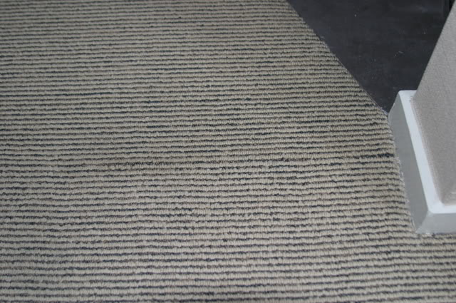

I removed the primary backing and yarn and grafted another section in.
The donor piece is brand new and so the tufts are standing taller than the surrounding area which is a main traffic area. That will disappear fairly quickly.

I assume you mean the first photo?
No, although there was a little bit of glue in there. She just taped the whole thing down to stop it getting worse so the 'mess' you can see under the cello-tape is the bundled yarn.
