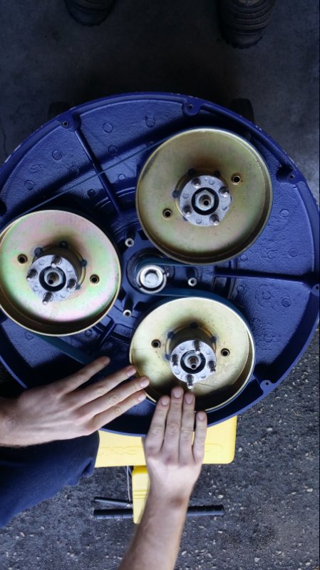

It's pretty simple Mike. Remove the white plate. Place the belt over the center spindle. Work the belt around 2 of the pulleys. Then work it onto the 3rd pulley by carefully rotating the assembly. It's basically like putting a chain onto a bicycle (back/small sprocket first - then pedal it thru onto the front/large sprocket).
A word of caution: Keep your fingers out from under the belt as you rotate the belt onto the 3rd pulley. If you get the skin of your fingers pinched between the belt and the pulley, the belt is going to win. :madder:

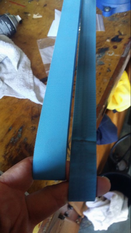

Piece O cake..
Old belt was pretty stretched out...and narrower..
Man that sucker was stretched. :eekk:

he proabably had to take it to the local interlink supply. Those pics are of a technician installing.:yawn:

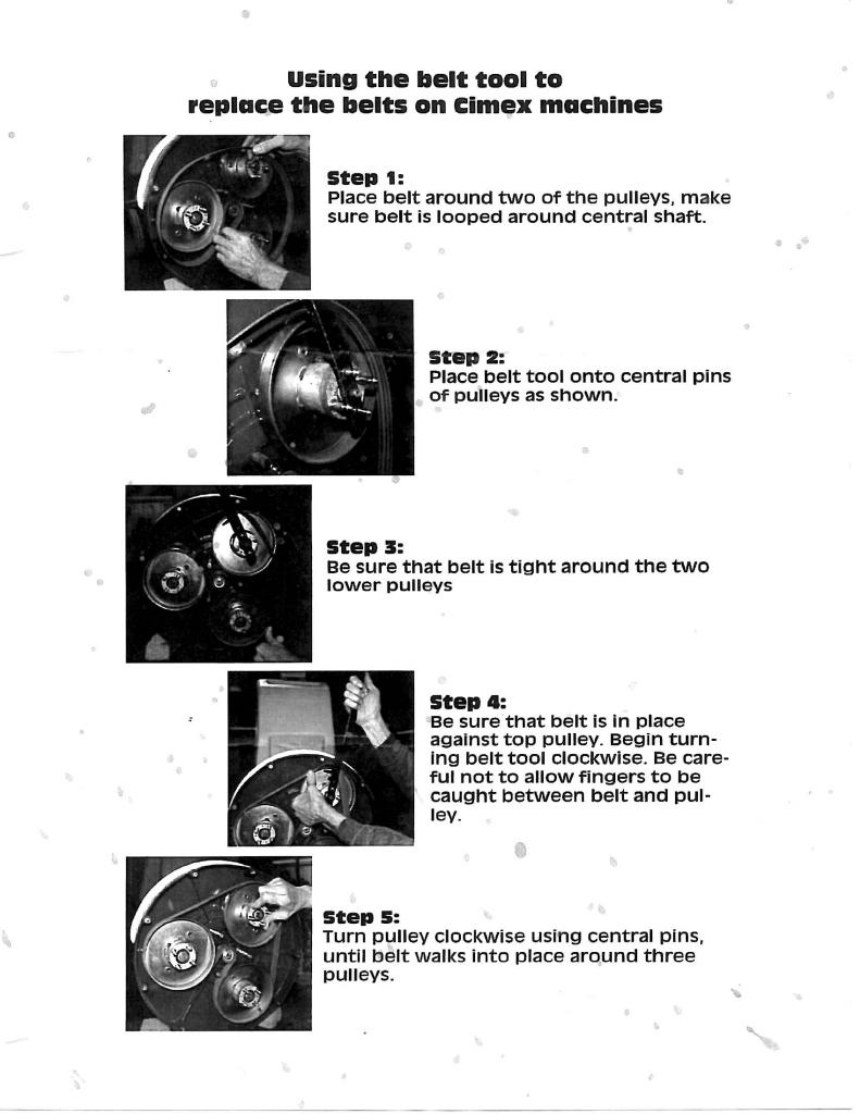

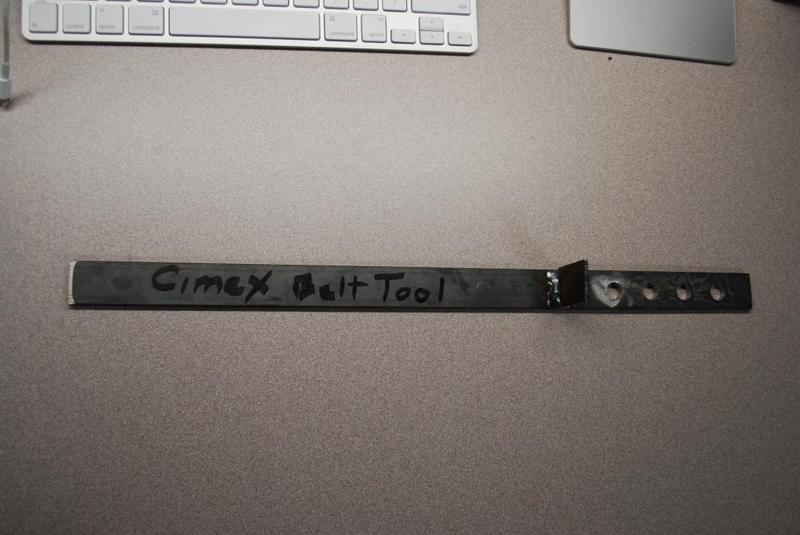

You need one of these:rockon:. I had to replace a bearing in one of the pulleys last week. Makes it much easier and safer.
