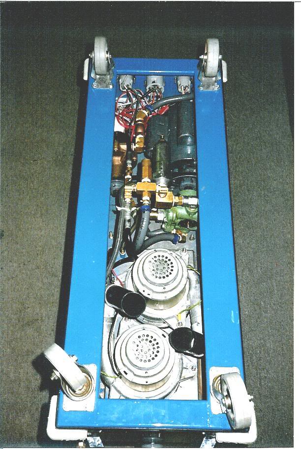

HI Vincent
You can go to the old twin Hypro to a motor like this 1979 unit we made.
LES

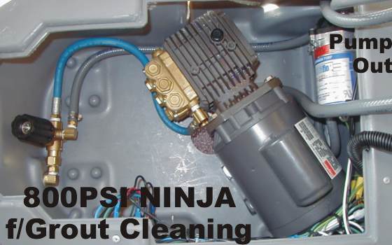

Vincent;
This is a Ninja with a General pump we installed.
It's a more durable plunger pump that delivers 2.2 Gal/minute.
Larry

You could run a water otter like I do but it would use a full power cord. Are you looking for a low amp solution? That general pump looks pretty good from Larry. How many amps is it Larry? Less cords are better a pump and vac on one cord would be ideal hopefully right at 15 amps or less.
G
Greenie
I know MasterBlend abandoned the PumpTec on one of their models either their TruckForce or the new one MasterForce, they are using the HyPro again, apparantly they used this Hypro for many years it was a work horse but took up more space.
I kinda like the General in Larry's pic.
Specs Larry...specs!
