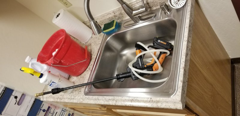

Got the worx sprayer.
What are your tips for using this?
Thanks.

No solvents, use it for all normal chemicals, rinse religiously and if you need more info, PM me.

change the tip out to a T jet...

I prefer a 4.0/40 degree pressure washer tip in place of included tip, you can then rotate the spray/fan any way u want. Shorten the hose to way less then half the included length, it will then prime in just a couple secs. I like it on low speed with short lance for upholstery, on high with the full extension to prespray ahead for bonnet cleaning. Very handy gizmo.

Rinse after every use. I do and have had no issues. I use it quite a bit for QUAT jobs, smaller cleaning jobs, and urine.
