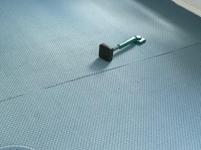

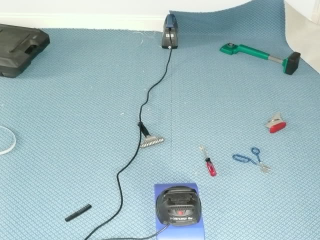

Here is a carpet small pattern. The smaller the pattern the more to line up. This makes it harder for us to do. You will see the runoff. What I did was start in the middle of seam. Stretched both ways to achieve pattern .

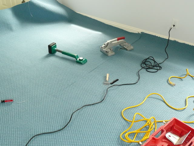

Secondly I take my Kicker and achieve a match. That will be the next picture here is the line up.

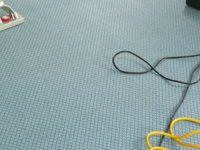

What I did was kicked it up to achieve match. As you could see the rest of the seam is not done. This is how we spot weld it could be anywhere I was lucky enough the pattern was pretty good after I kicked it.

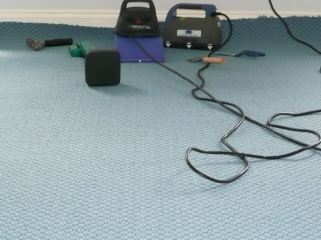

Now I tweak it with the pattern stretcher . I am also where I started the seam.

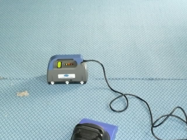

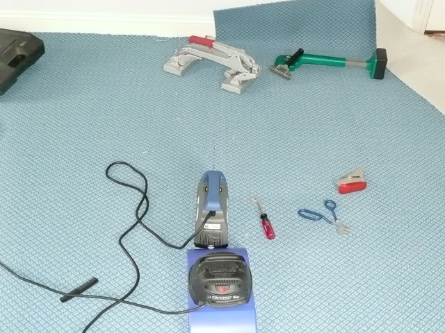

As you could see the seam on this end is done. You see the Kool glide, pattern strecher and Seamer Down Now.

Now off to the other end. Crank my stretcher pattern alligns.

I leave my pattern stretcher in place to hold as I come up with the kool glide.

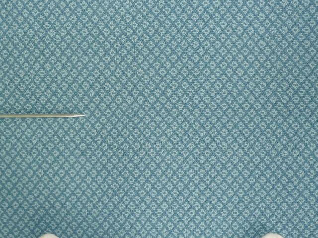

Here is a close up. The seam is where my knitting needle is.

Shorty Glanville
Seamer Down Now.
It cools the carpet very quickly after seaming.
http://www.seamerdown.com/index.html
Did I get it right Harry/Steve :?: :lol:
Ooroo :roll:
PS :::: Harry, bloody top work mate, but we wouldn't expect any less from you :wink:
S
Stevea
Pretty Good Shorty,
It also keeps the seam flat and will pull adhesive into the backing causing a better bonding.
It will also help if you have a wet seam to put together, such as opening a carpet after a water damage job. Sometimes one needs to open the carpet and there is no seam, so you cut the face and open the carpet. Maybe you want to spot weld the carpet to keep it together until you are ready to put in new pad or whatever is needed. With the Kool Glide and SDN you can make a seam with the damp carpet.
The SDN is also good to use for some spotting work. If you have a 'spot' of some sort and you use your spotter and you are concerned with wicking or just want to pull up as much as possible, you can put a towel over the spot and put the SDN over the spot and let it pull the last little residue into the towel by just leaving the SDN on the area while you do something else, (this is to replace the times when you would put a towel over a wicking spot and weight it down). You can also use it to dry out a small area spot by just putting it over the spot and allowing it to dry it out. I have used it this way on several urine spots on sisal, kept it laying flat and dried it out.
It is rather unique in you can put it onto a very wet carpet and it will vacuum the water but not hurt the unit since the vacuums are protected from getting wet.
Pretty neat tool. Yes I know we have water claws and I do also and use them as the principle tool for such work but at times it is nice to had the SDN if I do not have other tools with me and a spot needs to be cared for and I want to have the wicking pulled up into a towel. Just sharing another interesting use for the tool.
Primarily, it is used to cool a seam, keep it flat and pull the adhesive into the backing of the carpet. Great little tool to have and use.

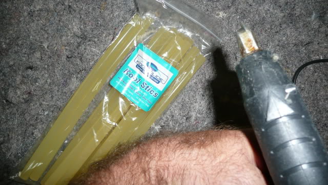

Here is another run off. Spot welding needed. I am showing the kool glide sticks along with the orcon Peak Buster . Sometimes like on friezes or some pile carpet s, I like this tip better. You seal both edges it is neater.
