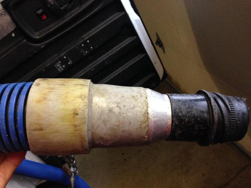

Those aluminium connectors slowly but surely crack and keep falling apart. I have a few from Greenie and I found that I always have to snip off the ends where its cracking and bending (restricting flow). Chems are for sure not helping..
I would do stainless too instead of aluminium.

I haven't seen this yet but I haven't checked out my Y splitter from Greenie on the 2008 unit
Definitely going to take a look at this

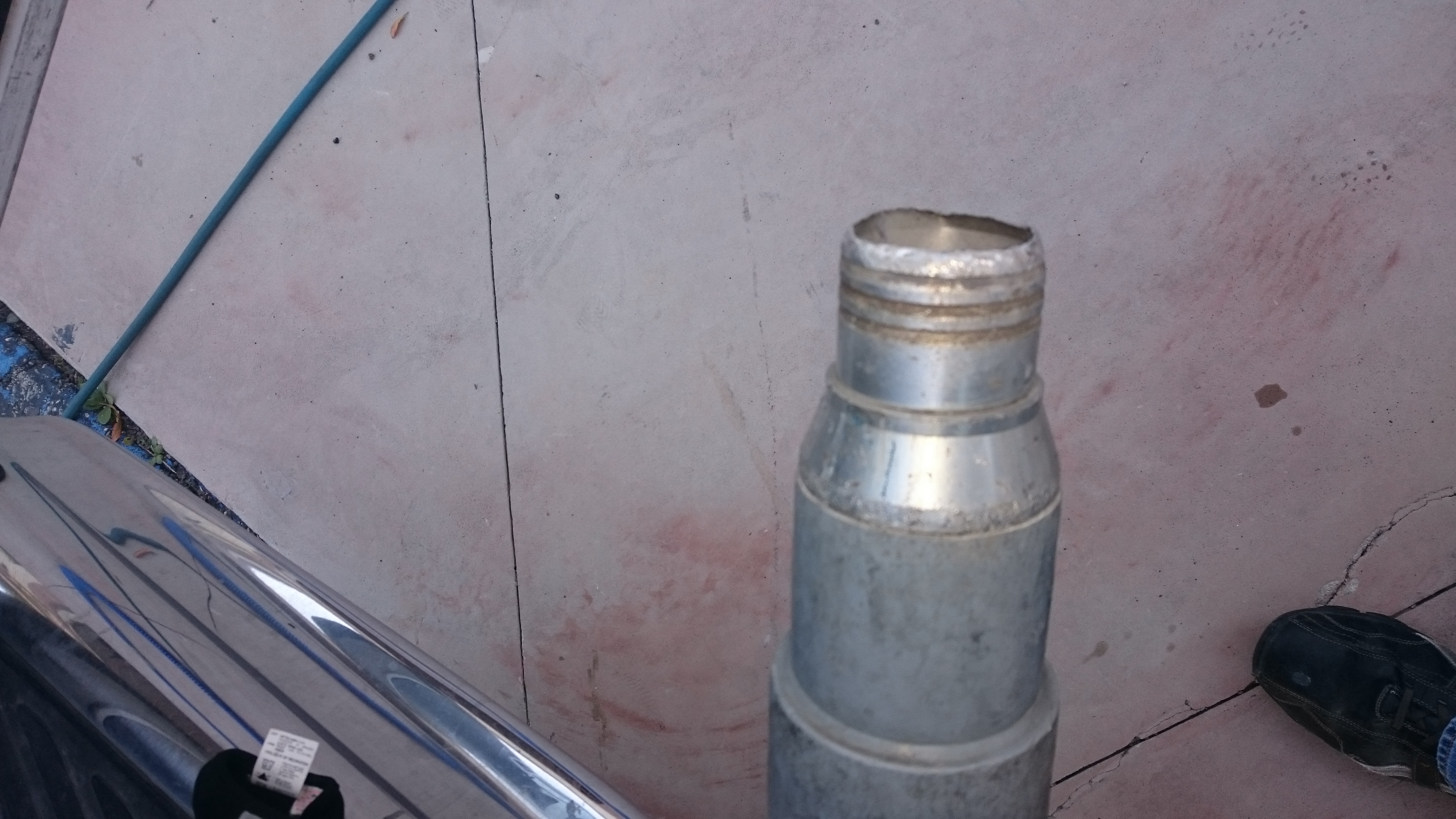

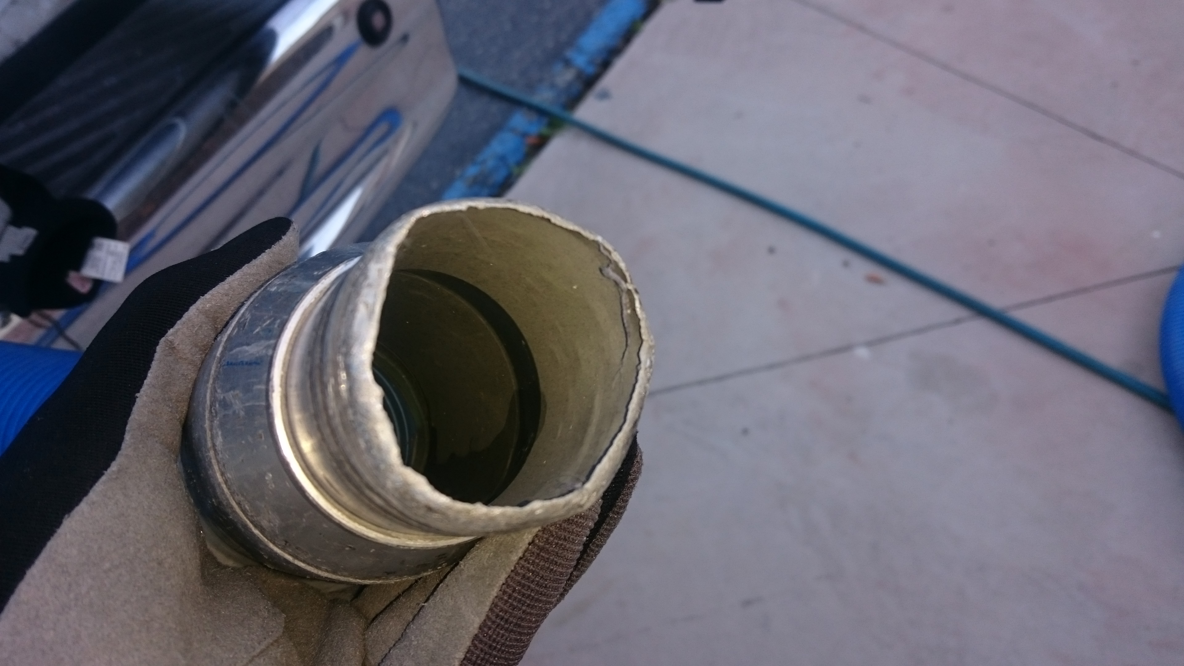

Here it is. Just setting up to a 3000sqft tile grout job right now.
You can see the connector is shorter already as I cut it before. I'm sure the occasional drop to the ground doesn't help...but it definitely cracks and bends. Perhaps the El D has toooo much heat and suction... :lol: :lol:

Interesting! Looks like pretty thin material. I ordered some 16 gauge material, maybe it will last longer?

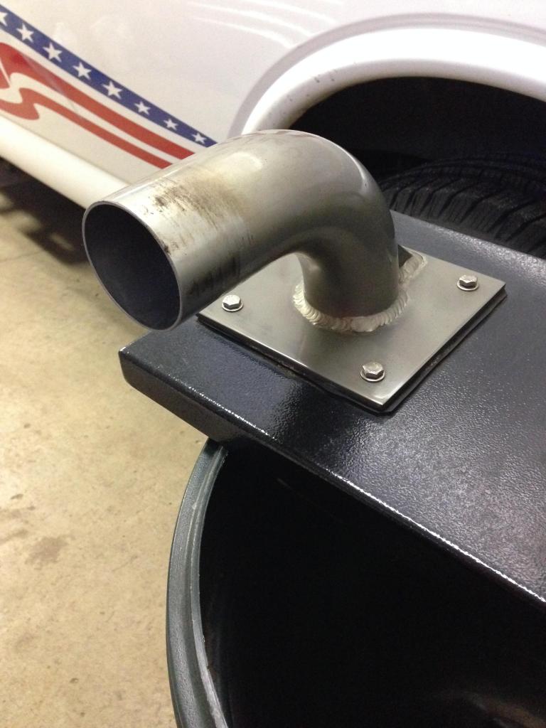

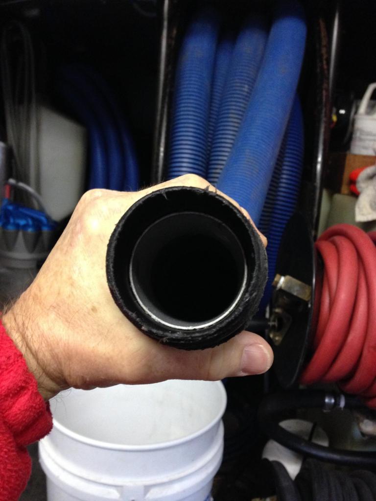

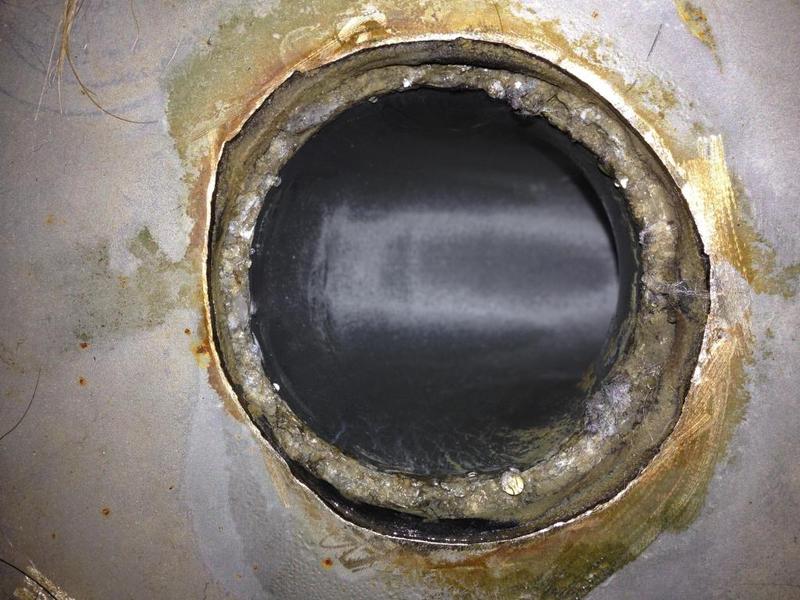

My reducer is protected by the vinyl hose cuff and starter Cool Cuff so it still looks good on the outside.
The inside shows no sign of corrosion.
The anodized elbow is in great shape. A little corrosion on inside weld and some of the anodize finish is wearing off the inside.

I know the hole I made in the lid looks ugly. It's stainless steel and I didn't want to ruin my holes saw so I cut it out with a metal blade and jigsaw.:(

It does the job, that's what's important. Stainless will sure eat holesaws, just ask Bawb. Looks like your tubing is 16 gauge, that's good information!

I measured the tube thickness of the elbow. It is 1.84mm. Is that about same as 16 gauge?
took the calipers to my Greenie fittings
Tank lid elbow (Same/identical as Shane's) is .062"
Couldn't get to the 2.5 to 2 hose connector, but found a straight one (2.5" ) in the parts tub in the garage ...it's a bit thinner at .050"

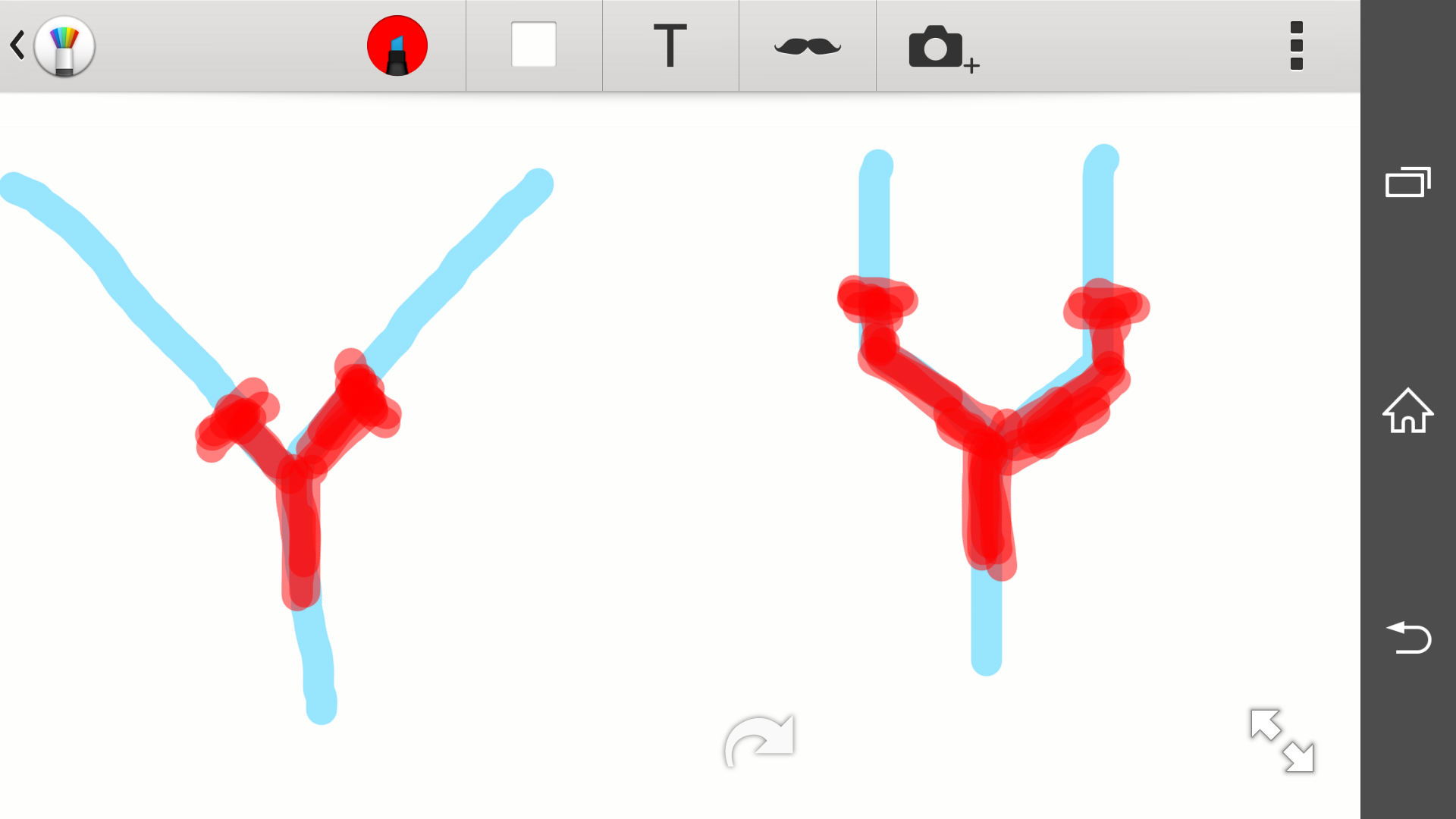

Dan;
We made a few of stainless like this one ;
Only a sales person likes that type of Y connector....Why is it so hard to just make the Y with two parallel parts connecting together? What pictured here is lame: It holds the two hoses away from each other and its harder to keep them laying nice and neat.
Professionally done blue print patent pending trademark filed AK47 protected
