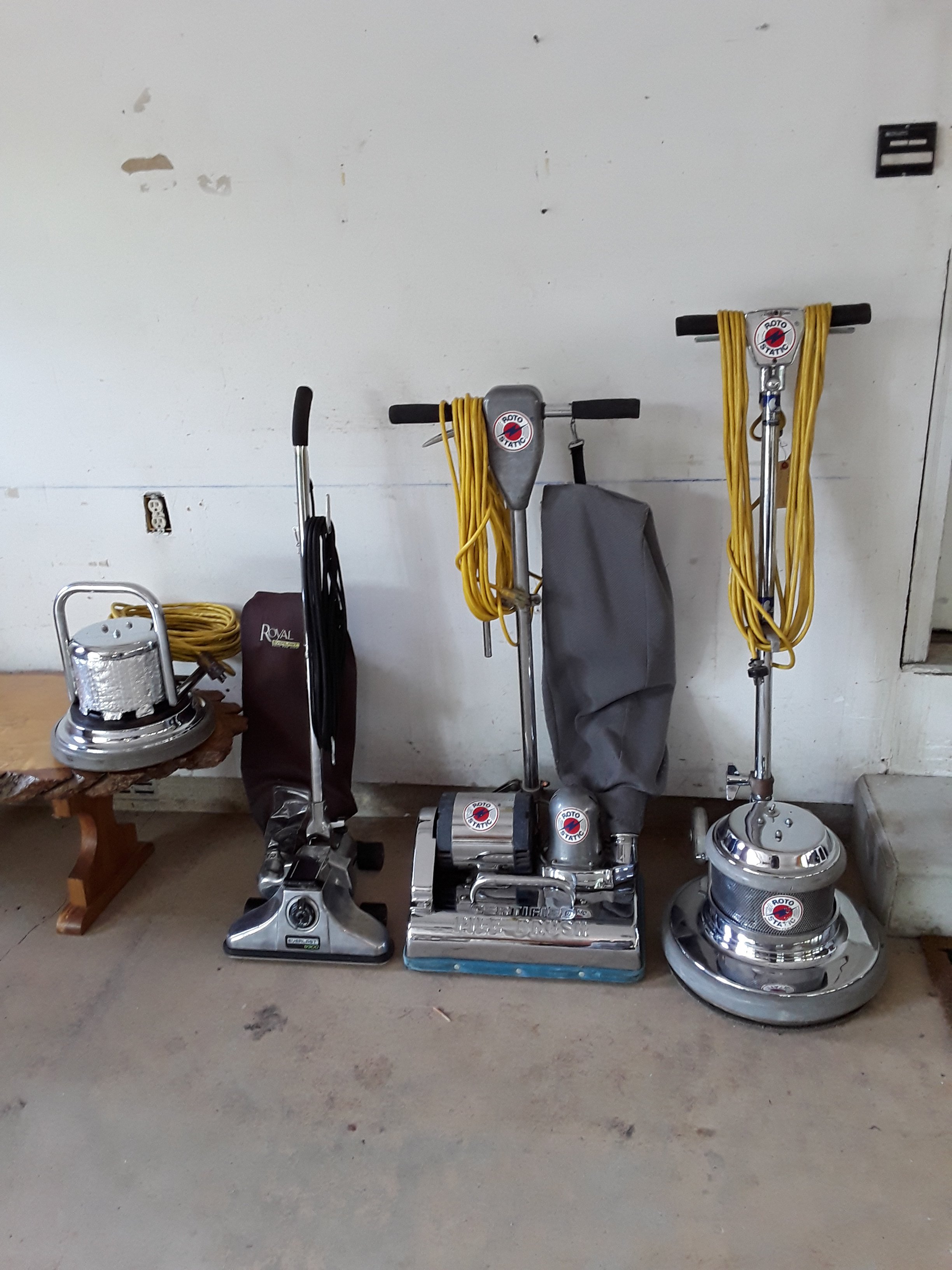

A $100.00 dollar pile lifter is just that usually. I have refurbished a few, and most are seized up from sitting, cloth bags are toast, brushes are flattened, vac motors squeal and chrome can be pitted if it was in a damp environment.
Parts are available and they are an industrial workhorse that don't get respect they deserve. All you patriotic Murcans should be beating the drum for a quality American designed and built machine.
I paid $50 for one that I've used for years. Finally the bearing on the brush have gone. I can buy a new brush assembly with bearings. Certified pile lifter.

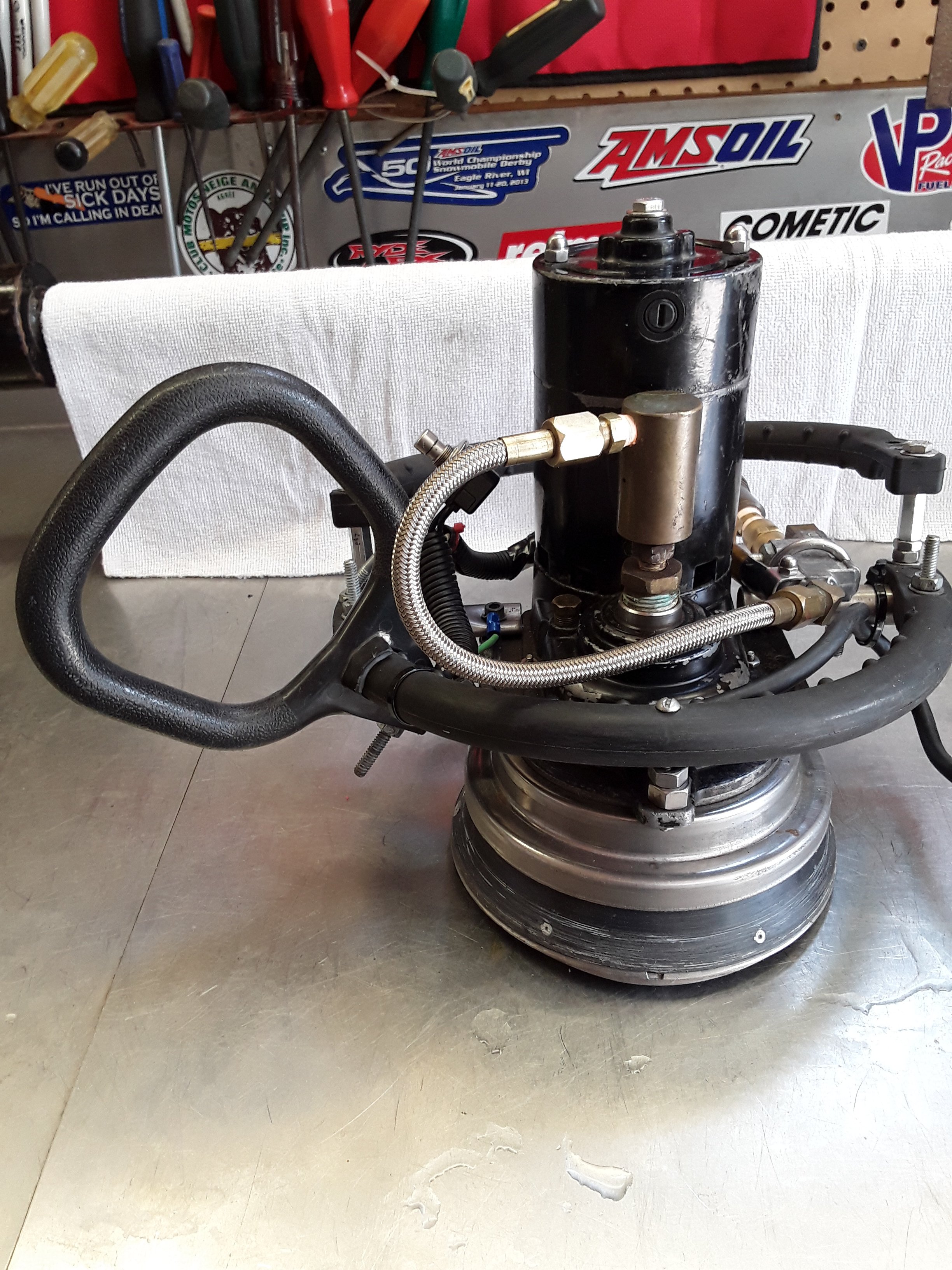

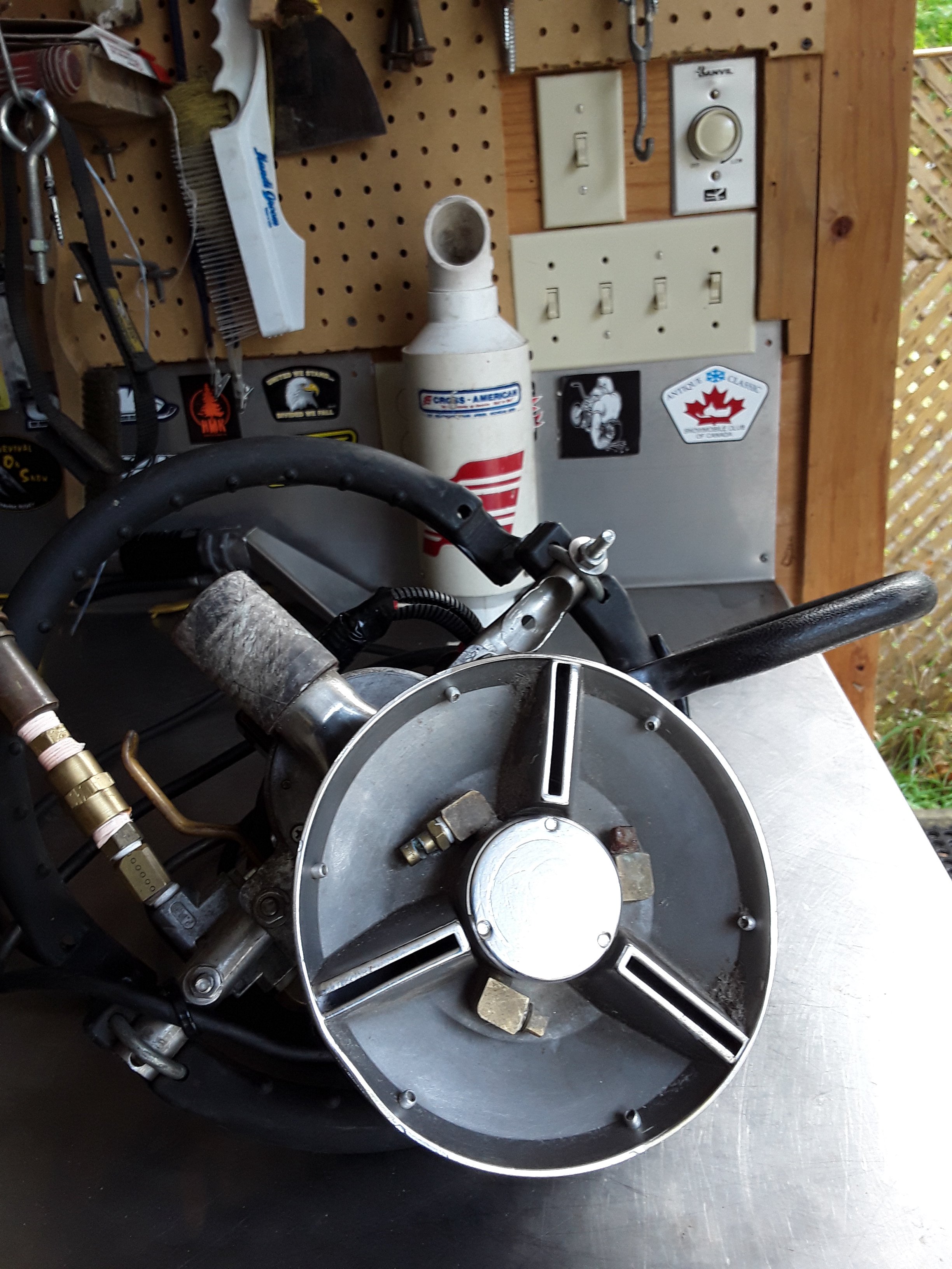

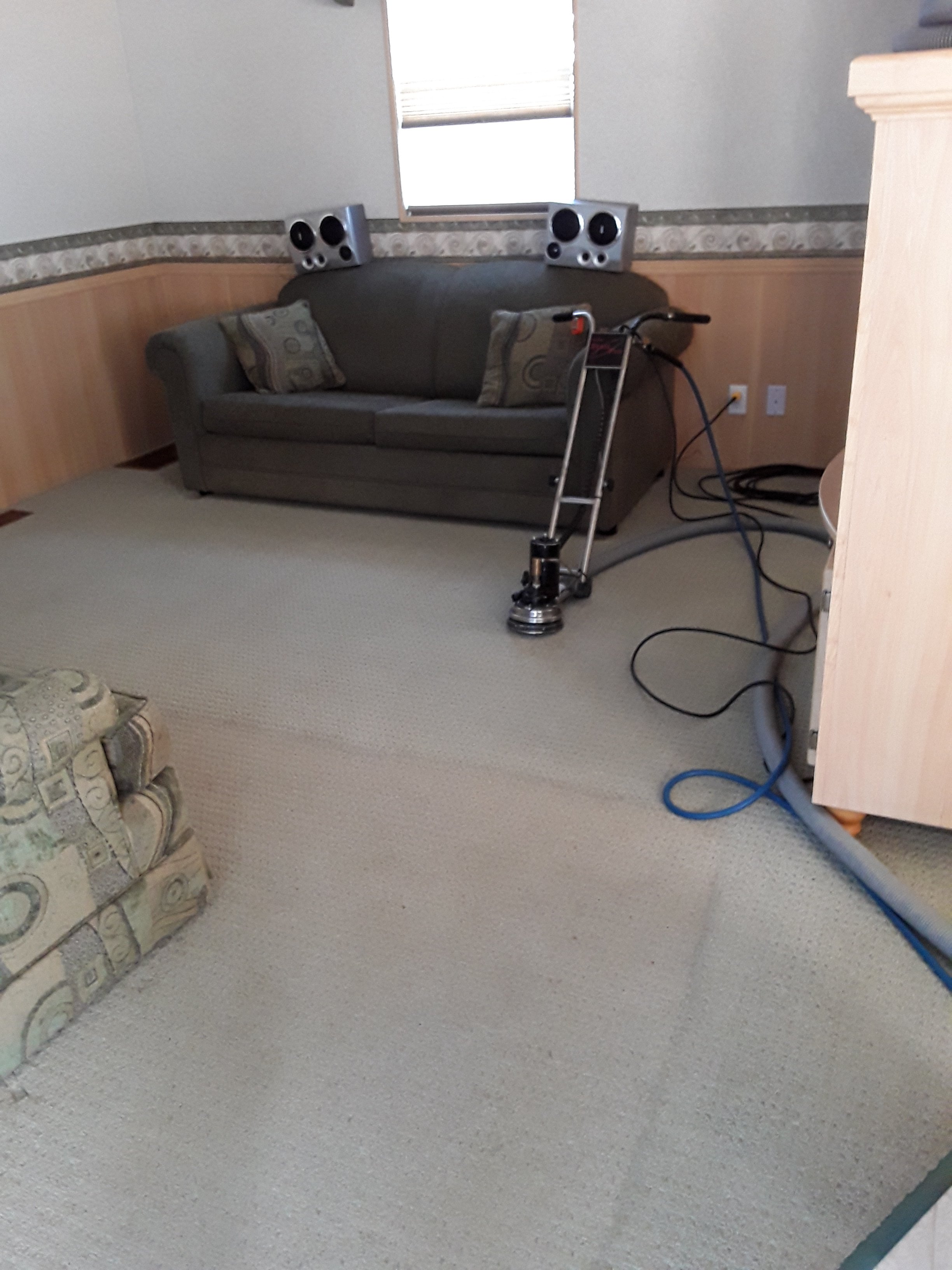

Water pressure can vary in different parts of the towns and cities in my service area, but I barely noticed it when I am hooked from tap to the RVJR. What I did notice was even though I choke down to 1 jet on the unit, I could run the heat out of some water heaters. I run interchangeable heads setup with one jet only in 0.5/1.0 and 1.5 sizes that get swapped out depending on carpet type and severity of soiling.

Yes, I got one back on trade for a refurbed unit last year which I had sold to a property management. They can take a beating. The trade-in even had an idler shaft that the bearing seats to pooched. Somehow the aluminium toothed drive sprocket and keyway managed to move and widen the shaft detent.
