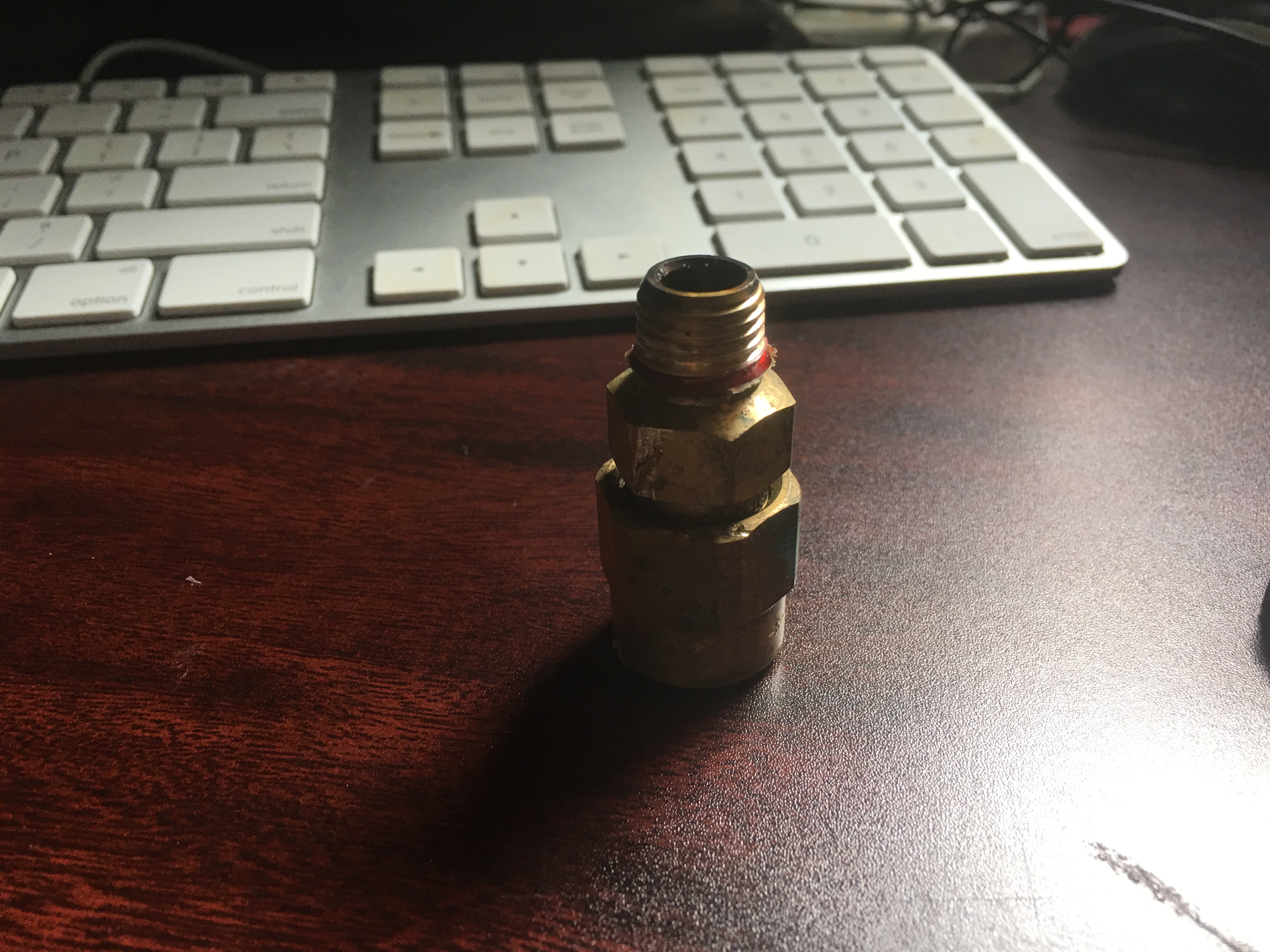

@scottw and whoever makes the one with the coin shaped dial. I'm tired of having to fix the o-rings on the dial, and the HF is always getting out of wack with the spring getting wore out inside. These $200+ sprayers are junk! Even the cheapo ones that are preset at 9:1 are always going bad also. And who put the RED thread lock on the QC on the one with the dial? freaking idiots! Just use thread tape so we can take these things off when needed. I have about ten of these in my shed that I'm using for parts when the new ones break down. Yes, I'm rinsing them out and I'm not using them when my water is scalding hot. Try another excuse

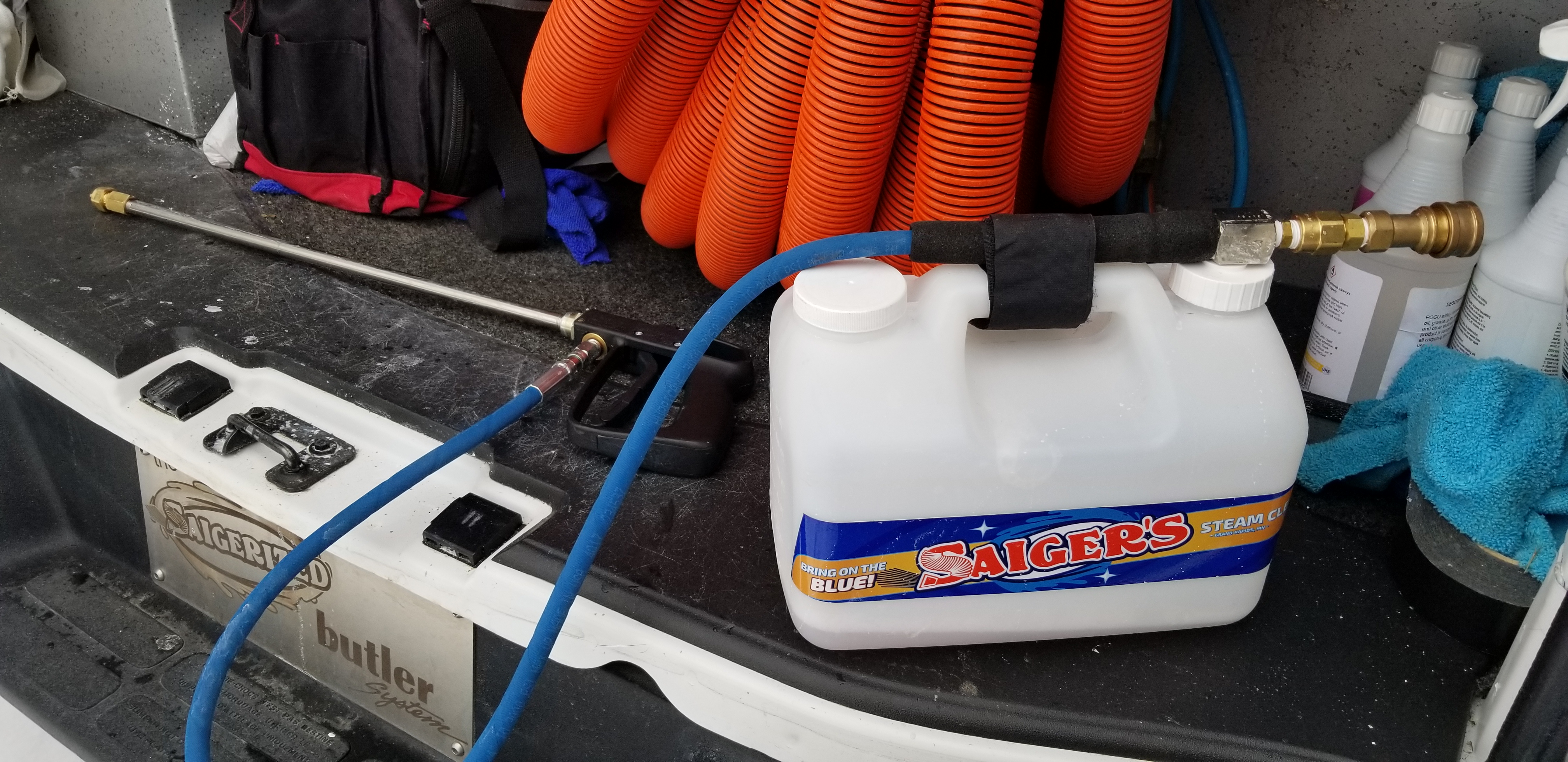

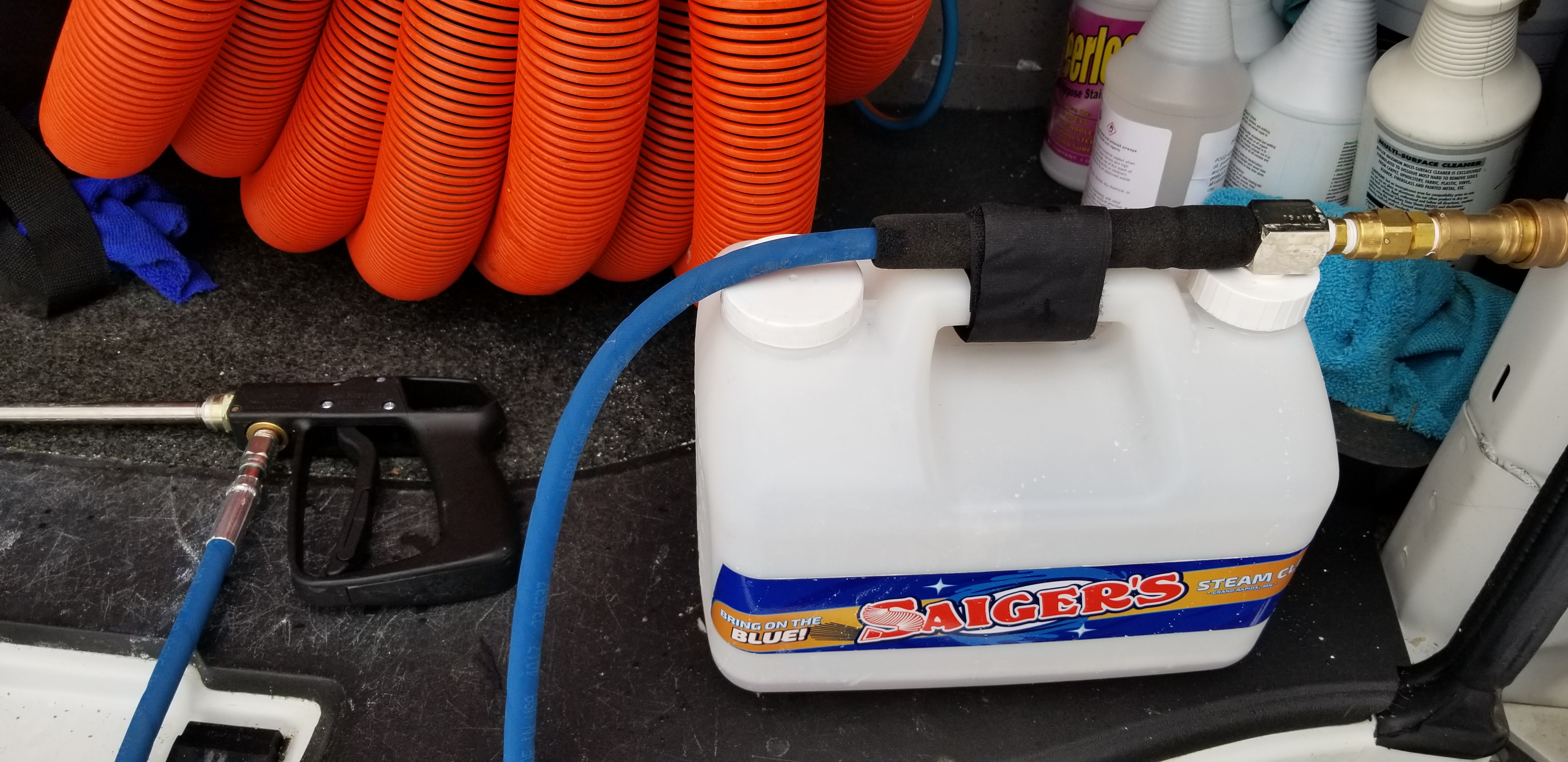

11,200
Mark Saiger
Multi sprayer brand.
Don't get the adjustable version.
Get the one with the yellow Tip in it and take that out.
Get an extra Dema valve and keep in the truck. When it goes bad you will be ready... Then order another Dema valve to have in your truck repair kit (like about every three years)
JonDon has the Multi Sprayer private labeled as Powerforce II
I am now using their new six quart version. Not sure if JonDon has on their website but a cool new feature taking out the hard inline brass tube.
Keep in mind there is a filter coming into the Multi Sprayer brand high pressure sprayer and also another filter at the end of the wand by the jet.
https://www.jondon.com/powerforce-ii-sprayer-250-1-000-psi.html

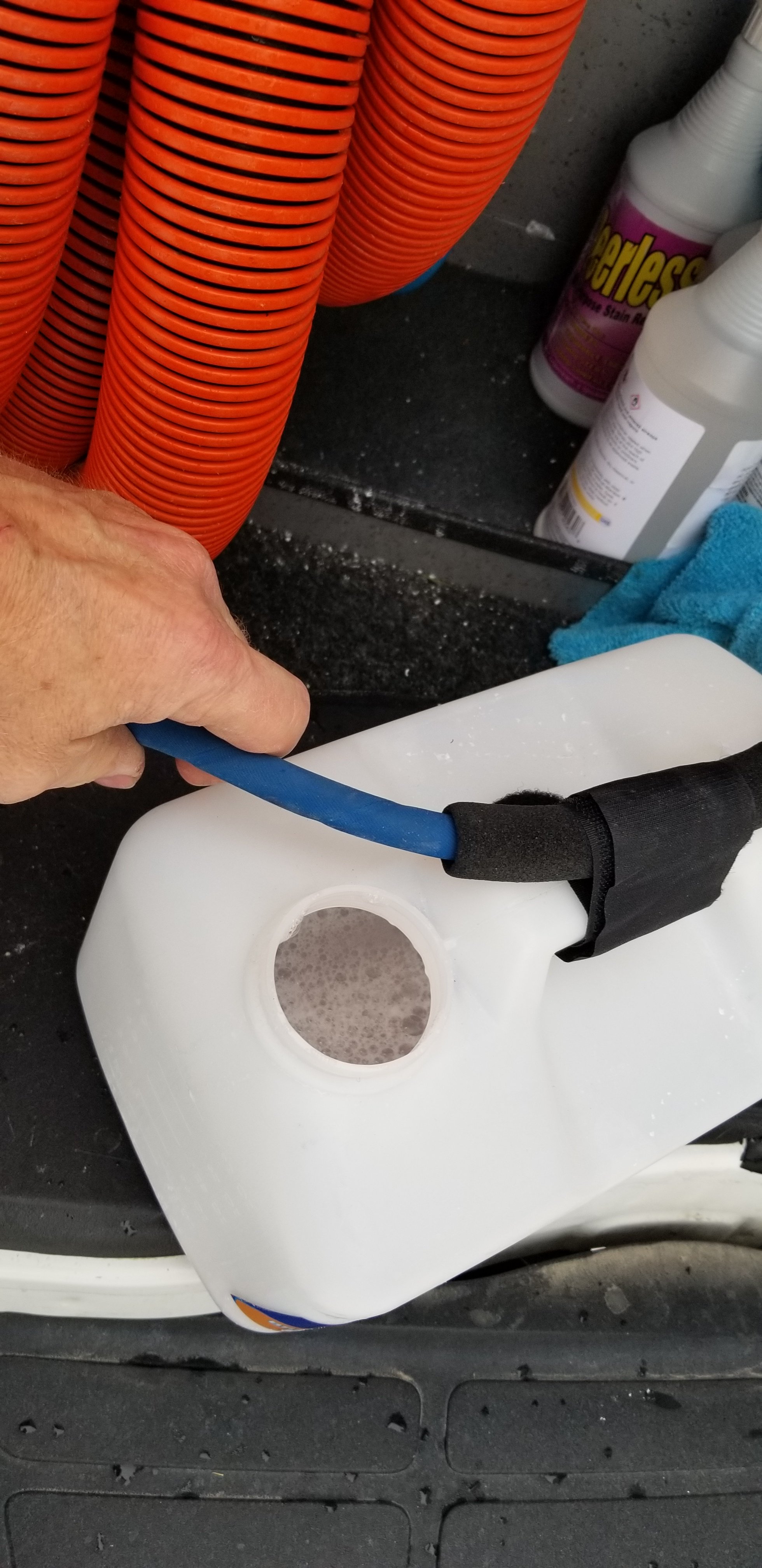

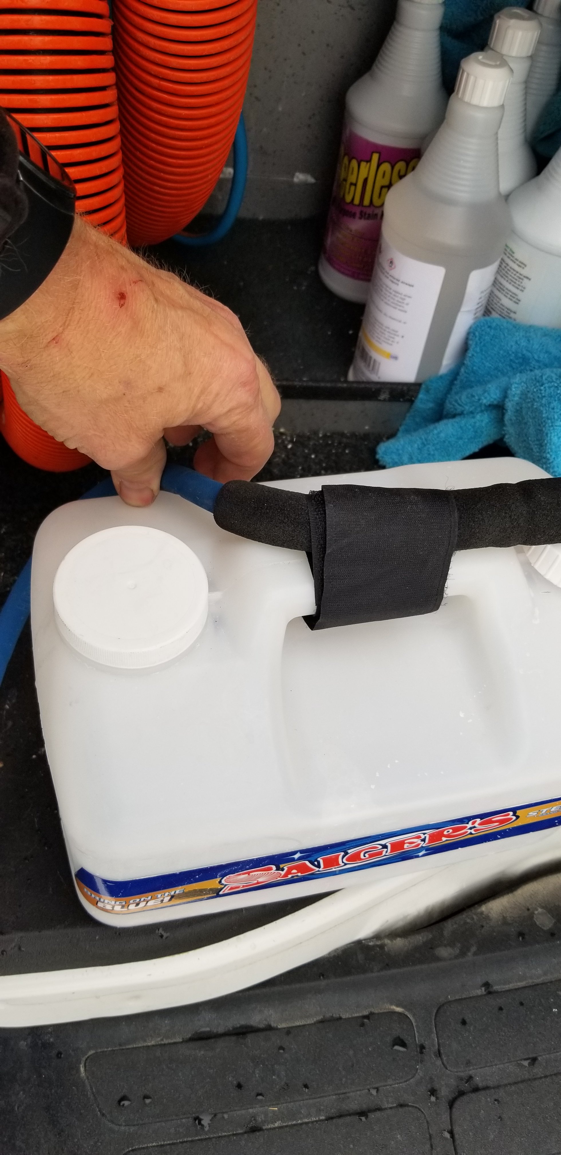

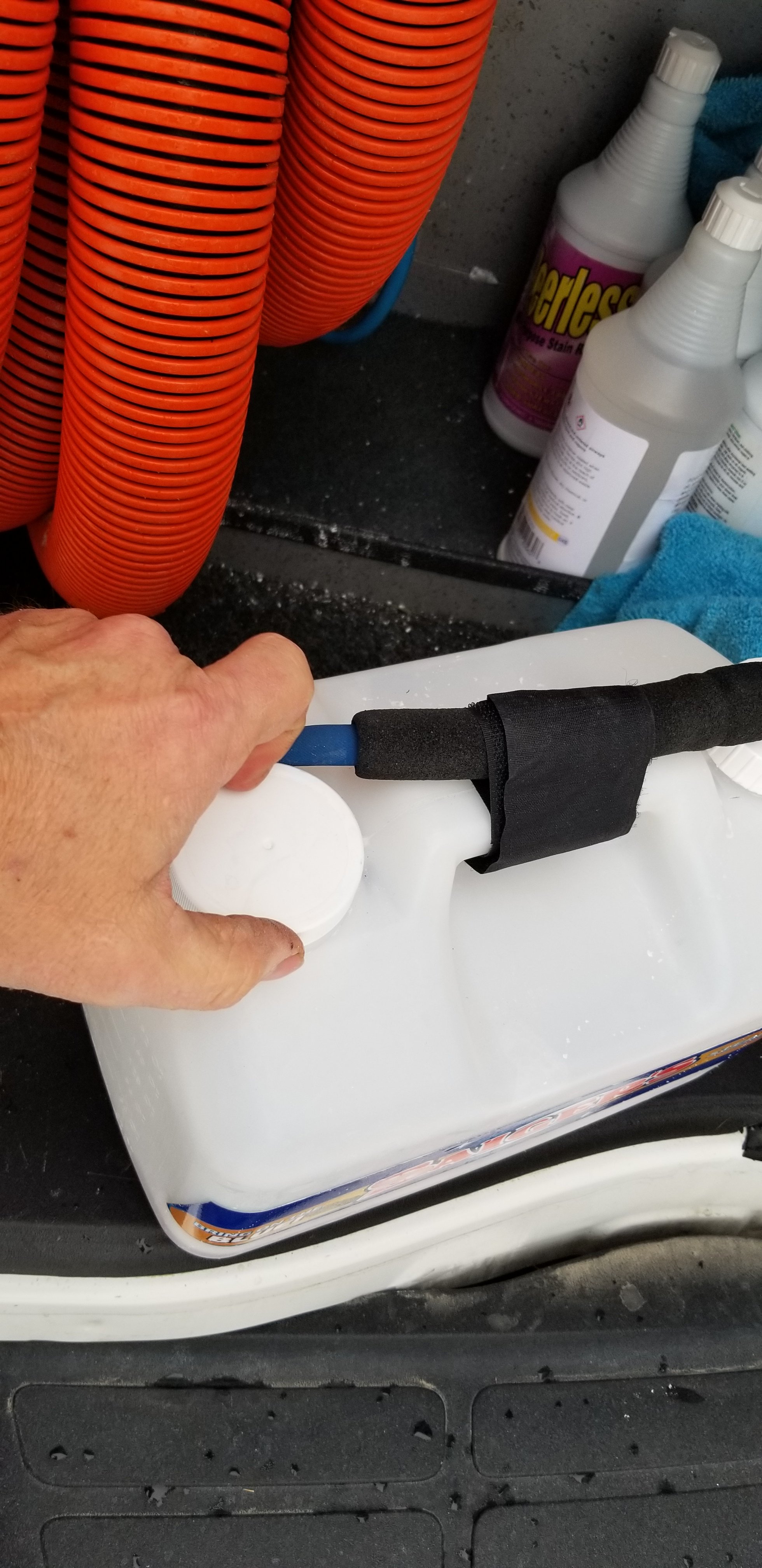

20181108_131949.jpg 20181108_131942.jpg 20181108_131938.jpg 20181108_131926.jpg 20181108_132009.jpg
