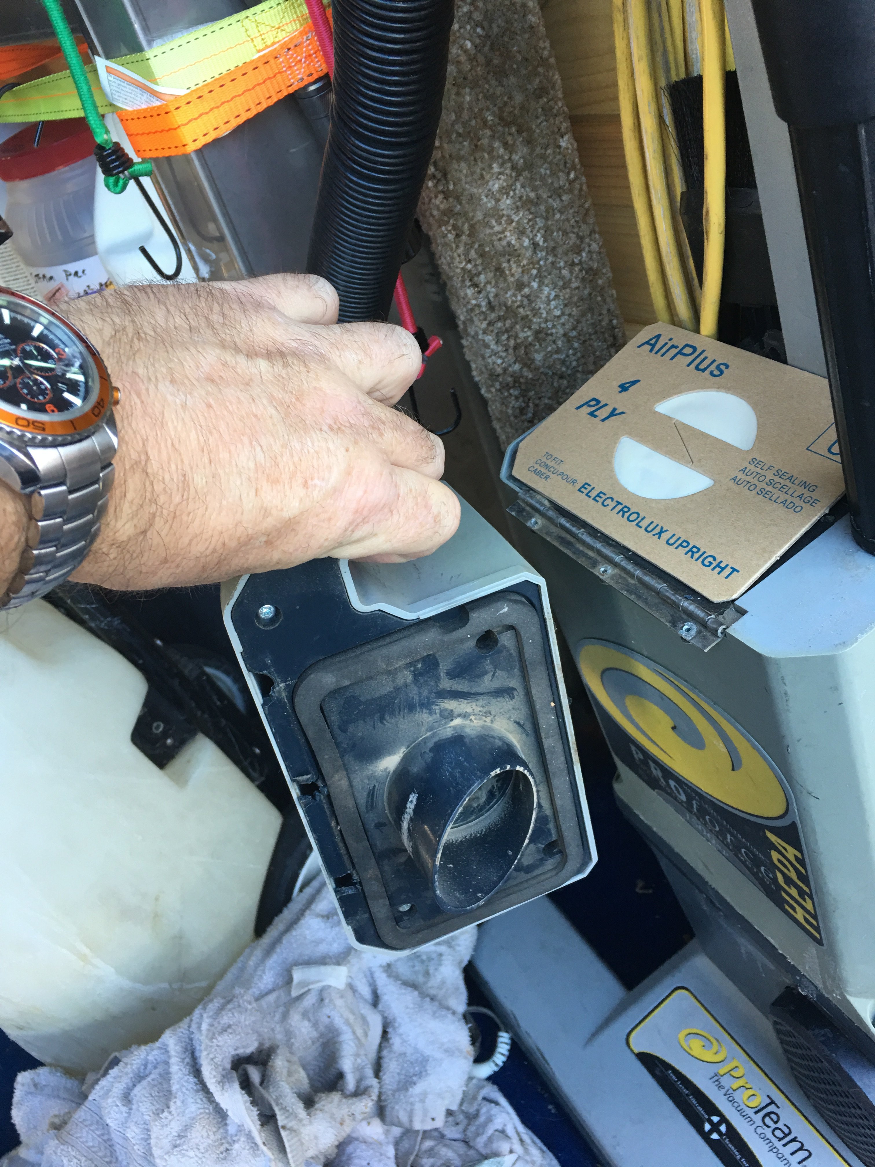

Mine isn’t. Damn it!!!!!

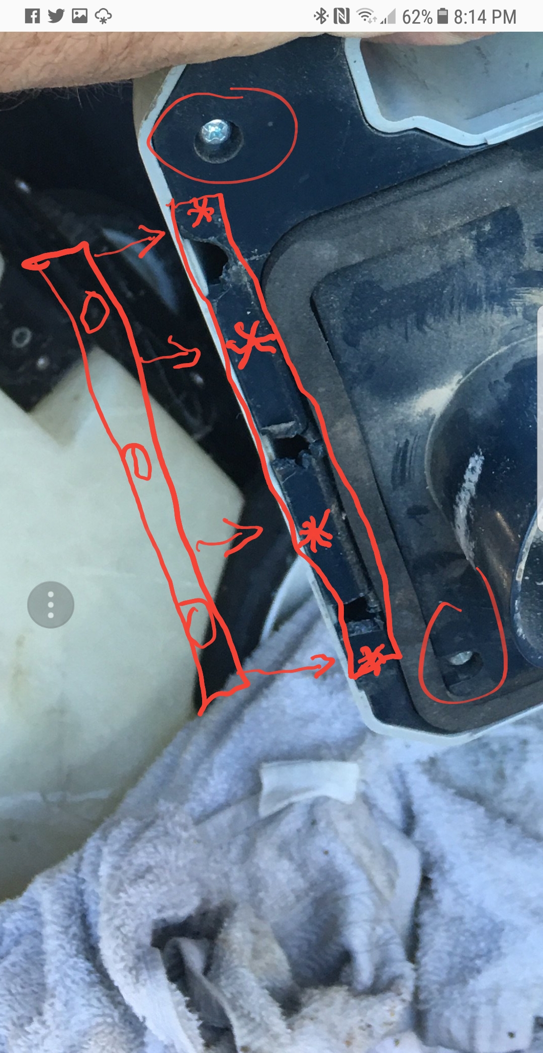

Go to the hardware store and get a piece of aluminum flat metal.
Take those Phillips screws out of the top.
Slip aluminum under the bottom side and even consider pop rivets to hold new strap on back side for support
Now mount the hinge pop rivets (new ones) to the metal where busted out.
You should be able to make that work for a few bucks and don't have to wait for replacement parts
24,146
Mark, Thank you for your image you made. Yeah, I guess I could just re-drill the holes and move them over a bit. But i'll just replace it. But, thanks for the idea.

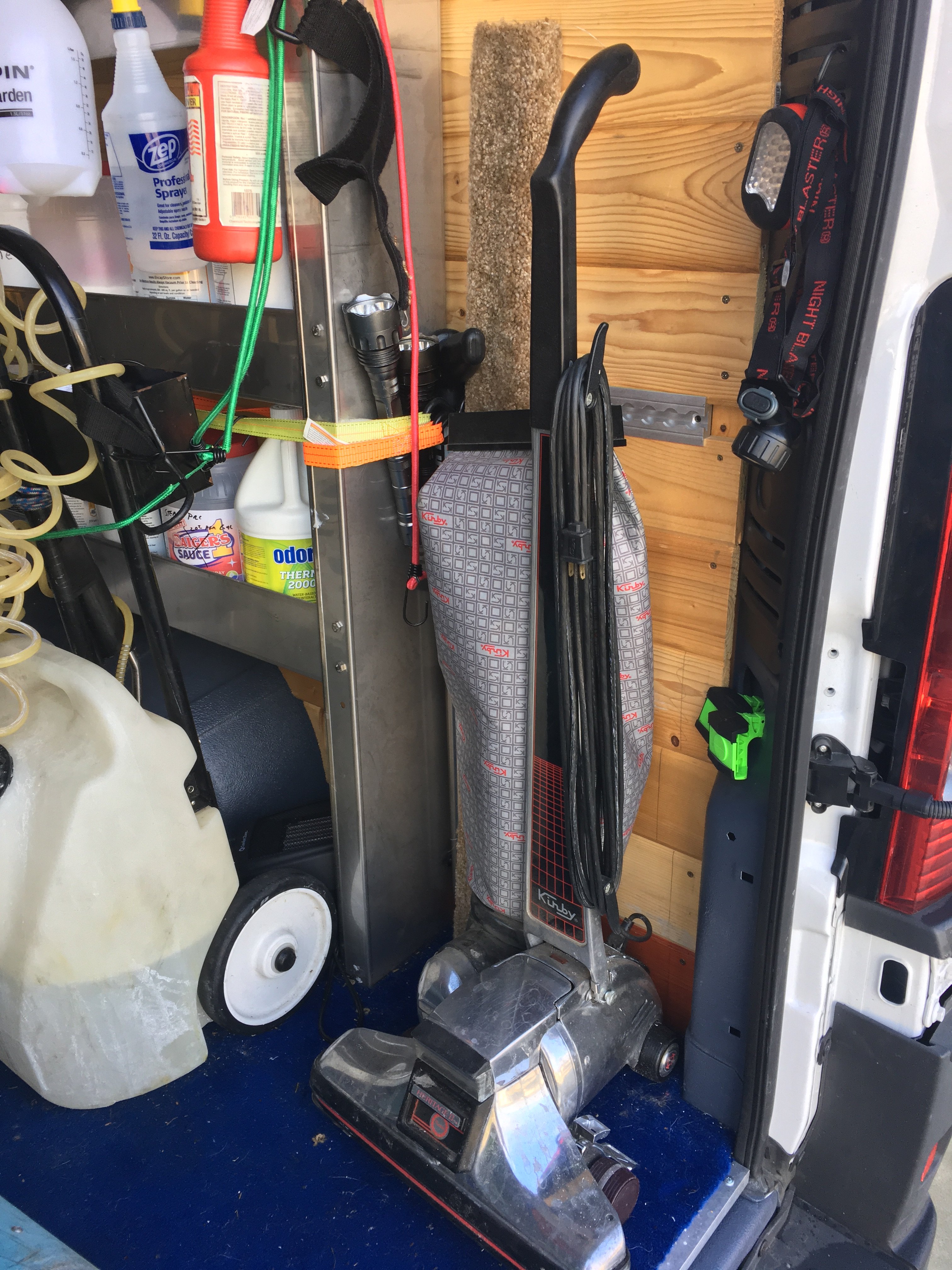

I had to throw the backup Kirby on the van until my parts arrive for the ProTeam. I hate not having an edger!

Damon have you ever noticed how the pile seems totally unaffected by the brush roll on that piece of crap?
24,146
I think it works good. Pulls up the solids happily. The Oreck beater bar is superior and I love the large bag, but it will also give you a workout pushing against the nap. We love our Oreck in our house. The Kirby is also good but it’s just so heavy and no edger. My Dysons don’t last and are a bitch to fix when they break. My ProTeam seems to be an acceptable compromise.

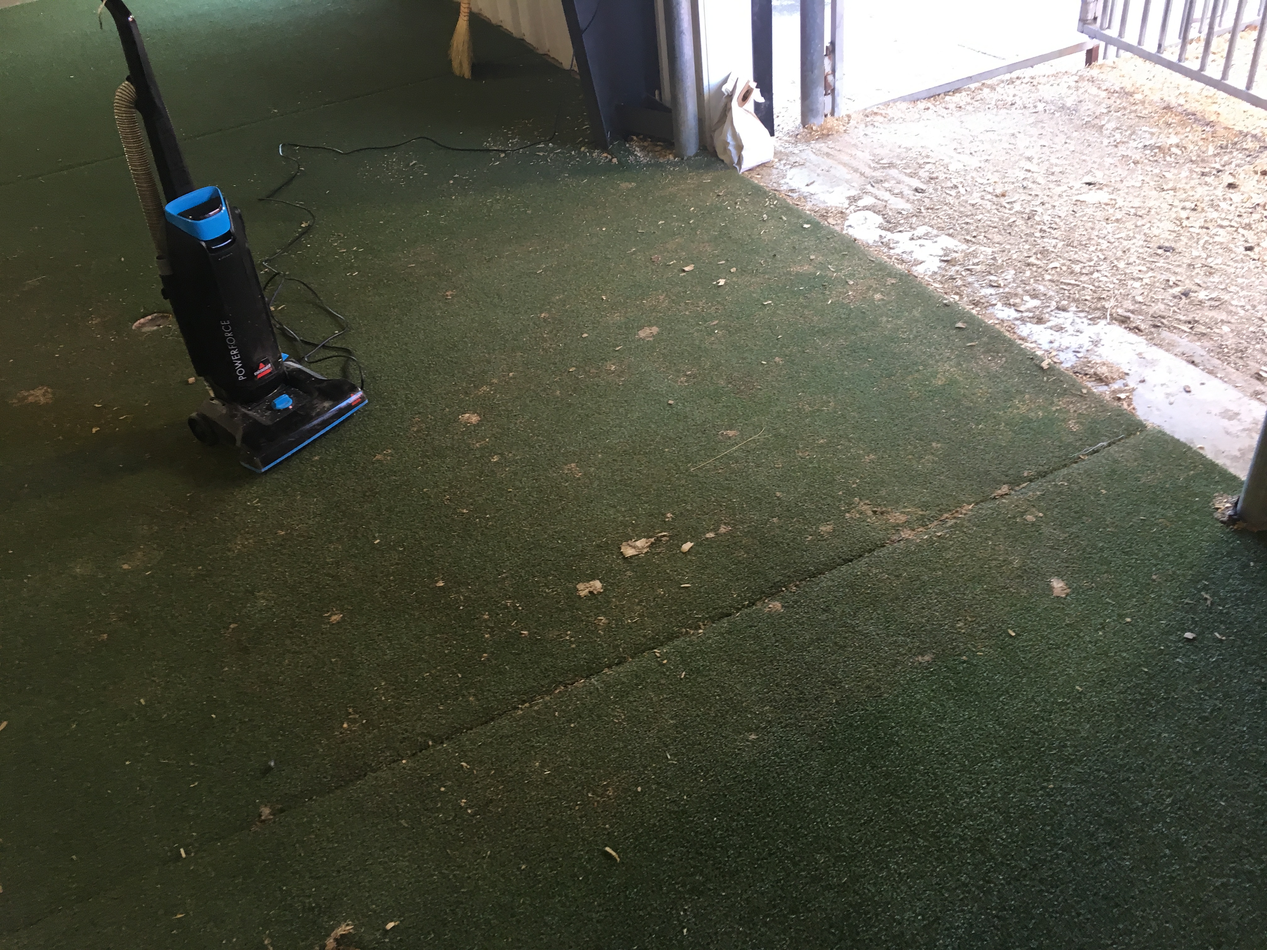

I hate that VAC. It sucks. :winky:
I tried taking a little advice from a couple old guys on here, saying that the cheap vacuums do just as good of a job.
did I mention that my Royal was in the background just screaming away at sucking up all the stuck on pig poo and wood chips like it was candy? No? Oh yeah. MY ROYAL WAS IN THE BACKGROUND JUST SCREAMING AWAY AT SUCKING UP ALL THE STUCK ON PIG POO AND WOOD CHIPS LIKE IT WAS CANDY!!!!!
SCREW THE CHEAPO VACUUMS
By the way...that Orek would've got clogged up in that little 1-1.25" channel of tubing in no time on this job
