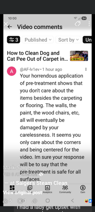

Is this review of Saigers "wrong"
117,345

Did they apply the pre-treatment to the walls and chairs? Was it careless?

Hypocrite for certain. If they cared so much about their own furnishings, the animal would’ve never lifted their leg on the carpet or furniture. People care more about their animals today than they do their own self respect.
But it was probably just another carpet cleaner envious and jealous of Mark’s success which needs to be addressed publicly
Edit: oops. I see that it’s a video comment and not an actual review. I still agree with my statement though.
