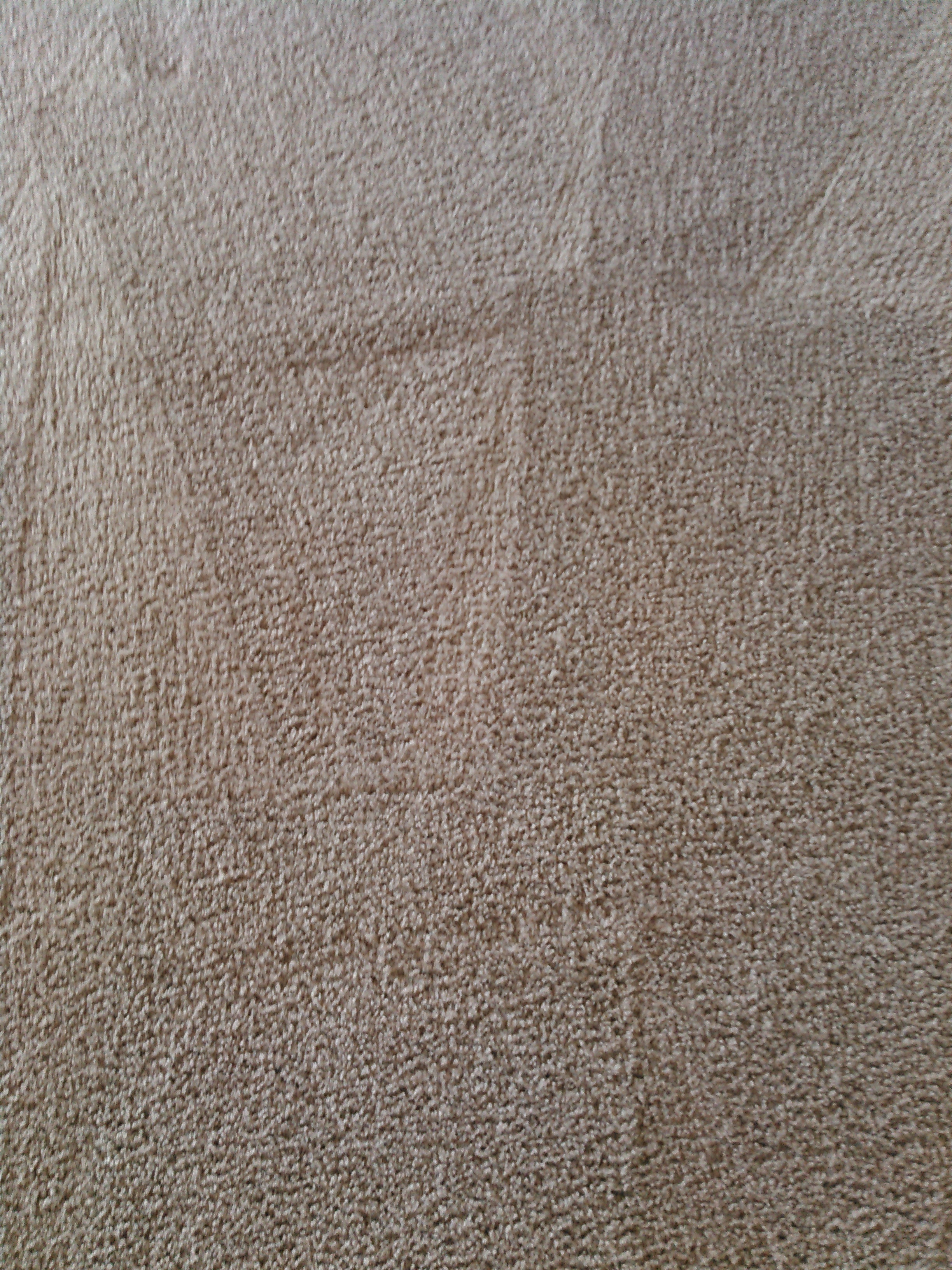

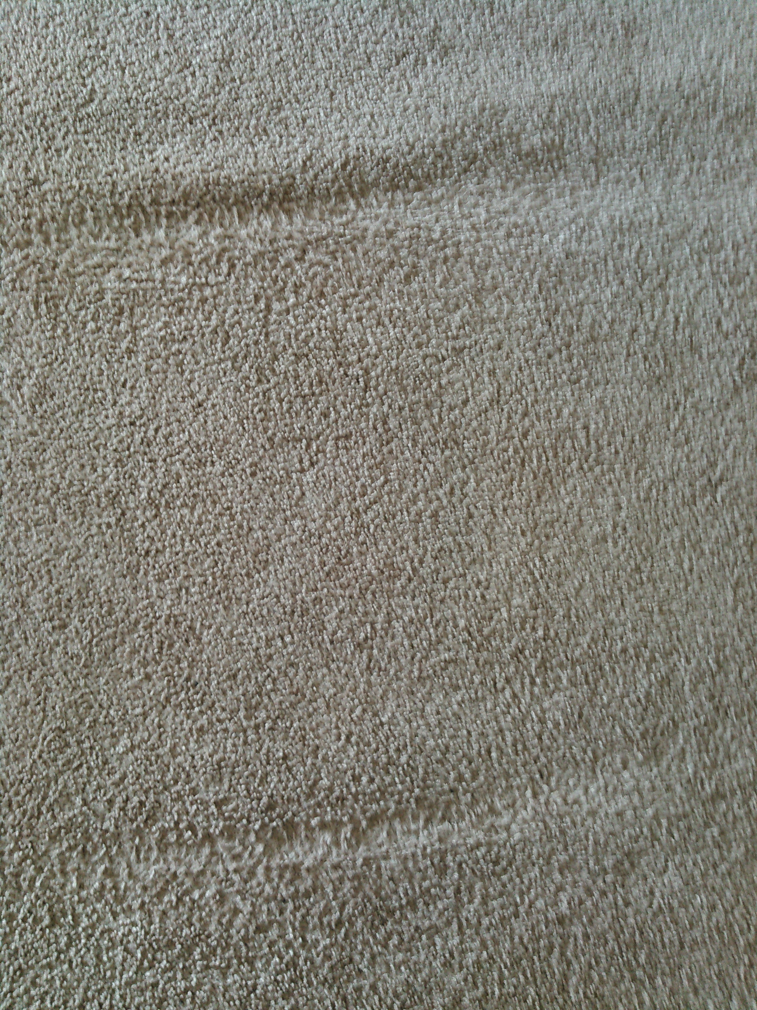

My 15 has become bouncy any ideas on how to correct that?
I tried flipping the brushes but it didn't help. It kicked Gennys but last night at a drs office she's still sleeping lol.

One or both of your brushes have a flat spot because you didnt use uour tray.
Soak them in a bucket of HOT water for an hour
I use the tray but it has slipped out a few times where it's not locked down. Just the strap holding it in place.
I'll try that today. Thanks Mike.

I got them soaking now. Don't see any visual damage but put the white brushes on and it it doesn't do it so it must be the brushes.
