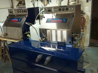

they are coiled real tight together.....
and vibrate against each other till finally....a hole! i used to open up one end put some air pressur through it...if yor lucky you can get someone to tig a small hole shut.....OR you can buy the appropriate amount of stainless tube and bend it around a mandrel to to proper shape.........OR you could jus BUY a replacment from the manufacture.....
THIS is the best machine ever made its called a STEAM GENIE and it was indestructible......stopped selling them back about 7 years ago when i retired

Love the look of that machine Bob. Did you guys make slide ins too. We used to have a carpet cleaner in New Westminster called Steam Genie, did you ever sell any to Canadians?

i loved 'em too...damn things would last forever........
i sold eight or nine right here under Mikeys nose.......:clap:
I thought Willy and all the other Canucks were porty people
no slide ins...thats blasphemy!

I've got to slide ins, none half as good as a steam genie. If I get the diesel heater working on the latest one, at least it will be hot. still about 2 weeks away.
