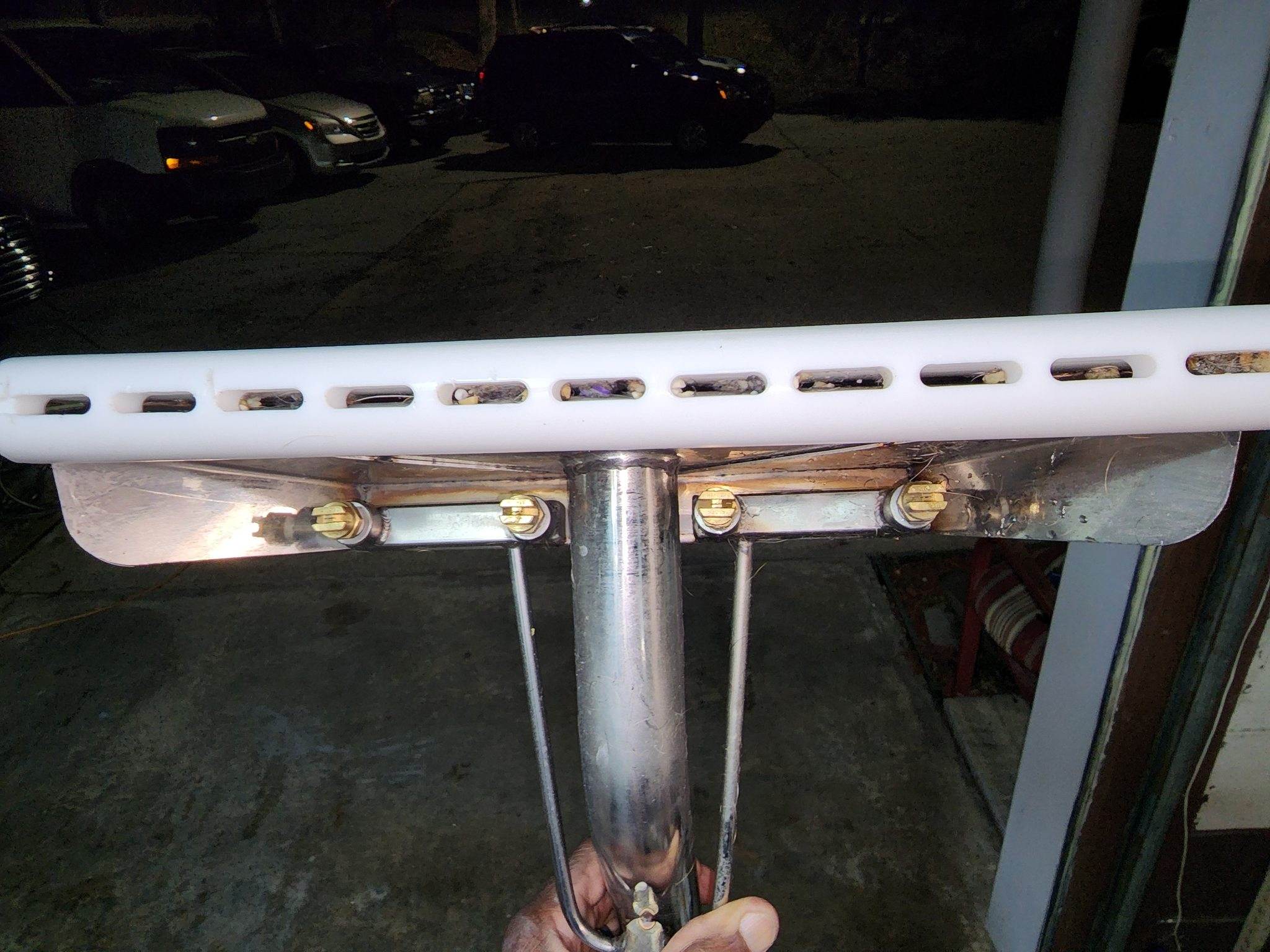

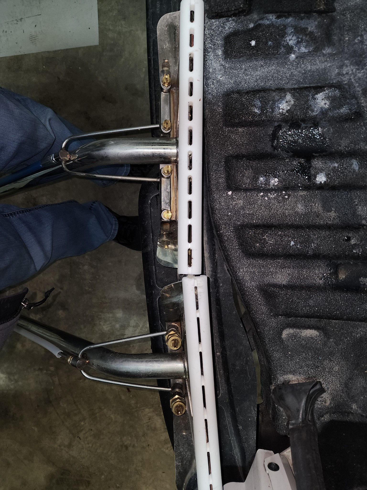

I personally do not like the hybrid because of the lines they leave, the hole glide does not dig in to some carpet like the slot glide. just my opinion.
116,116
I haven't used a large hole glide option so excuse my questions, but doesn't it leave lines as well? They're just more consistent rather than the dot dash dot dash?
Trip Moses
IMOL
Sep 19, 2018
3,624
Savannah GA
Trip Moses
These hybrid glides bite just as hard as the slots. There is also better water recovery. My APO seems to be running more than with the slots. Dry times at my house were dramatically faster. I’m not wild about the lines but it’s not a dealbreaker. I may go holes next time.
