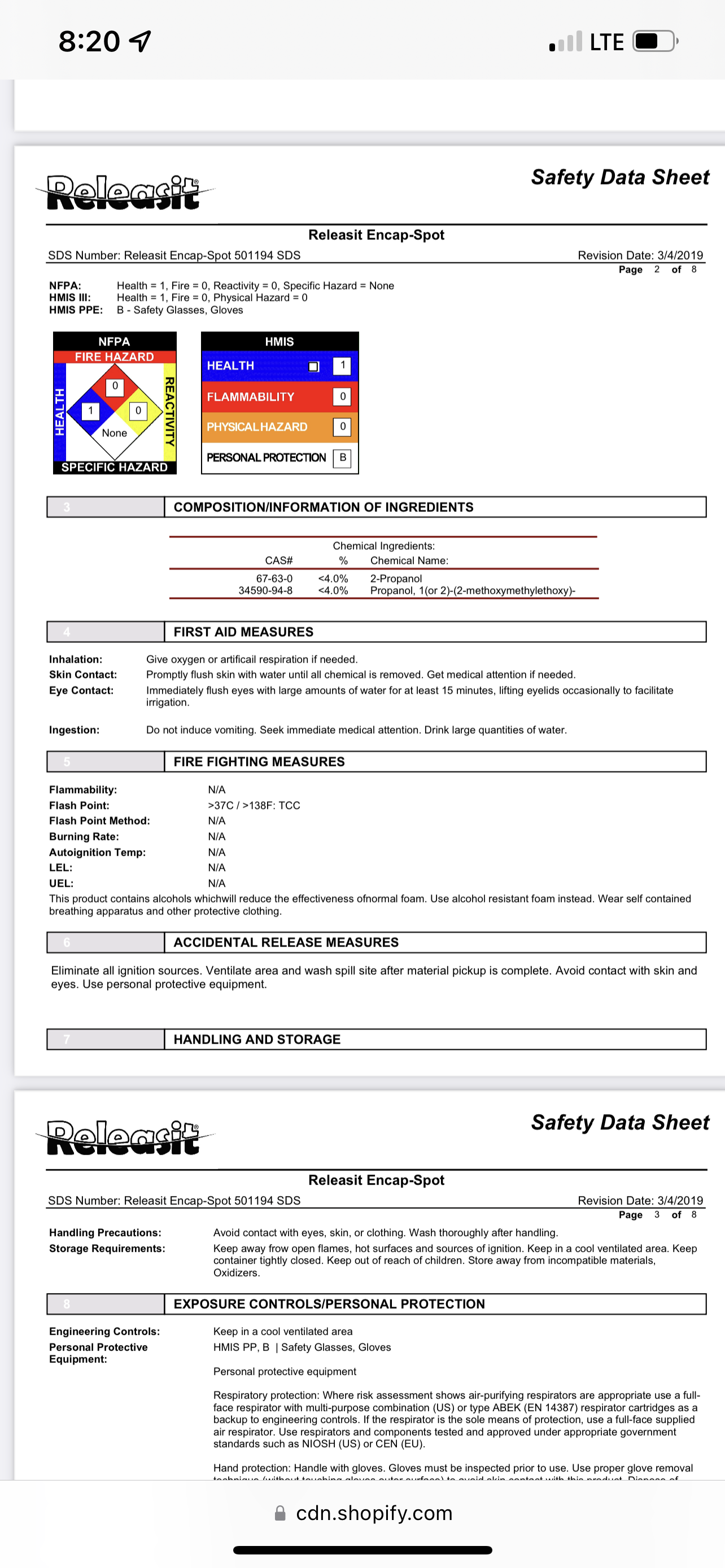

Encap-Spot will also take out a lot of ink spots.
Isopropyl Alcohol

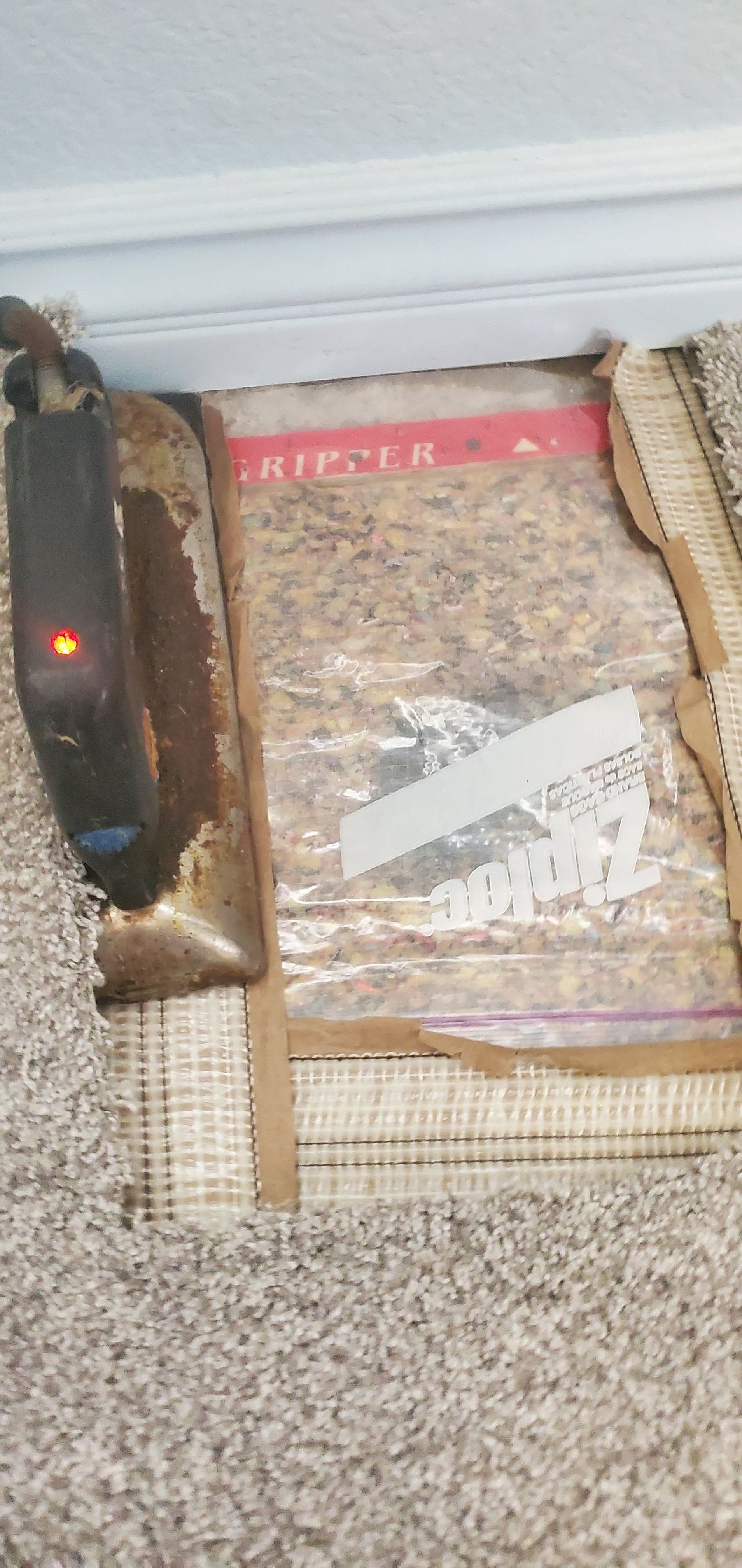

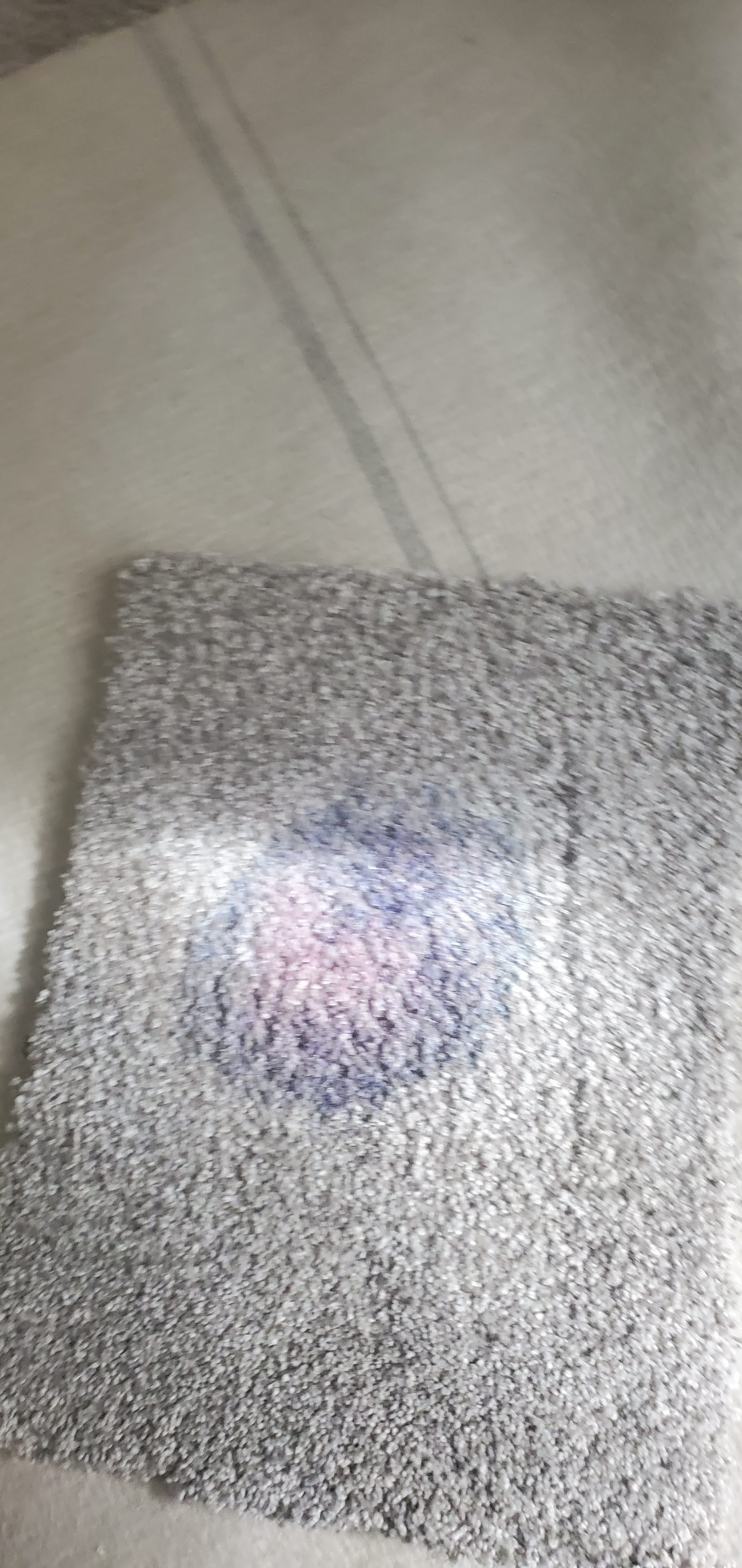

11,577
Seriously not all ink is created equal, just cause you got lucky on a sofa and thought you were a hero.
I had a small drop in carpet explode ended up patching it.
You can see the size of the ink spot in the pad.
  • 20220330_165325.heic
28,285
View attachment 115320 View attachment 115321
That's why you want to use a gelled product. In a pinch you can use hand sanitizer with a 70 percent or greater alcohol content. Doesn't work on all inks.
11,577
Power gel stain 1 and pro solve liquid.
The smallest pinhead exploded.
Wasn't a ball point ink either.
I've never had luck with ink exit.
A cuff and hand sanitizer has worked. lol
