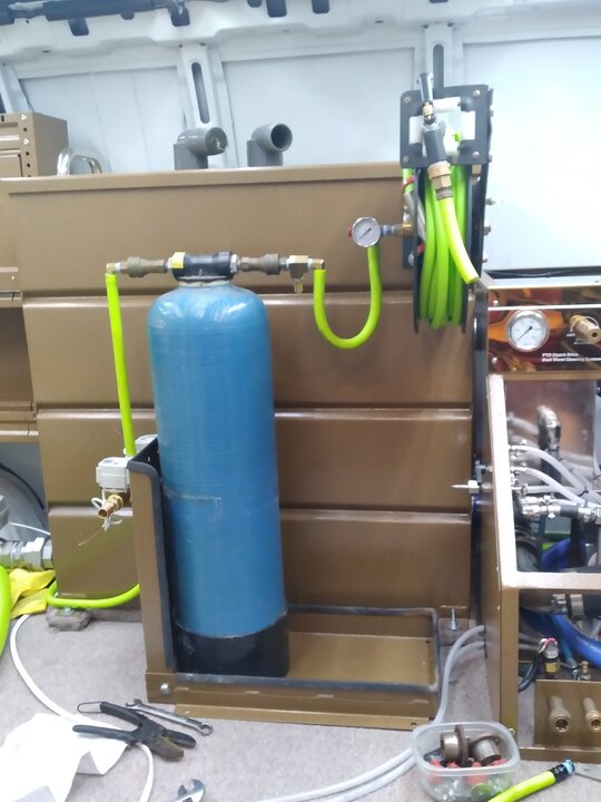

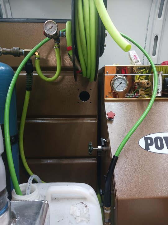

I can see the problems you speak of now. Im un familiar with the new "high tech" crap there building And being rural i don't get the opportunity to be around it much. with the exception of increasing concentration of rtu chems in the waterbox, because if the chemicals are pre mixed that would be a set mix unless somewhere else you were adding extra chems. I can see that in starvation system and chem pump systems that unload into water box after chem injection . But pre mix would stay at the same dilutions unless you remove/ add more chemicals/ remove water from diluted chemicals or add external water to further dilute the chemicals. I still wouldn't do it eveb if there wasn't and problems with the machine. Because i use my stored water for other things. Once it leaves th water pond it goes to a softener which would be damaged vy chemicals then it tee's off to the machine and a retractable hose reel where the water can and is used for a number of things mixing other chems/ cleaning equipment even in an emergency cooling the vans engine so as for me i would never consider doing it
