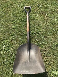

I stopped using power max when I had to rinse my hf jug out because the crap wouldn’t dissolve at the bottom
depending on what layer of Neapolitan Cement Mixer PreSpray you hit in the Scoop lottery
the ingredient measuring tool may need re-calibrated
