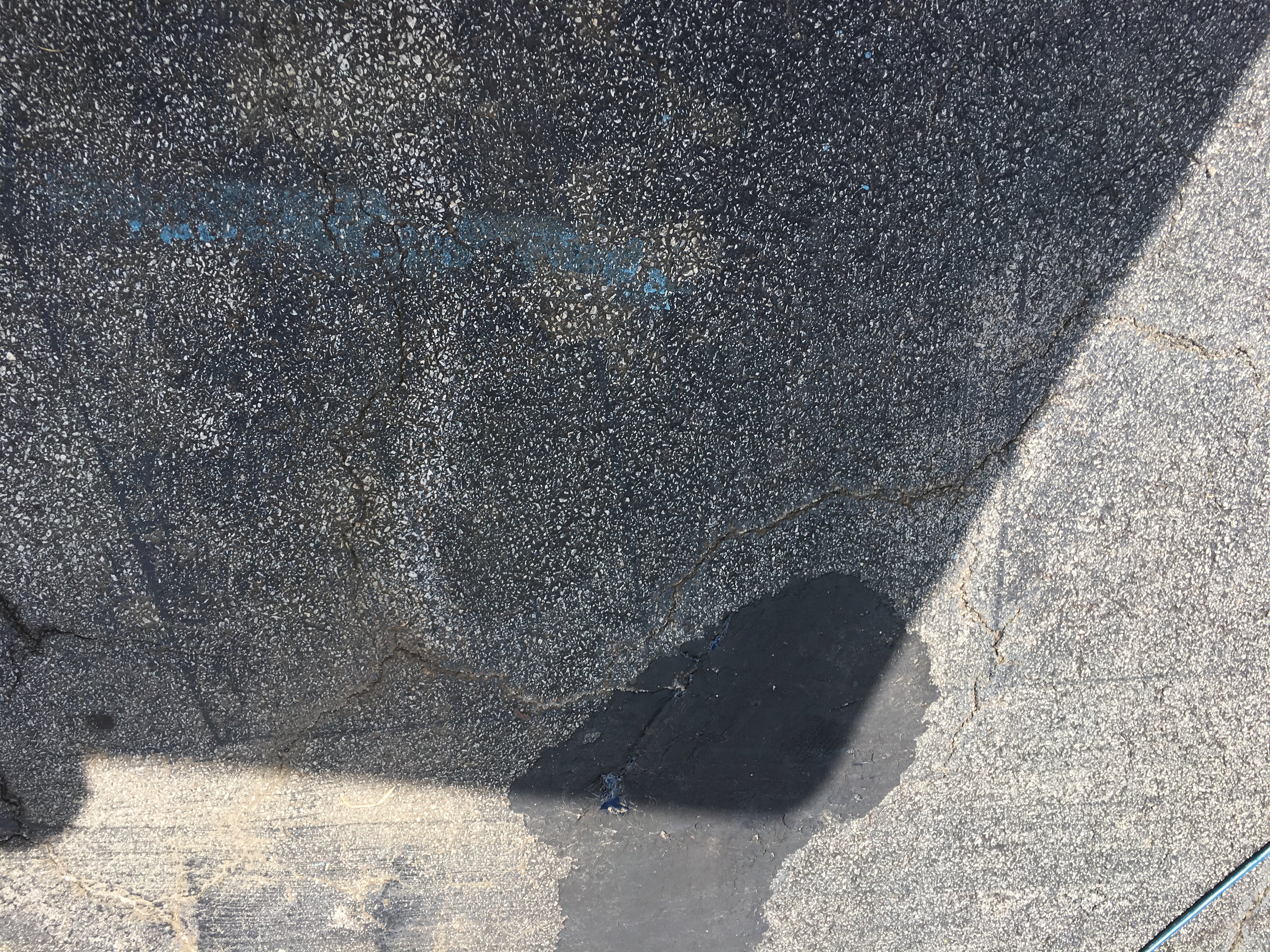

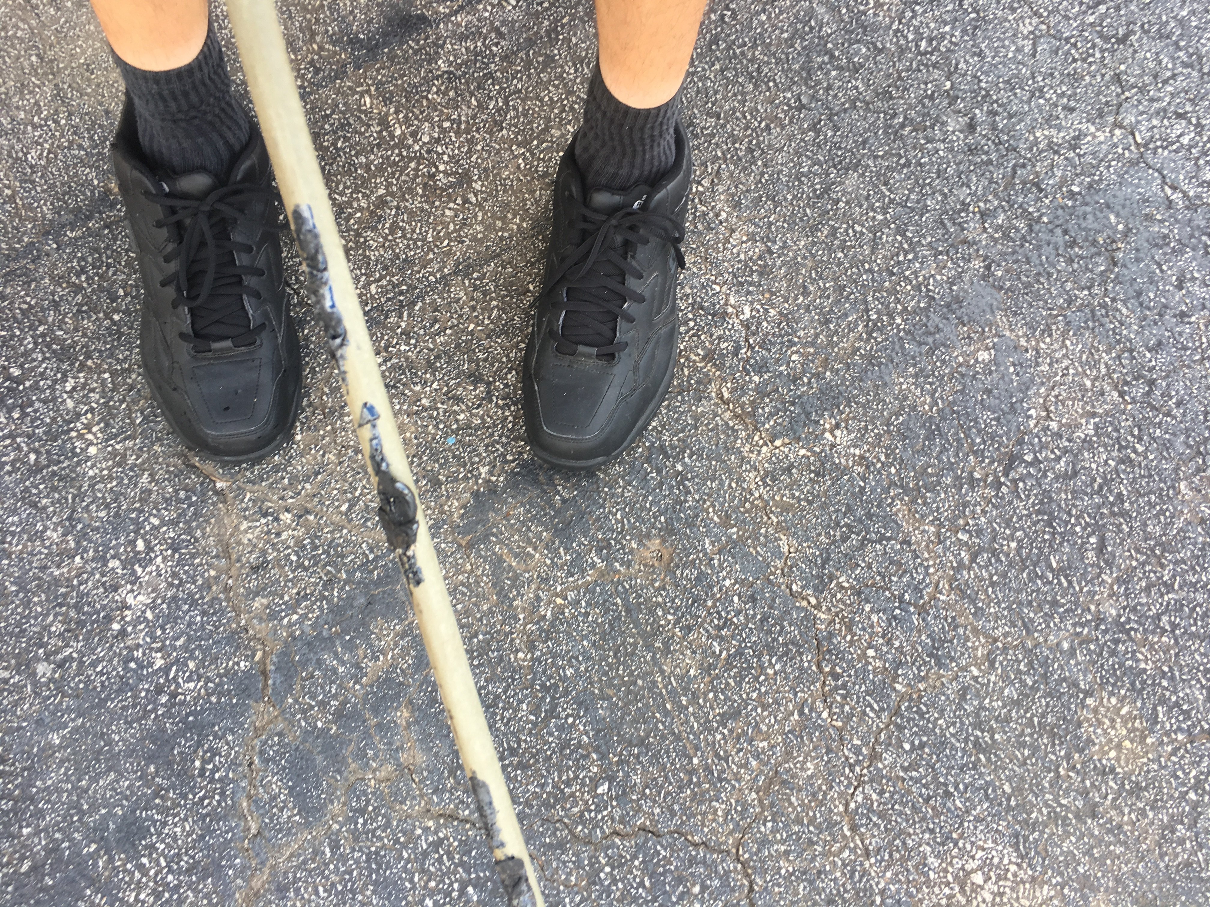

14,194
This happened today. My heat was turned off on this job. I hate summer heat
