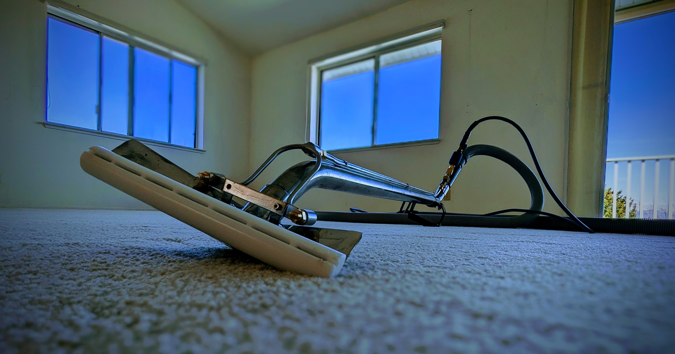

I didn't see an issue today in fact there's a bit of overlap right there and as you know the spray is always the strongest on the ends with v-jets but if this was a problem they would have addressed it at least 15 years ago when this thing first came out
I've seen it happen with wear, but I don't think a fan jet should put out more water at the ends. It could be a problem with the overlap of multiple jets, which could be countered by using tapered jets that have a lesser flow at the ends.
But I'm being pedantic here.
(Thanks Jim.)

Mike you would love this wand, it's nearly identical to the pro-chem quad jet in every way but you would notice the two Jets and it's additional impact, you could run less water pressure to get the same results, and have better access due to the lower corners for getting underneath certain furniture.

I'm working in the yard.I get your video sent to me by 3 cleaners.
So from what I saw.
Lower profile and bigger attic area for recovery.
So hopefully they turn into sales.
But around my area.
There is shattered what's left bdcc...the work is there they are just fkn inept. SO...
Wand looks good.
You explained it nicely.
Jets seem to be hitting nice.
So best of luck.
