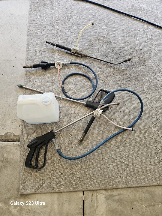

The three I've owned.
2 I know still work the other im not sure of.
The one I'm not sure of i got in 06. The others are about 10 years old maybe.
Maybe I will test them all out on this moldy rug.
