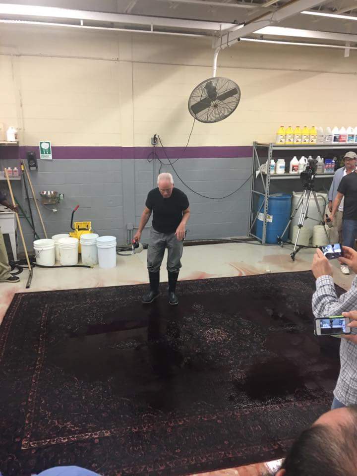

I think a fair comparison of Reduceall and Hydro would be using them the same way plants all around the world use Hydro....in a bucket of hot water poured over the rug, on the wash floor, prior to spinning or extraction.
After watching the video it seems like a ton of product is needed to create the reaction and what your 5 minute video showed could be accomplished on the wash floor in about half the time (depending on how stubborn the dye was being).

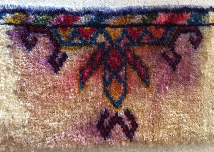

Just another note to add to the conversation. Today there is a high percentage of over-dyed, over-inked, and tea wash dyed rugs. And these can go south if treated like a standard bleeder.
We just use high volume low percentage acetic acid and good water flow to suspend and remove any released dye in "bleeders." I can't remember the last time we needed to pull out some sodium hydro to correct something, it's just not an issue. Though I am currently playing around with some of Larry's products for some stain removal and isolated color correction for the purpose of re-dyeing, and I'm enjoying the air brush techniques learned from Ron Toney at a recent class.
