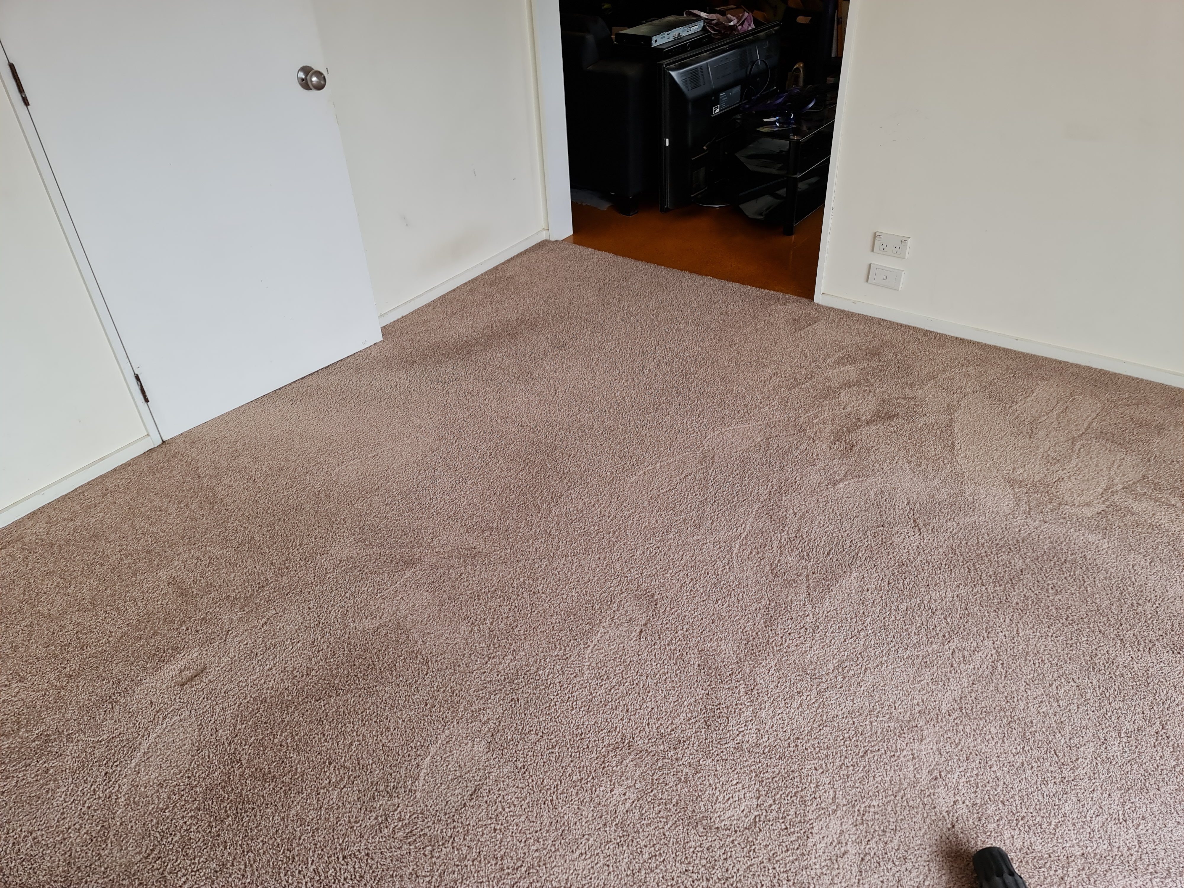

Wear is obviously going to be in the traffic lanes, but it's going to be more pronounced on the pivot points of those traffic lanes.
That's where you will see crushed and distorted fibres that won't look right after cleaning.
Your pics had uneven discolouration in traffic lanes, but not shadowing or excessively crushed fibres on pivot points.
trashed
pivot points have shadowing that won't clean out
trashed
Thank you. This is exactly the kind of information I was looking for

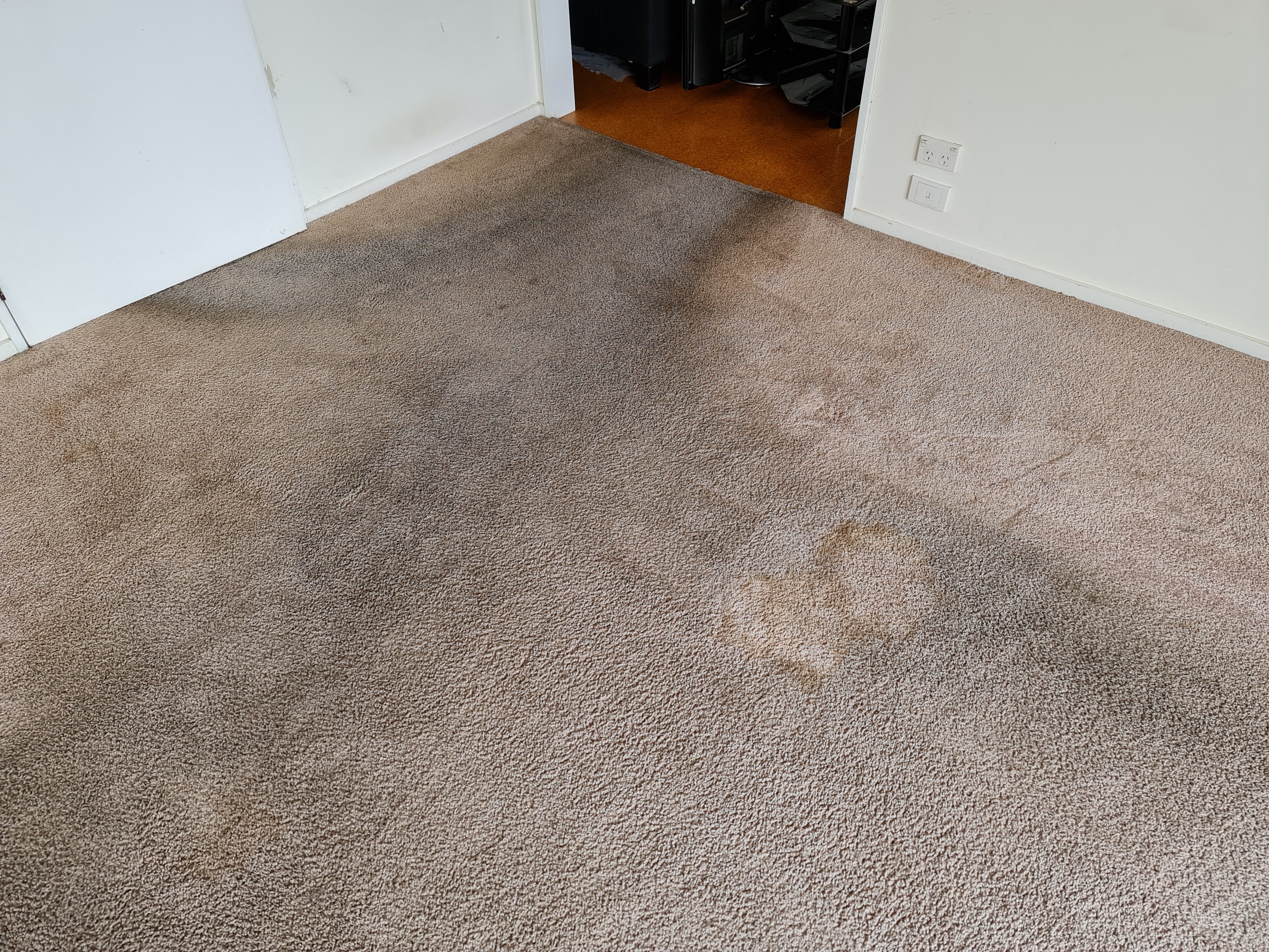

This is one of Scott’s after pics. He used a different rinse and it came out better in some places, still brown in others. She must have been happy though, because she paid her bill and gave him a tip.
In all reality your tech probably could have cleaned it 100% and your customer still may have had a complaint.
Your customer was use to Scott and probably expected Scott to show up for the cleaning. She wanted him.
