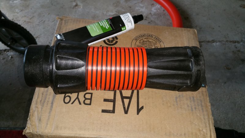

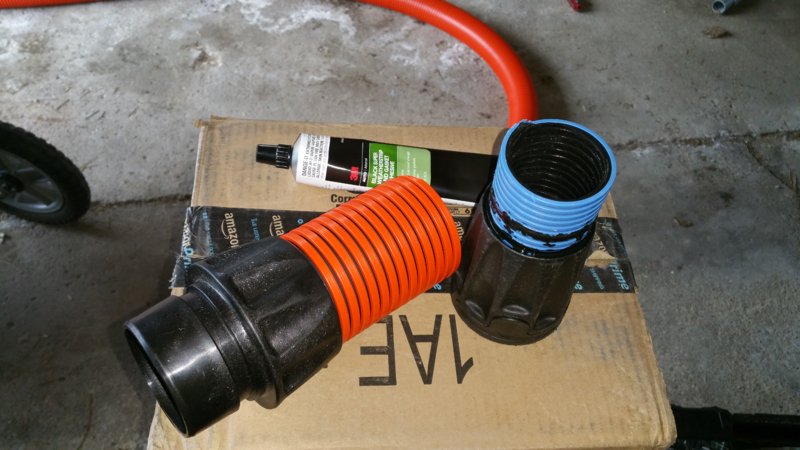

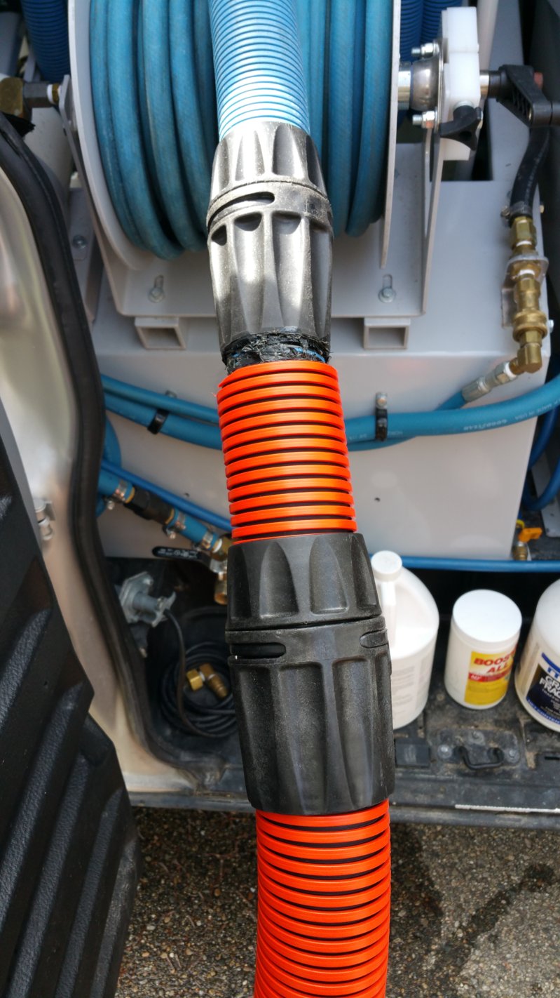

Didn't work for this adapter I cobbled to add 2.5" to the end of my hose reel.
Anybody have a better idea?

#1. That is certainly 3M black weatherstrip adhesive.
#2. I used a little bit and it didn't hold worth a darn. Once it came apart I used a bunch more, obviously still didn't hold.
#3. I think I killed about 10% of my brain cells. The solvents in this stuff are crazy.

I think the problem is there isI too much tension as you wrap it around your hose reel. I am just talking about my cuffs not coming loose as they are in use laying on the floor. You probably need to epoxy that if you are going to abuse it on such a short stretch.

I looked and thought a lot about it. I really couldn't find anything from them that would accomplish exactly what my homemade adapter does.
Has to connect a 2" male with a 2.5" female. If you know of a better way, please let me know.

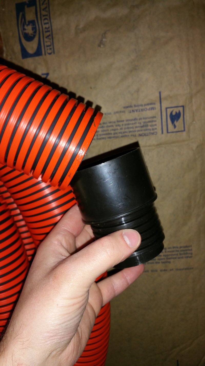

Just like so.

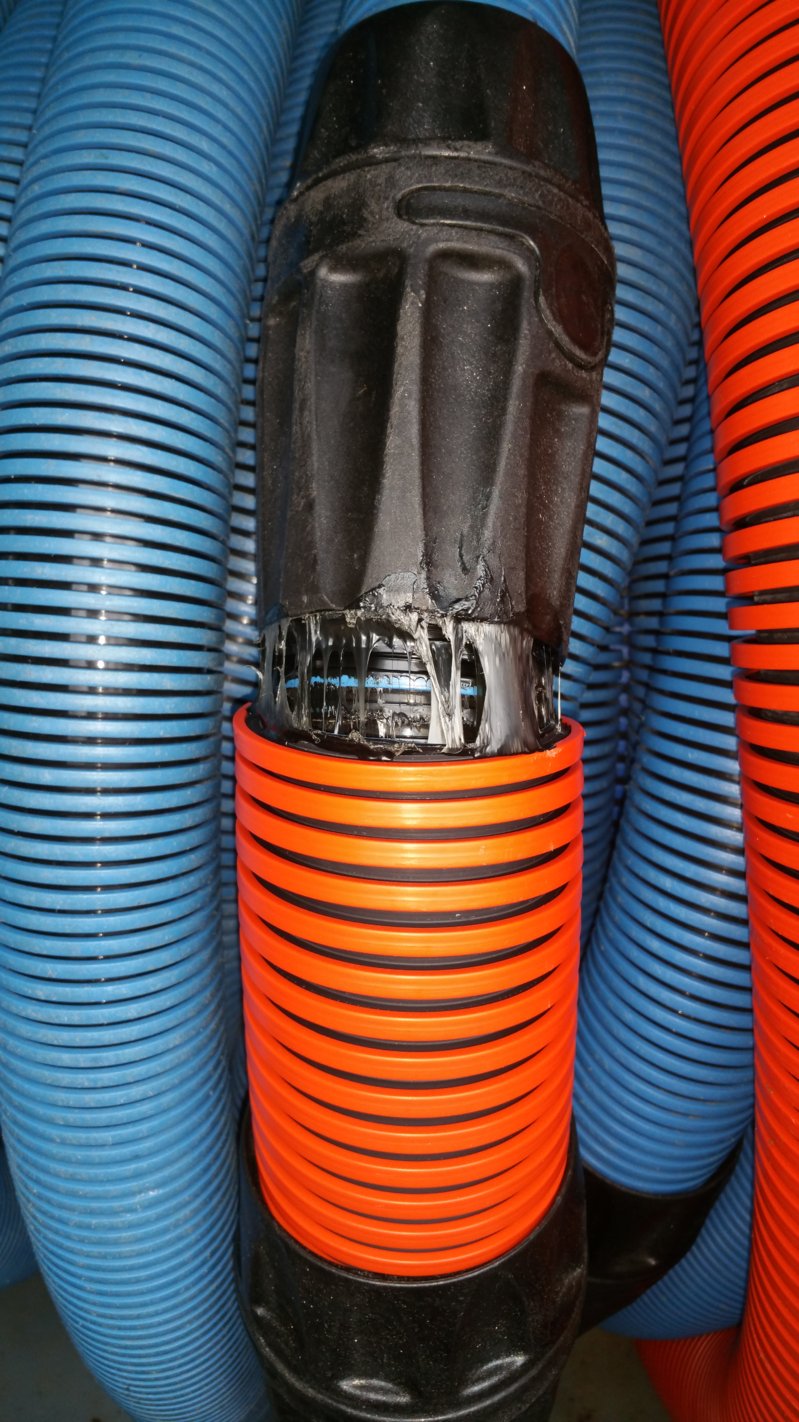

Can't believe the first one I made is still hanging in there. Not for much longer I'm sure.
Is there a way to do exactly this with stock parts?

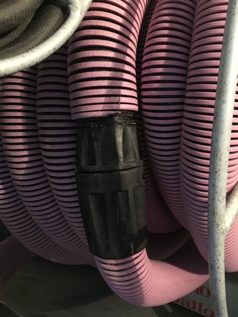

I had an AH212 on hand and thought at first it had some potential:
but I really don't think so.
It's made for truckmount ports, and I don't see anything short of a 10-ton press getting it internally into 2.5" vac hose.
Maybe I should try to get an AH213 (though apparently they've been discontinued) then a short section of 2" to go from male to female.
I'm not a genius by any means, but I've sketched this out and I can't think of a better way.
Yes I want all male point towards the job. 2.5" section is first off, last on.
